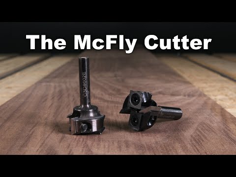

Can some give me some opinions on using McFly surface cutter? I know it a bit more expensive than other surfacing cutters but I do like the indexing carbide bit and I can see myself using a surface cutter a lot. Does it cut smooth and would a Pro 5 handle it with ease? Any suggestions would be appreciated. Would you buy a backup of carbide inserts or would the ones supplied last for many cuts?
The McFly is a great cutter. Many other cutters out there are non indexable - the last thing you want on surfacing mill is to damage it and have to replace the whole tool (I’ve personally done this) and it gets expensive. The cheap solid surfacing bits from China don’t last long at all.
The other great bit is you can drop 2 inserts depending on the material you are surfacing. Inserts can also be rotated when (if) worn out - I’m still on my first McFly and first set of inserts. I’ve done a bunch of hardwoods and chopping boards. Assuming the machine is setup for it you can move right onto a medium grit/fine right off the machine.
Absolutely no issues running it on a 5 Pro.

To add to @Luke 's comment, I will note that if you are wiling to get an 8mm collet, that version is markedly more rigid and well-worth the effort.

I have used the McFly as well as the standard, one piece one like Amana sells. Both work, but if you plan on doing any hardwood, the McFly is better. I still use the standard one I have for MDF, but just so I wear it out since I already had it. I don’t plan on buying another standard style.
I did slightly ā€œtuneā€ my McFly to make sure the outside carbide inserts sit below the inside ones. When I first got it, one of the inside ones (on the bottom) sat below the sides, so I got some lines. But 5 minutes later that was fixed.
The McFly has inserts in the middle, so you should be able to use it with the BitSetter…but I haven’t tried it.
The McFly goes thru hardwood like it’s not even there.
The McFly’s inserts being replaceable means it likely costs less in the long run. They have 4 cutting surfaces, so can last 4x as long before buying another set.
