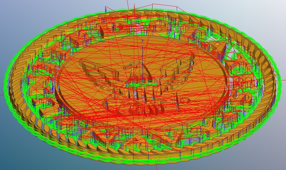

Are MeshCAM tool paths always quite insane?
i’m cutting a simple logo via meshCAM and my SO3 is maneuvering all over the place — moving more than cutting or at least as much.
going full X and Y then back, over and again, just to tidy-up a part of the logo that looks already finished.
maybe once my 15-day trial ends and i send them $$$ it will be able to cut efficiently? ha-haa!
any thoughts as to why the tool path is so circuitous?

included here is my initial vector graphic (SVG) and the resultant (and properly referred to by me) “insane” tool path.

@kevCarrico, that is not unexpected behavior from MeshCAM when there are many “islands” to machine. The only thing I might suggest to try, is to first do the eagle alone by drawing a Machine Region, and then go back and draw a keepout region around the eagle and see if MC does the “perimeter” with less back-and-forth.
If the letters were recessed into a flat plane, you could use the Depth First option in the waterline finishing, and MC would try to do each recess before moving on to the next. But with the continuous “moat” around the raised letters, MC doesn’t really have a way to optimize that.

Those ‘random’ holes are where MeshCAM determined your mill would ‘fit’ into the anchor and wing.
Try again with a smaller mill. And your source image definitely has issues that show up outside a ‘drawing’ application.

OK, Kev, I have a workable file in SheetCam. I found an online SVG-to-DXF converter, then I needed to do a little cleanup of the DXF. In the SVG there is a spurious circle just inside the outer border of the rope outline. That is actually what was causing the inverted machining areas when I imported the original SVG into SheetCam. (When I loaded the SVG itself into SheetCam I got an error message about overlapping contours too, which I didn’t get from the translated DXF.)
I had to specify a .032" endmill to get in all the detail of the eagle. Not knowing your machining parameters, I used a .090" total depth, a .016" stepdown (50% of the cutter diameter), a 50% stepover at each level, and a cutting speed of 20 in/min. I have no idea if those are anywhere near appropriate. I simulated the cut in CutViewer (from which the above is a screenshot) and got a cutting time of 4-1/2 hours for the 159,000 line gcode file.
The toolpath is actually no less crazy than the one you show above. The eagle cuts first, but then the perimiter is a big moat with many islands to outline and clear out between. If you have cutviewer I can zip and attach the nc file and you can take a look at its progress yourself. (EDIT: no, I can’t. I forgot this board won’t accept zip attachments.)
