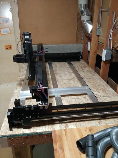

Place Router at which end of one drag chain?
Which end? There are different ends up/down.
Sent you a message for the cable guard question.
The router/spindle drag chain is installed as shown. You need to set the router/spindle in the mount, and then leave a short amount of slack or strain relief from the router/spindle motor into the drag chains and route thru the drag chains from the router/spindle end all the way to the rear of the machine. I can’t remember if I had to remove one of the drag chain ends and flip over to attach correctly.
Between the manual and the video you should be able to get things installed correctly.

Well, I wish “as shown” was a touch more specific - the drag chains are different on each end (see my close up photo) and the manual does not say which end to start with the (the top one or the one I have blue tape on)…and the photo is too far a away to discern which one to put the router/spindle.
You’re going to have to install one end of the drag chain, you may even have to remove the retaining link (one with screw holes) and flip it over and snap back on to get the correct orientation.
