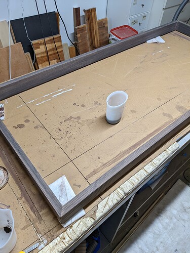

Actually I did use the tea trick, brushing water infused with black tea before applying the vinegar mix. Anyway since I posted, those clear spots have completely disappeared and I have a uniform dark color, it was only a matter of time. More tests and pics tomorrow

Well I wish I had interesting news but it seems like I’m getting nowhere with this ebonizing now.
Yesterday it looked as if just another coat would bring me to a nice black tint, but tonight after letting it dry (I did soak it yesterday when I brushed more vinegar on the frame, which is maybe a beginner’s mistake) it looks much lighter, not uniform, and above all the four sides did not react the same even though they were cut from a single piece of wood.
compare this to the latest pic I posted, and you’ll understand how confused I am.
Can anyone tell me what’s going on, and whether this means the wood needs MORE of it or if I just went over the top ?
At this point I’m tempted to hide this all under a very dark stain coat. Or paint.
Going back to the ebonizing videos, looks like I failed to do a number of things:
- washing the steel wool before putting in it in the vinegar
- waiting for a week (!) in “warm conditions” for the mix to be ready
- sanding the wood between successive coats AND re-applying the black tea coat before the vinegar
And then again, from this guy’s video where he did 1 coat, 2 coats, and 3 coats, I may well be in a semi-normal situation after 1 coat
Regardless, next step = sanding again. And then deciding if I’m willing to spend another week (sigh) doing this.

When I’m not patient, or if I want it darker, my approach in the past has been black shoe polish (if need be multiple coats, buffing in-between each), followed by an overcoat of Johnson’s paste wax (and a final buffing) — but probably any clear wax will do, and if nothing is touching it, might be able to stop w/ the shoe polish.
When applying stain usually the end product will be darker when a finish is applied. I have a lot of things that looked dull and with the finish it looks great. Try some mineral spirits to see what it will look with a finish.
I have used ebony stain before and it did a good job. I also tried some ebony gel stain and that does not penetrate as well as oil based stain. Even with your vinegar solution you may still have to stain to get a dark finish. Even with the vinegar you could spray paint it black either gloss or flat. After all it is a back piece that wont be seen much.
I say take a torch to it. Shou sugi ban style.
Well the good news if the burning does not turn out well the light wont have a place to hang after burning down your home.
thanks for all the options, hopefully I can salvage this. The wife said ok to a “dark but not black” tint, so there’s that.

While the frame looked bad yesterday evening, it turns out that after it dried completely overnight AND I rubbed it with a piece of cloth, it looks quite decent. So since everyone knows that third time is the charm, I sanded it ONE LAST TIME,
and applied a FINAL coat of vinegar/steelwool. And I say “final” in the sense that I threw away the rest of the jar on purpose, so that I can’t change my mind tomorrow evening
I believe that when that third coat is dry, and I wipe it again with a cloth, and apply the finish, it should looks just right. Not ebonized, but a cool dark wood appearance. Or so I want to believe!
BUT, since the vinegar/epoxy mix seemed to be getting better (darker) every day, I decided to prepare another fresh jar and leave it alone for a week. Then I’ll use some on a test piece of wood, for science.
Right now it’s making bubbles, as it should, so I’ll forget about it until next week
