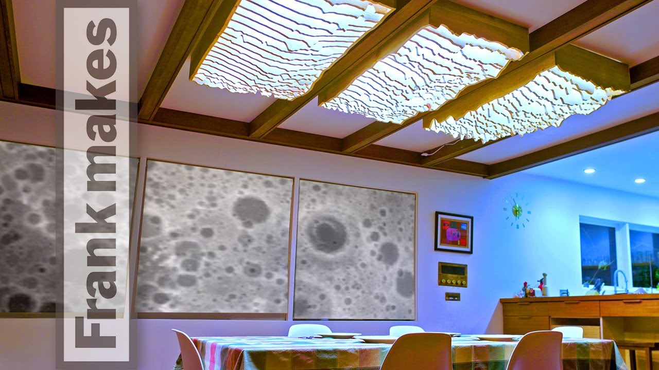

@OldDude: thanks for the video, pretty cool project. My WAF is still too low though.
I love his custom lift, I’m going to look into that
