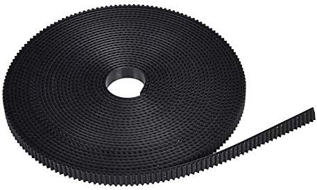

Ok, I took a stab at measuring belt stretch independent of the rest of my machine. I took each belt and clamped one end to the wall, letting the other hang down. I hung about 38 lbs of weight at 1000mm down the belt, and measured how far the 500mm point on the belt pulled down vs lightly hand-tight pulling the belt straight.
This should give us the stretch of a .5m belt segment with 38 lbs of force applied:
9mm stock belt: 2.9mm (.58%)
9mm steel belt: 1.5mm (.3%)
10mm steel belt: 1.3mm (.26%)
Those numbers seem to track pretty well with the measurements on my machine.

Here are the belts I’m using:
9mm steel:
https://www.aliexpress.com/item/32853327280.html?spm=a2g0s.9042311.0.0.18c54c4dONvobE
(Same ones @luc.onthego mentions below)
10mm steel:
(Plus 8mm 20-tooth GT2 pulley to mate with my new stepper, links mentioned in an earlier post… stock stepper would want a 6.35mm. Edit: to clarify, the 8mm/6.35mm refers to stepper shaft diameter. Pulley width is 10mm for 10mm belts.)
