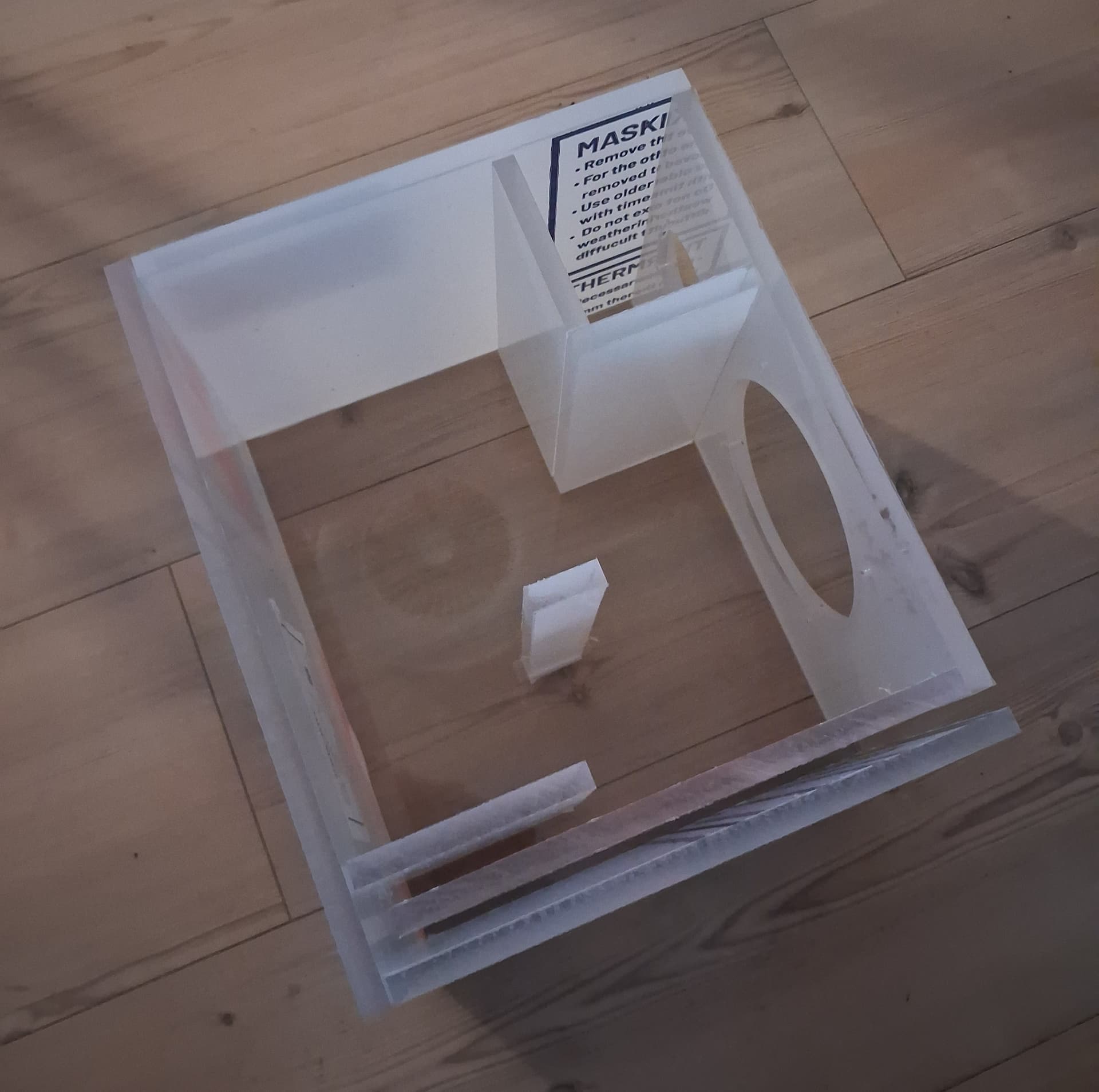

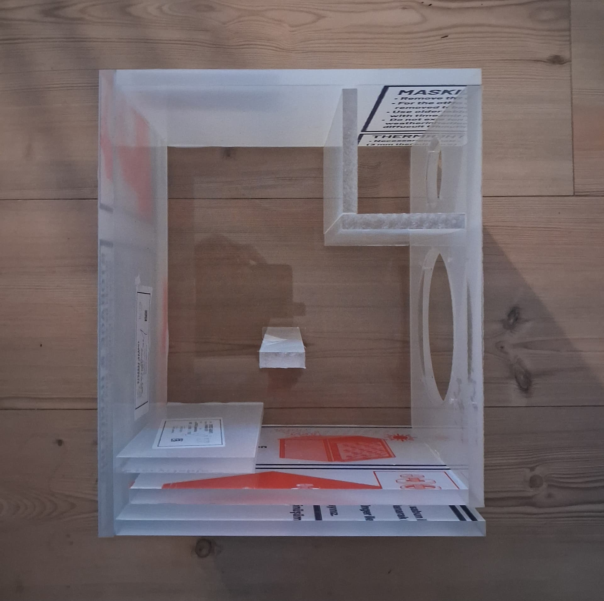

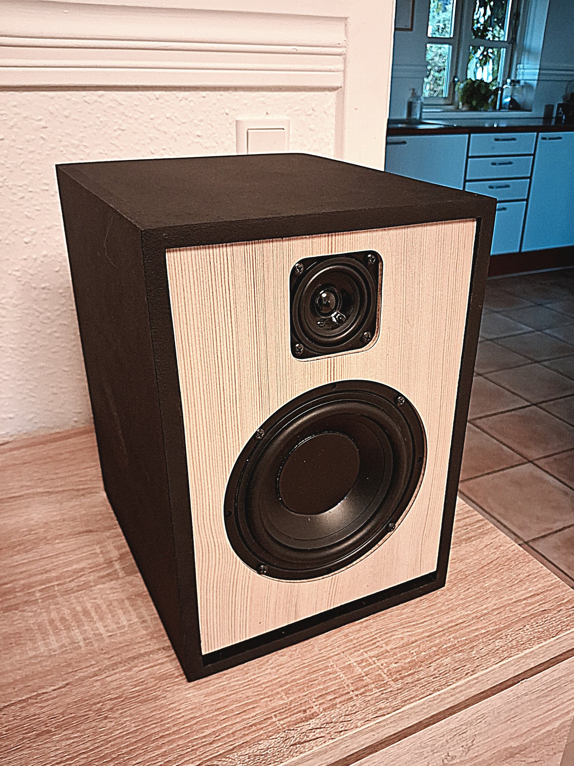

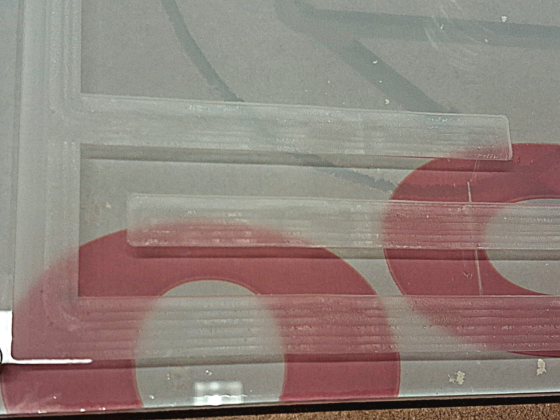

Building a loudspeaker is naturally always a balance between sound and aesthetics. I have already build this speaker in MDF and was really impressed by the full sound (especially considering the small 12 L volume, but very clever bass reflex design).
Now that I want to build it again in 10 mm. clear acrylic, the aestetics becomes more important, maybe at some cost of the sound (hopefully not too much). For that reason, reducing the scallops from the CNC cut grooves becomes somewhat important (also because the acrylic glue is clear and invisible) because they will be visible.
What about a heat gun, will that reduce the scallops or will it just mess up the whole plate ?
I don’t think a heat gun would help but I’ve not tried it.

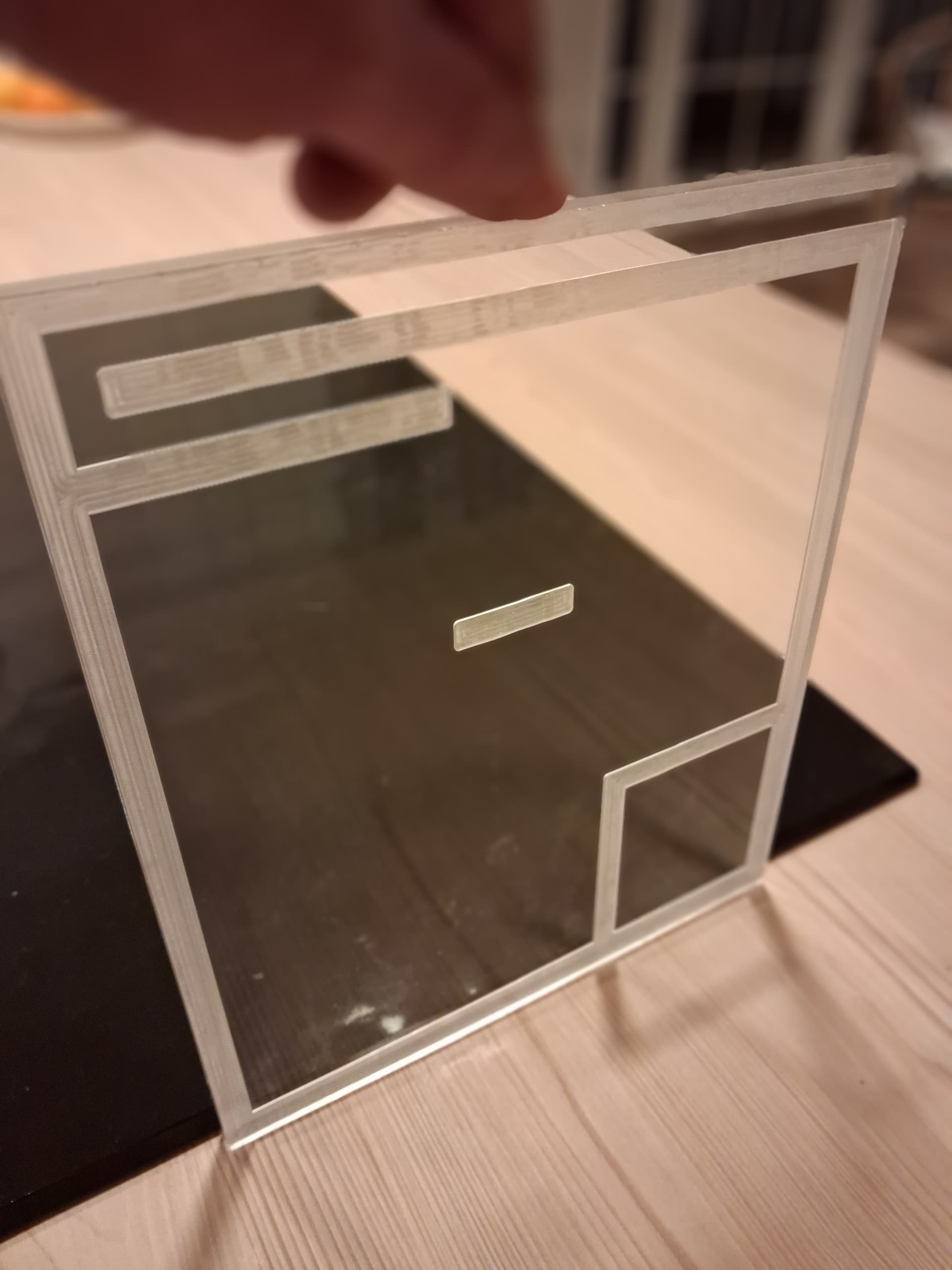

Would you mind uploading a photo of your cuts or a close up of the slots for reference? Other folks might have ideas on the best way to finish the slots if we’ve got an idea of the surface quality you’re working with.
It’ll also be nice for me to compare to if I can get around to cutting some acrylic this weekend :crossed_fingers:
Thanks. I will take and upload some photos and closeups monday. The only reason I haven’t done that yet, is because I left them in a hurry at the MakerSpace, where I have access to the CNC and Laser cutter and it is only open on mondays and wednesdays.

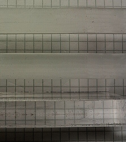

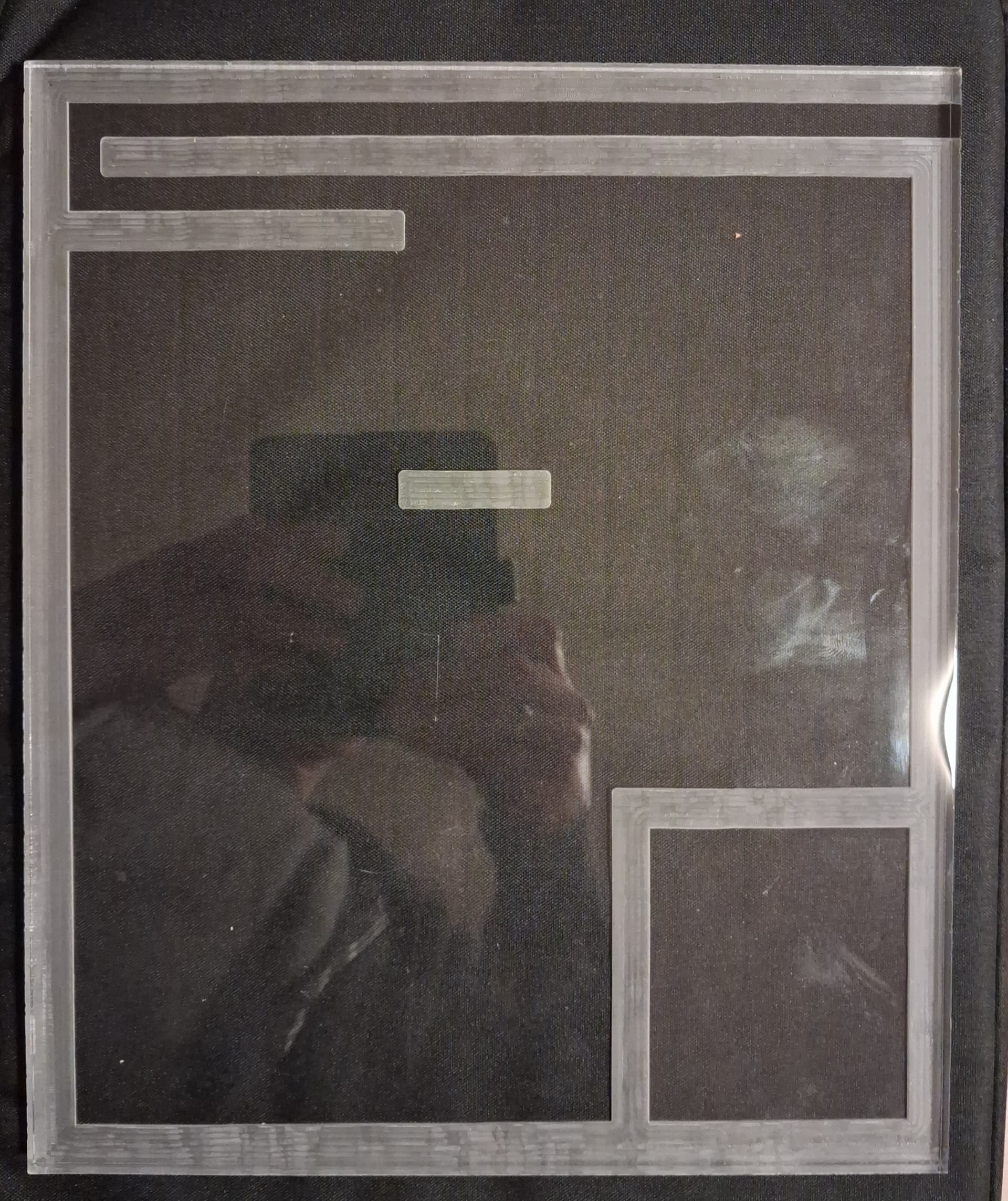

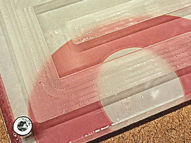

Here are some pics. Depth 2 mm.
Some more photos
How can I make the grooves pretty and clear ?

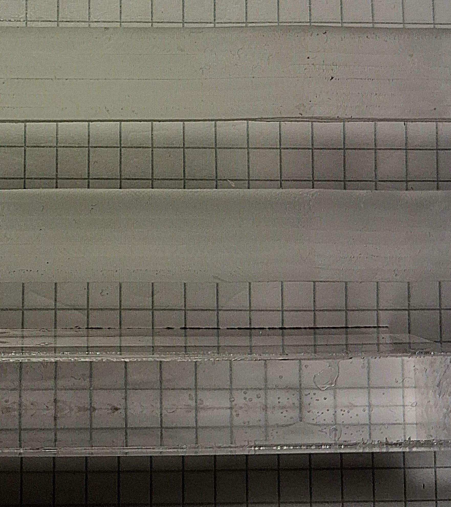

  1. Sand & Buff. This would be long & tedious.
  2. Flame polish. This requires finesse & precision, and practice to develop the skill.
  3. Acetone. Also requires finesse, precision & practice… along with masking to protect the top surface. Mask the top before cutting then apply a very fine mist of acetone only to the grooves. The acetone melts the surface layer and lets it reharden clear. You’ll need an airbrush or touchup paint gun.

Thanks. Maybe I should just leave them as is ?
What about somehow using the precision laser, maybe at low power ?

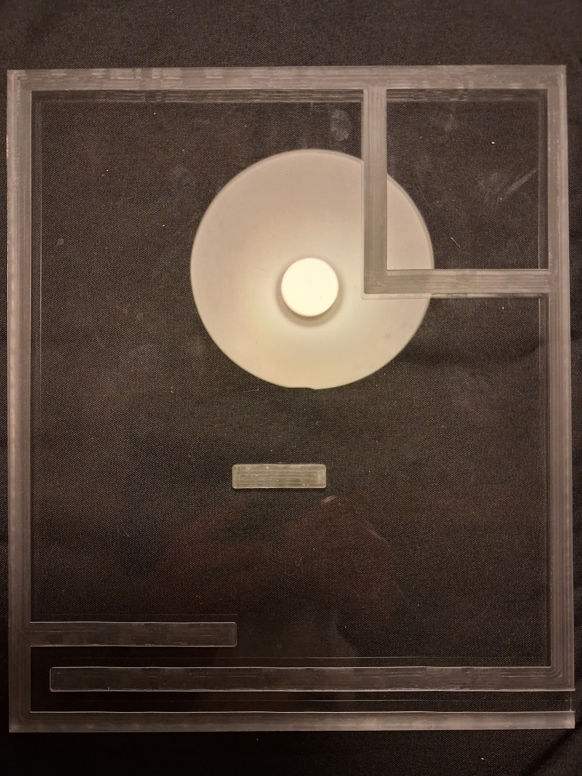

Some more photos
@OSLO

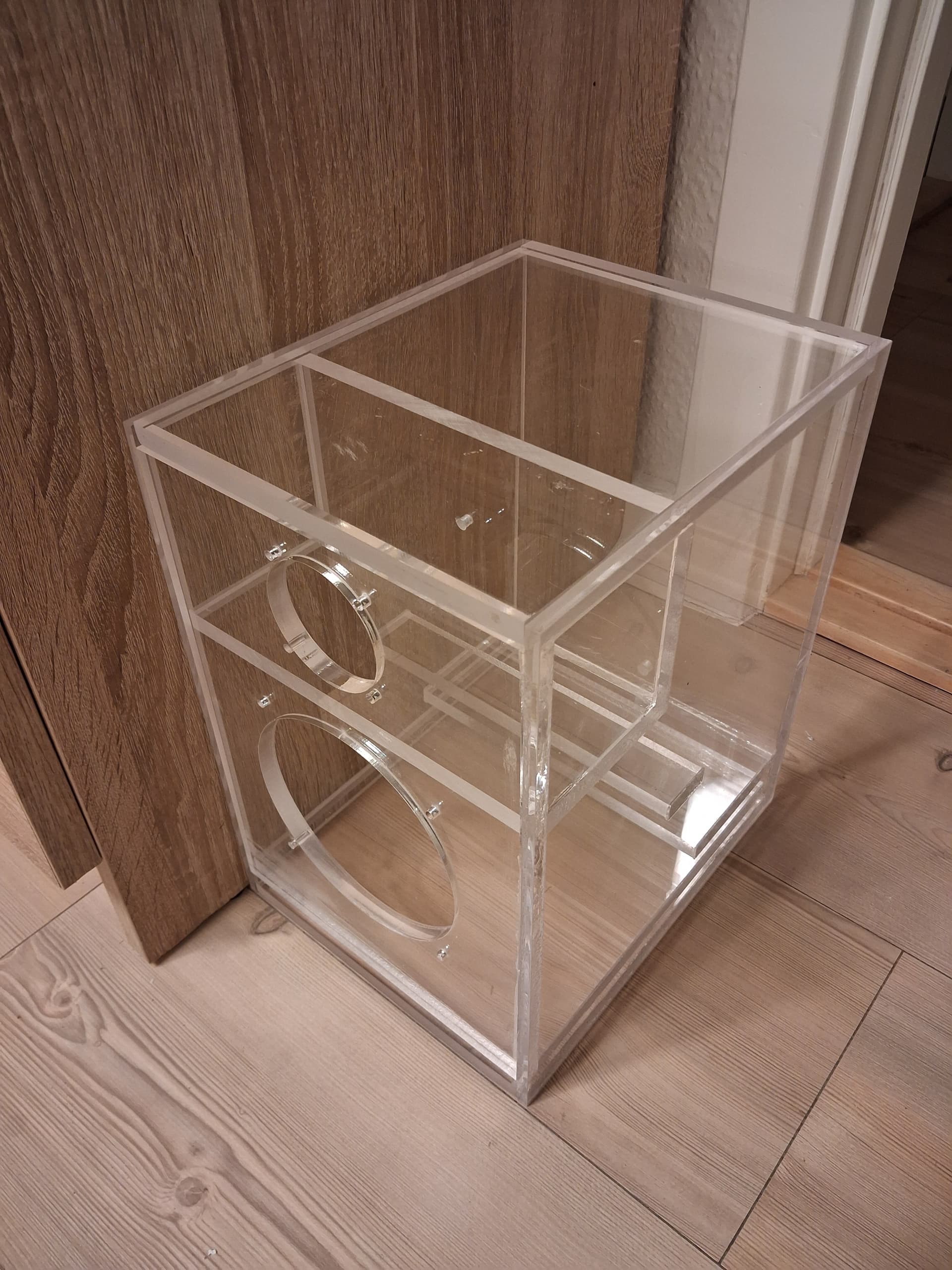

Turned out real nice.
Interestingly, the acryllic glue Acrifix 0192, solved the issue of the small scallops in the CNC cutting, by dissolving them and making the glued surfaces clear again (see photo, bottom line is glued).
Now my only problem is that the glue sticks immediately (no assembly time, like woodglue) and applying the thin glue precisely without dripping.
I do this with methylene chloride (dimethyl chloride, banned but I work in the industry). Flood the cut grooves with a very shallow amount of solvent (in your case PMMA) using a plastic disposable pipette, quickly press the piece to be attached into the groove and align. Hold for a few seconds.
Would a glue needle bottle work too with Acrifix 0192 ?
I think it should. If I remember correctly, folks will use a small bottle with a leur lock cap for precise application. Long thin metal needle should make for a much easier application.
