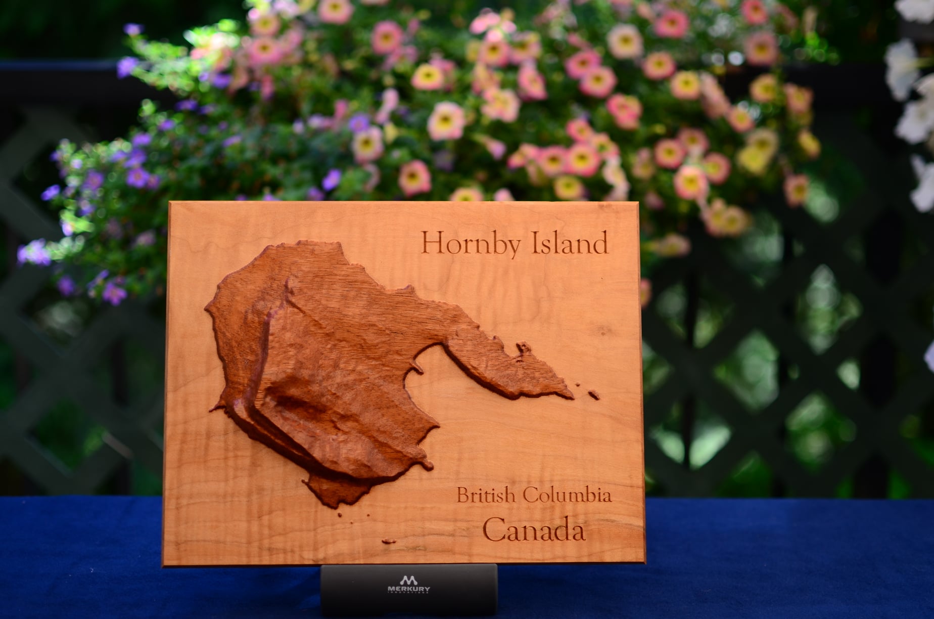

This looks really good. Did you glue the island onto a substrate? How did you get the tiny islands to mill without chipping off?
Here’s a bit more on the Hornby Island carving here:
