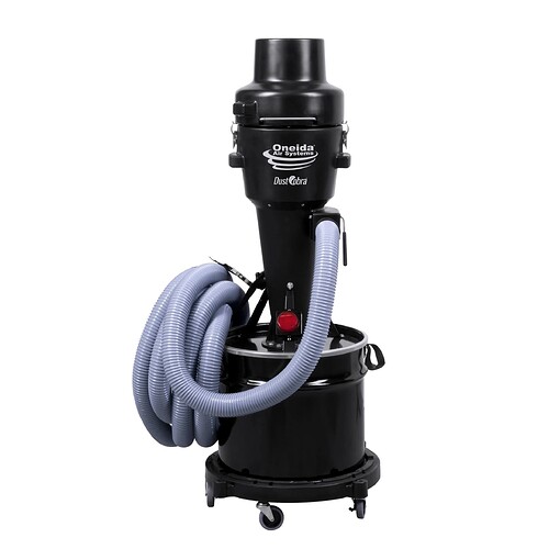

And I always chime into this discussion - if you’re willing to spend the money - I got this Oneida Cobra - which has the 2.5" port, built in cyclone, and works amazingly well.
I rationalized the purchase by getting two hoses: one for my CNC and a 30’ one that I can drag around my shop to get to my hand tools (I have an industrial cyclone for my stationary tools).
It’s a shop-vac on steroids.

The thing is, at that price point, if one has room, one is approaching full-size shop-oriented solutions such as:
I/m going to chime in on the Stealthsonic from Dewalt. Reducing the noise in my shop makes life so much better.
When I got my Cobra, it was 1200 without the sale (which brought it down to around 1000). The Harvey is certainly a good choice between 2000 and 2500…So maybe nowadays, I would have considered the Harvey - although I can’t tell whether the footprint is a problem.

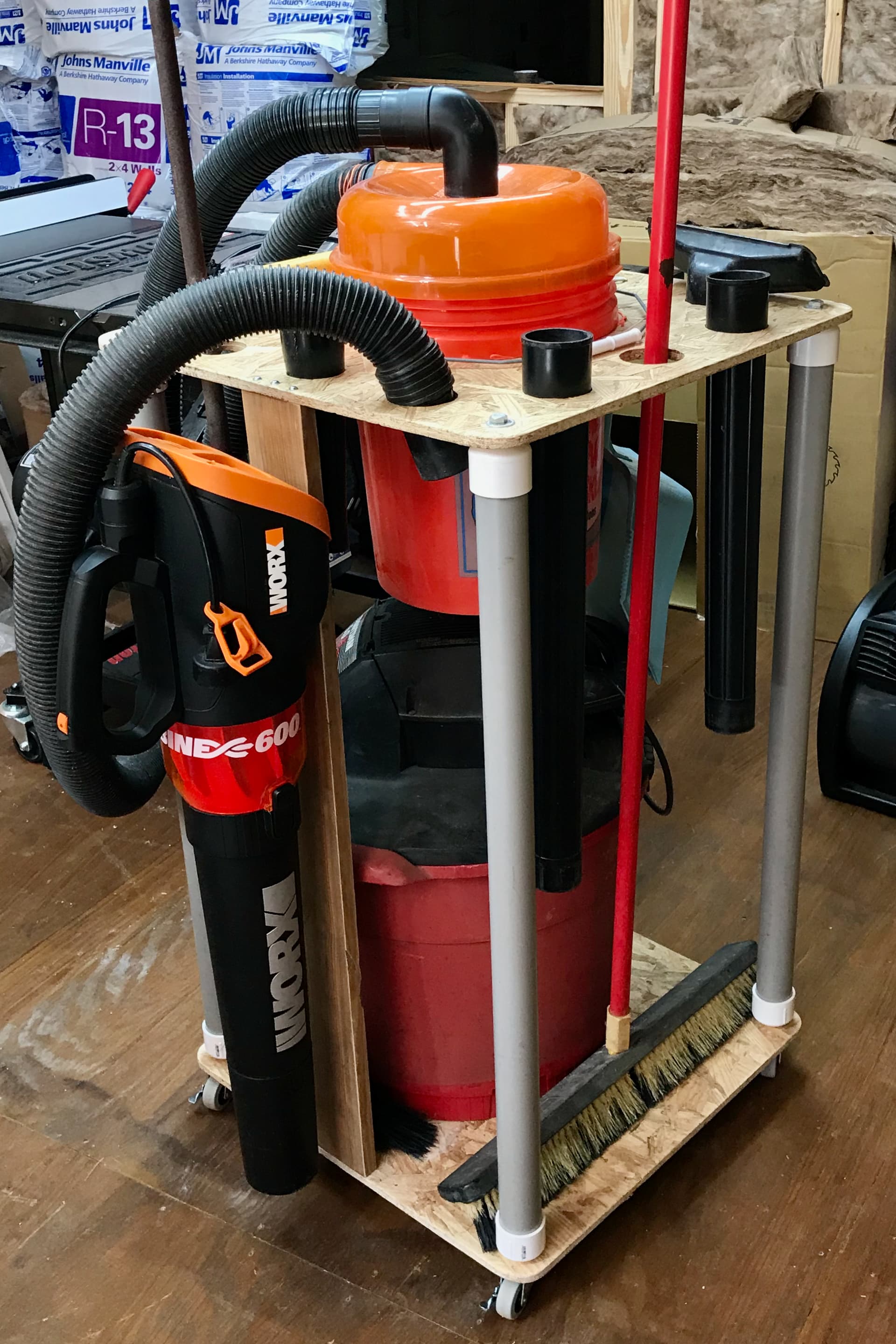

Can’t agree more and to CthulhuLabs point, I use a small cyclone on a 5 gallon bucket for all uses of a shopvac now. Yes, it’s a PITA to move/drag around while working but it’s well worth me not cleaning a filter all of the time. I have several carts with the vacuum/cyclone setup and all of them are designed to come apart quickly to use in the house for example.
