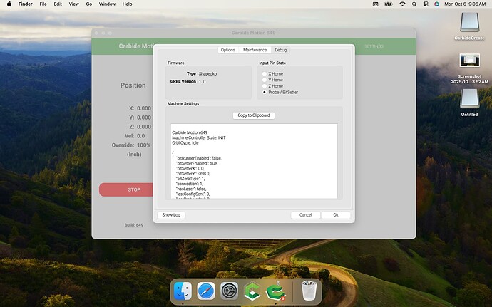

If you power up, connect to the machine, go to settings and you touch the ground lead to the BitZero what shows under Active Inputs?

Still do what @WillAdams suggested. Open CM and connect but do not initialize. Under the debug you can see if any sensors are tripped. On the BitSetter simply push the button down and see if the input changes.
If the input changes the BitSetter is working. If the input does not change then you likely have a wiring problem. Carefully inspect the cable and where it hooks up on both ends. The same is true for the BitZero take the magnet/clip and touch the BitZero and observe the input change.
If it changes then the BitZero is working. If the BitZero does not change then check your wiring. Since the magnet/clip gets manipulated a lot check that first. If that connections seems good check both ends of the BitZero cable.
Both the BitZero and the BitSetter will eventually time out if their input does not change. In the mean time the Z keeps going down but eventually times out and quits. When a probe is iniated on the BitZero you should be within .5" of the BitZero or a time out will likely occur.
One last bit of trivia about an SO3 is if the BitZero magnet/clip is grounded the BitSetter wont function properly. The two devices are tied together. Check that you clip/magnet is not grounded.

The status light changes to red when touched with the clip.

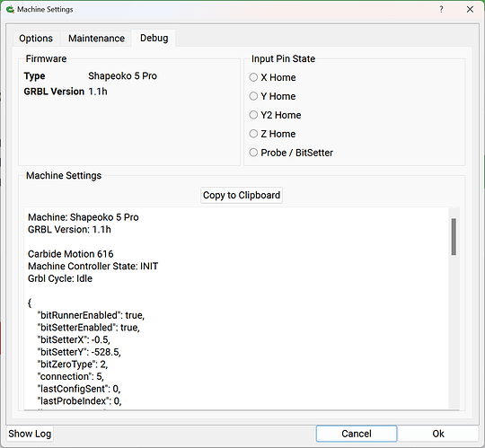

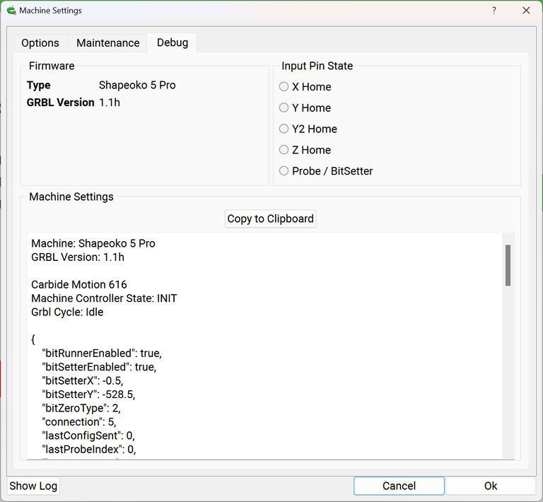

“Input Pin State” (what I meant by “Active Inputs”) is a section under “DEBUG”:
What shows when you touch the ground lead to the BitZero?
Nothing happens when I touch ground wire but when I depress the button I get a little dot in the “probe/bitsetter” as shown in the screenshot
That indicates that it should be working.

The BitZero and the BitSetter are 2 different things that share the same wiring back to the controller.
You said nothing happens when you touch the ground wire to the BitZero plate. If that’s true then there is something wrong in the cabling or maybe the machine is not configured for the model of BitZero that you have.
As Will said you should be able to see an indication in that debug screen when the ground wire (clip or magnet depending on model) is touched to the plate.

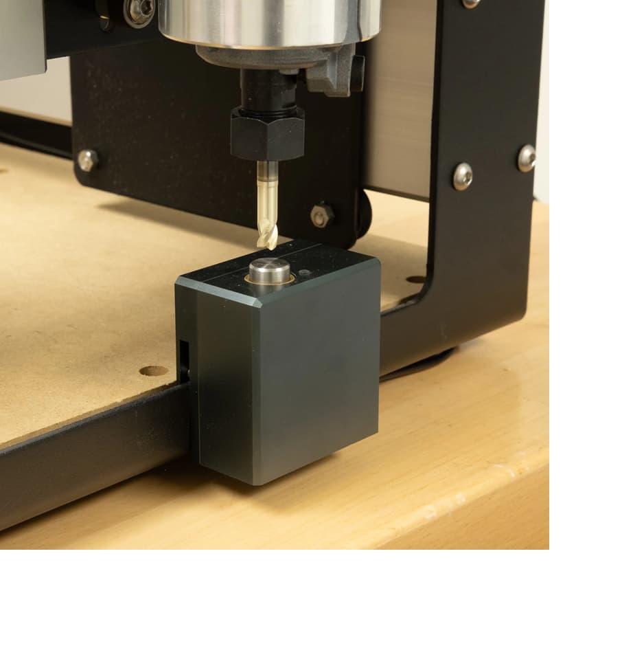

While on the topic, I found my BitSetter failed because the vibration had the “top contact piece” unscrewed from the base unit but was still sitting loose in the well.
The system was confused until I screwed it back in. Now I make sure it is in tight by turning the exposed top section occasionally.
