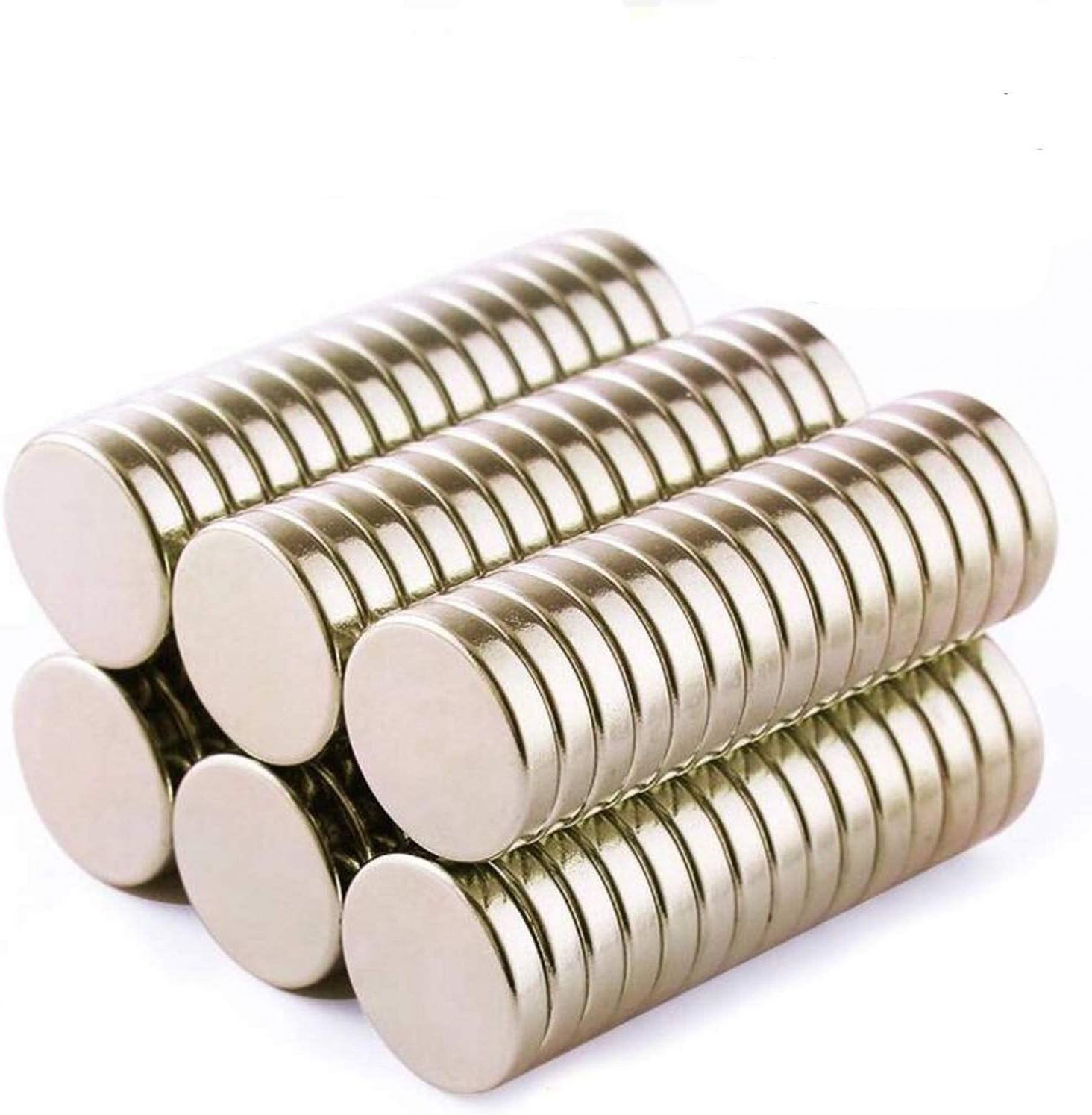

I got a new version of the BitSetter with the magnet. The first time I cleaned the machine the magnet flew off never to be seen again. I bought some magnets on Amazon and although slightly smaller in diameter they are working just fine. So far I have only needed one of the batch. But I have a lot of spares.
