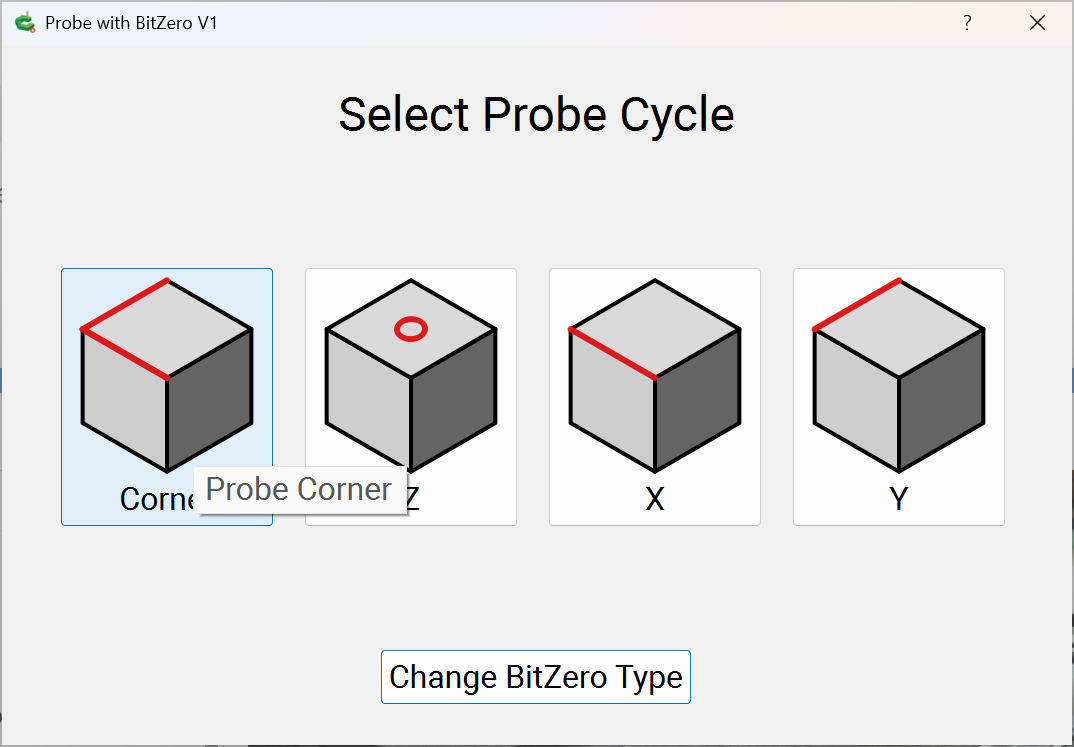

I normally don’t do corner probing that often, so I’m not really sure when this issue started. Today when doing a corner probe with my bitzero v1, I get everything setup properly, then in CM, click probe, corner, select the proper size bit and go. It touches for Z, then lifts and immediately drives the bit back into the probe, but it doesn’t stop and throws Error 4.
I did confirm it’s set to bitzero v1. It probes Z only perfectly.

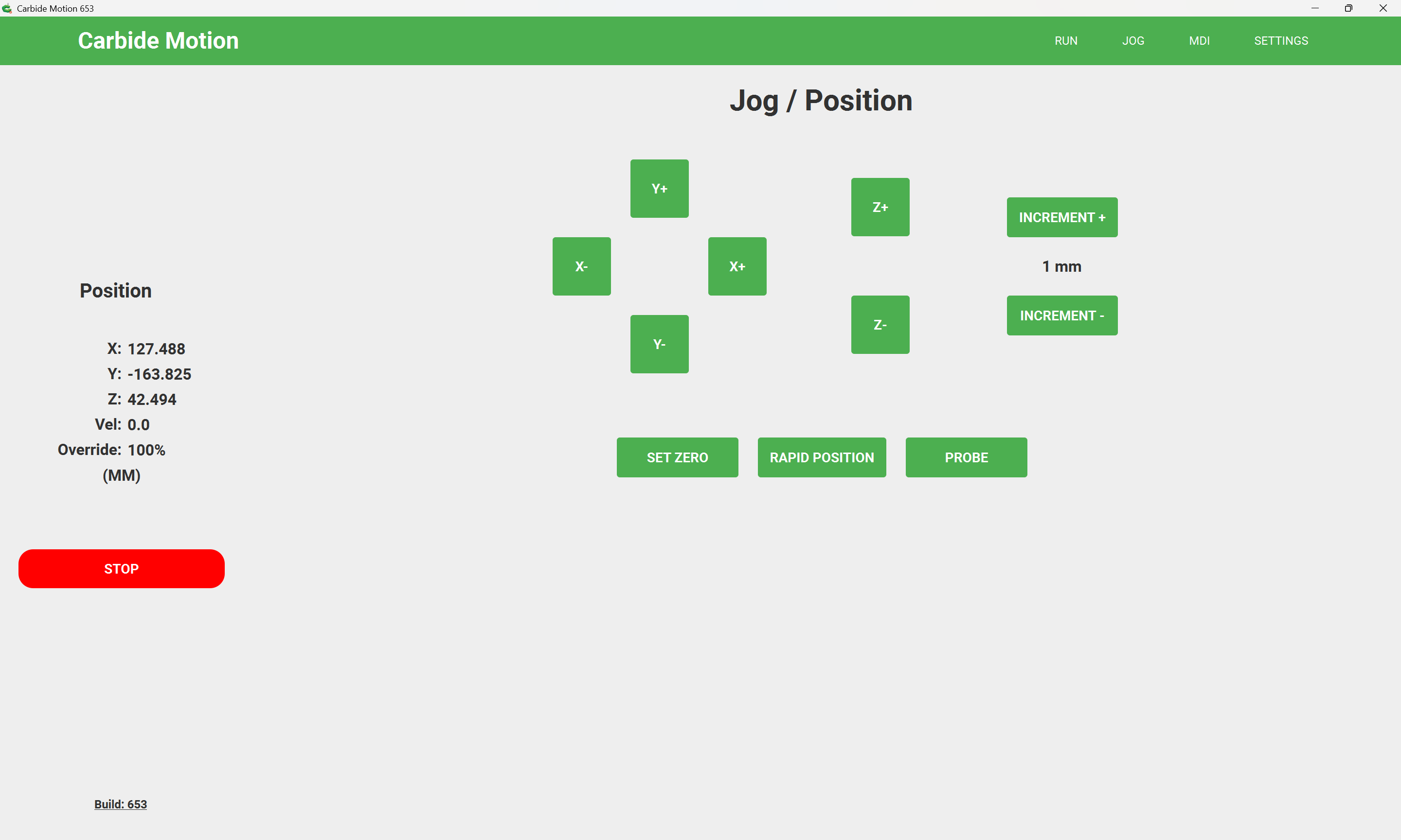

Using CM 653:

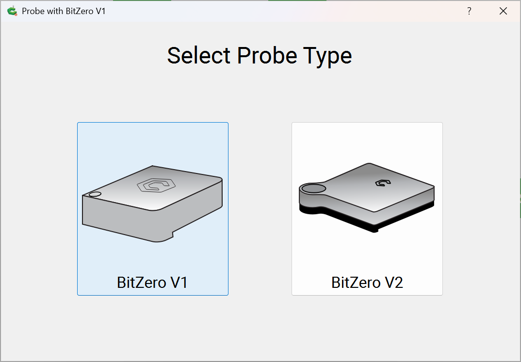

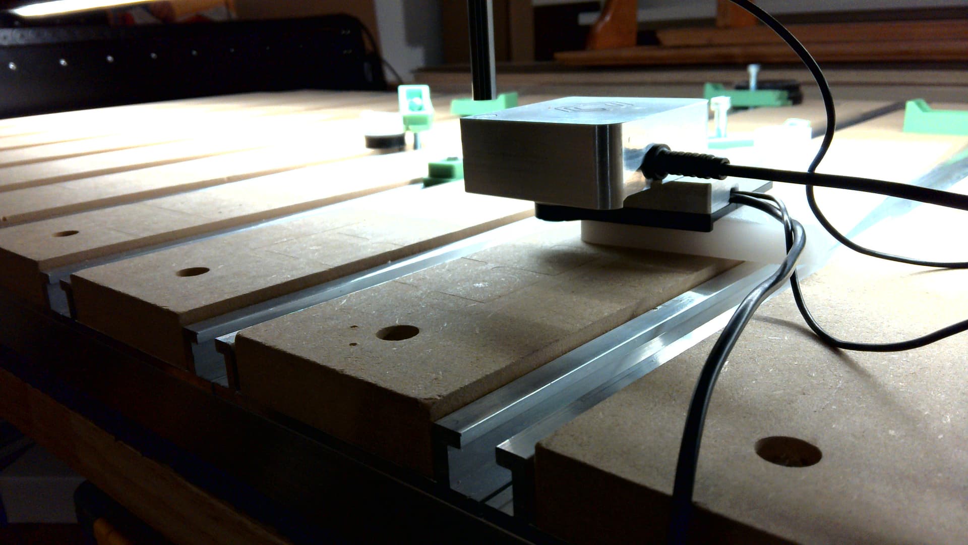

I connected a BitZero v1 to a v2 and placed the ground lead on the probing pin, positioned the machine above the circle on the probe body:

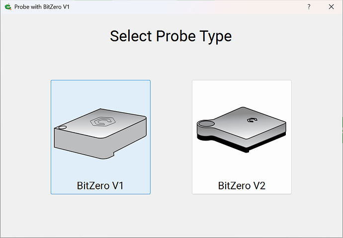

and probed after setting for a v1 BitZero:

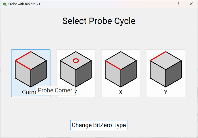

for a corner:

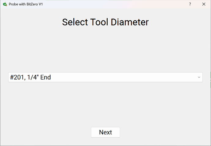

selecting a #201:

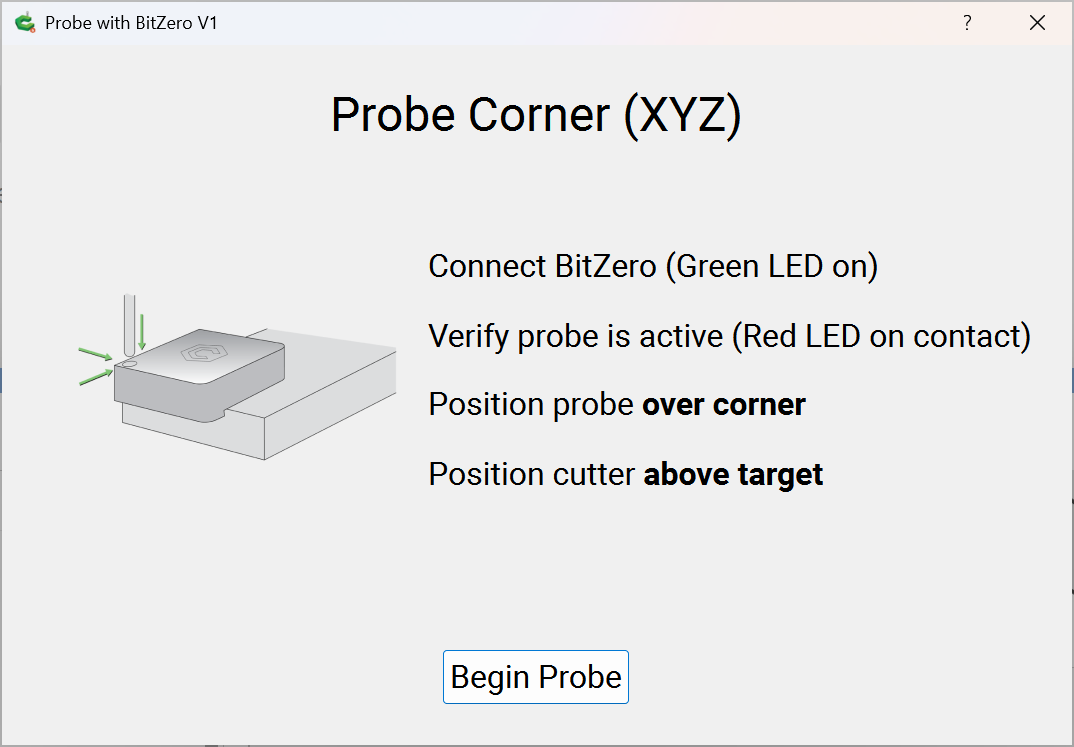

verified that the ground lead had connection

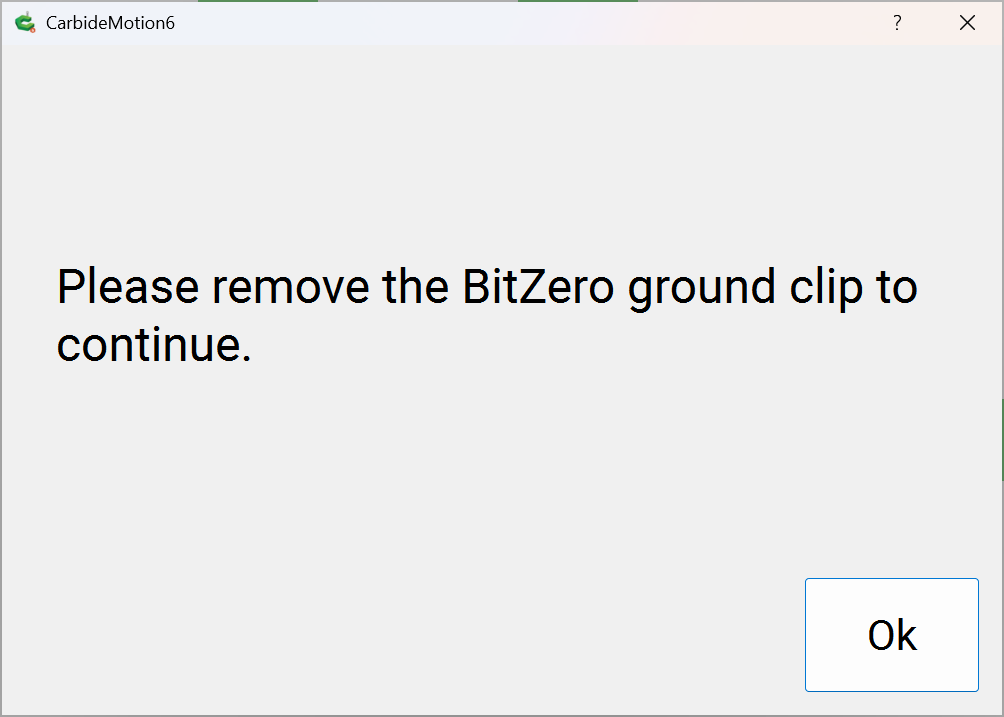

and the machine moved down, probed for Z, lifted, moved up, moved left, moved down, probed for X, moved up, moved right, moved forward, moved down, probed for Y, lifted, moved back and then prompted:
removed the ground lead
OK
the machine lifted, moved to the BitSetter and measured.
Using Rapid Position to move back to zero arrived at the expected position.
