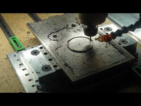

I tried cutting stainless with my HDM using an adaptive toolpath cutting from the side which worked pretty well. It was slow but using IPA mist the cutter was kept cool and the surface finish was pretty good. Feeds and speeds were
1/8 Amazon 4flute ALTIN end mill. 8150 RPM, 1500mm/min, 0.127 Radial DOC, 4.3mm max step down.
I then tried to do an adaptive toolpath using the feeds and speeds to clear out a circular section in the middle of the stock. When it started to “bore”, the endmill turned red hot.
I then dropped it down to 450mm/min keeping all other settings the same, but the endmill still was getting bright red and eventually broke and got ground down to a stub.
I know my feeds and speeds are probably way wrong, but I don’t know where I should be starting. I assume that the endmill is overheating because the chips are too small and not clearing the heat? Can anyone suggest a starting point?
I also ordered some actual coolant for my mister so that should help a little too.
Here’s the video of the first adaptive toolpath:
Here’s the one where it went wrong. I tried pushing it to see what would happen but it pretty much obliterated the endmill.

  1. I believe stainless work hardens when being machined so you need to keep a minimum chip thickness to avoid it turning into unobtainium and trashing the cutter. If you’re in Fusion there’s both the feed per tooth on the tool tab and pitch or ramp angle on the passes tab, are you going down into the hole fast enough to not work harden the bottom?
  1. When executing a bore or any similar narrow radius toolpath we have to compensate for the ‘effective feedrate’ of the outer edge of the cutter which is travelling in a circle of 1 x cutter diameter greater than the toolpath circle, in bore operations it’s pretty easy to accidentally feed the outer edge of the circle at 2-3x the feed rate you keyed in. There’s an excellent Haas video about this which was pointed out to me in this thread

Thanks for the reply, that makes a lot more sense now on why the bores for the smaller holes didn’t work out. I think I’m just going to manually drill those out.

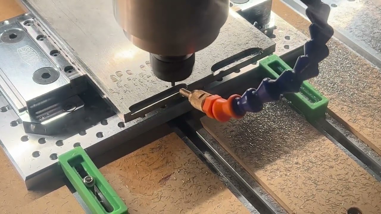

Heres the part I’m trying to cut:
I think I can predrill the center hole manually so that it doesn’t have to do the initial bore part of the adaptive toolpath to clear it out which should take care of that.
How should I approach doing the 2d contour around the entire part? I originally set it up to cut down layer by layer until I reached the bottom and cut out tabs, but all it seems to be doing is melting the endmill after a few passes. I could try to use the superglue and painters tape method and do an adaptive clear of all the surrounding stock, but that’s a lot of material removed

Watching your videos I’m not sure if that’s the cutter or just re-cut stainless chips glowing in the cut. Steels tend to do that in the 500-800C sort of range whilst Tungsten Carbide won’t melt until nearly 3000C. At what temperature it will lose it’s edge and just start smooshing molten stainless around the slot is probably the better question. Certainly getting the cutting area that hot is not going to help with work hardening.
The cut seems to be forming long stringy goops of chips and ejecta ridges around the slot. If I was having trouble with that slot in some goopy Aluminium I’d probably do a stepover in Fusion (in a 2D contour you can do roughing passes with a stepover at each depth) which would mean that the cutter wasn’t constantly slotting.
The adaptive clearing on the edge has a fundamental advantage in chip clearance, they are just flung away by the cutter on the open side away from the workpiece.
Harvey do have some hints on feeds and speeds here Speeds and Feeds 101 - In The Loupe
I think starting your Stainless journey slotting at high RPM with a small cutter with lots of flutes and weak chip clearance may be something of a trial by fire though. Finding some toolpaths that are not full slotting (adaptive clear or widen the slot with a rouging stepover) might be a good way to start?

I think trying to find a way not to do a complete slot would help, considering that the stock is 3/8 thick.
