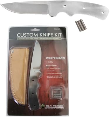

You can actually do a lot of “3D ish” stuff in VCarve without adding an actual 3D model or STL file, like these knife scales I did awhile back (I only ever cut the flat profiles, never got around to doing the full cut).
knife2.zip (330.1 KB)
Those go with this kit if anyone is interested in trying it out:
Dan
