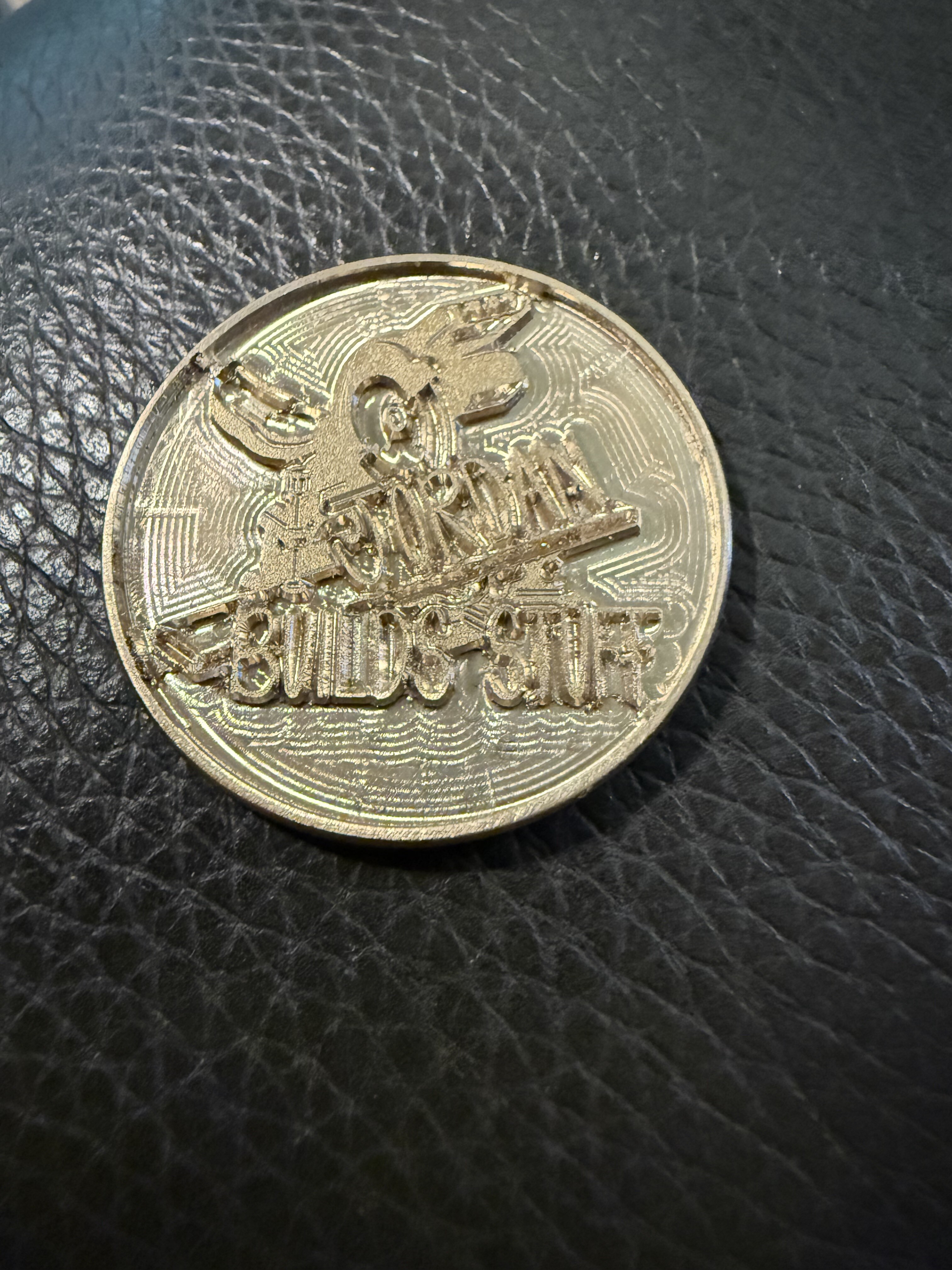

This is the only thing I’ve tried to carve and it’s my personal logo
Looks pretty decent for just starting :beers:
You’ll want to be able to measure your runout, not so much for machine accuracy but because it impacts your chipload. (kind of like how big a bite your tool is taking, too big a bite and the tool breaks, too little a bite and your tool rubs…which might work for a while but will likely kill your tool early. Not great for process reliability)

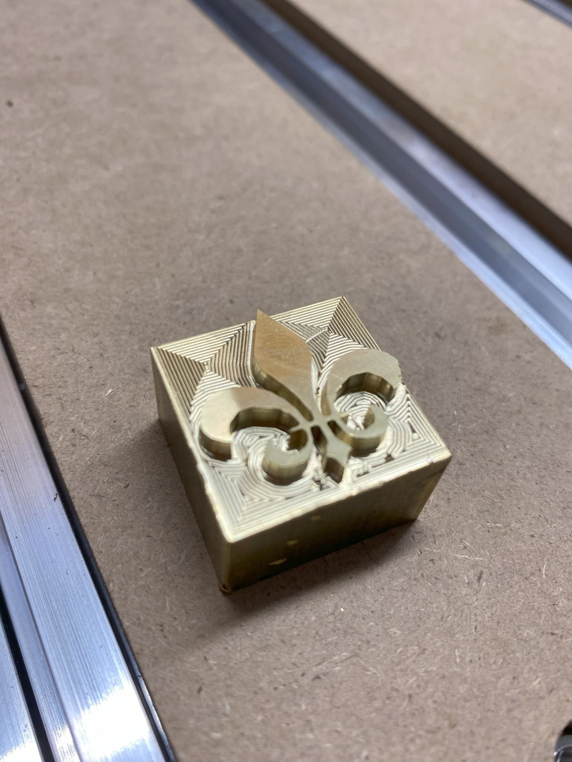

So, I make stamping dies for our book bindery out of aluminum and and brass on a Shapeoko 4pro, with carbide create pro with no issue. I am purely a hobbyist and started this 3 years ago and knew NOTHING about CNCs. But, through lots of trial and error is this very doable. I use a variety of very small bits as small as .40mm (.0157") but these are SUPER fragile, so avoid that small if you can.
Personally, I run my machine very slowly (feeds) with a very small stepover (typically this is to because I am working with very small end mills). I will typically use the pre-built speeds and feeds for any end mill that I order from Crabide Create, otherwise you should also be able to locate and import the feeds and speeds tables from the manufacturer and load them into Carbide Create Pro too.

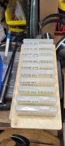

Not who you asked, but I have been getting by bits from drillman1 (now Oliver Tool Company) on Ebay for a decade now. Here is the link for all of their bits under 0.0200" diameter: OLIVER TOOL COMPANY | eBay Stores
Many are in the $4-5/ea range. I have used 0.0100", 0.0119", 0.0120", 0.0157", 0.0197" and more small bits on my SO3 XXL. Used them on wood as well as aluminum. Some I break because I run them too fast. Some break because they do not like the wood grain of some types of wood. Some probably break due to wear, but I would never know because they are so fragile. I have broken more than one with my finger tip when just reaching to grab it when loosening the collet.
I store them in these little plastic cases that hold 10. They all have a 1/8" shank.

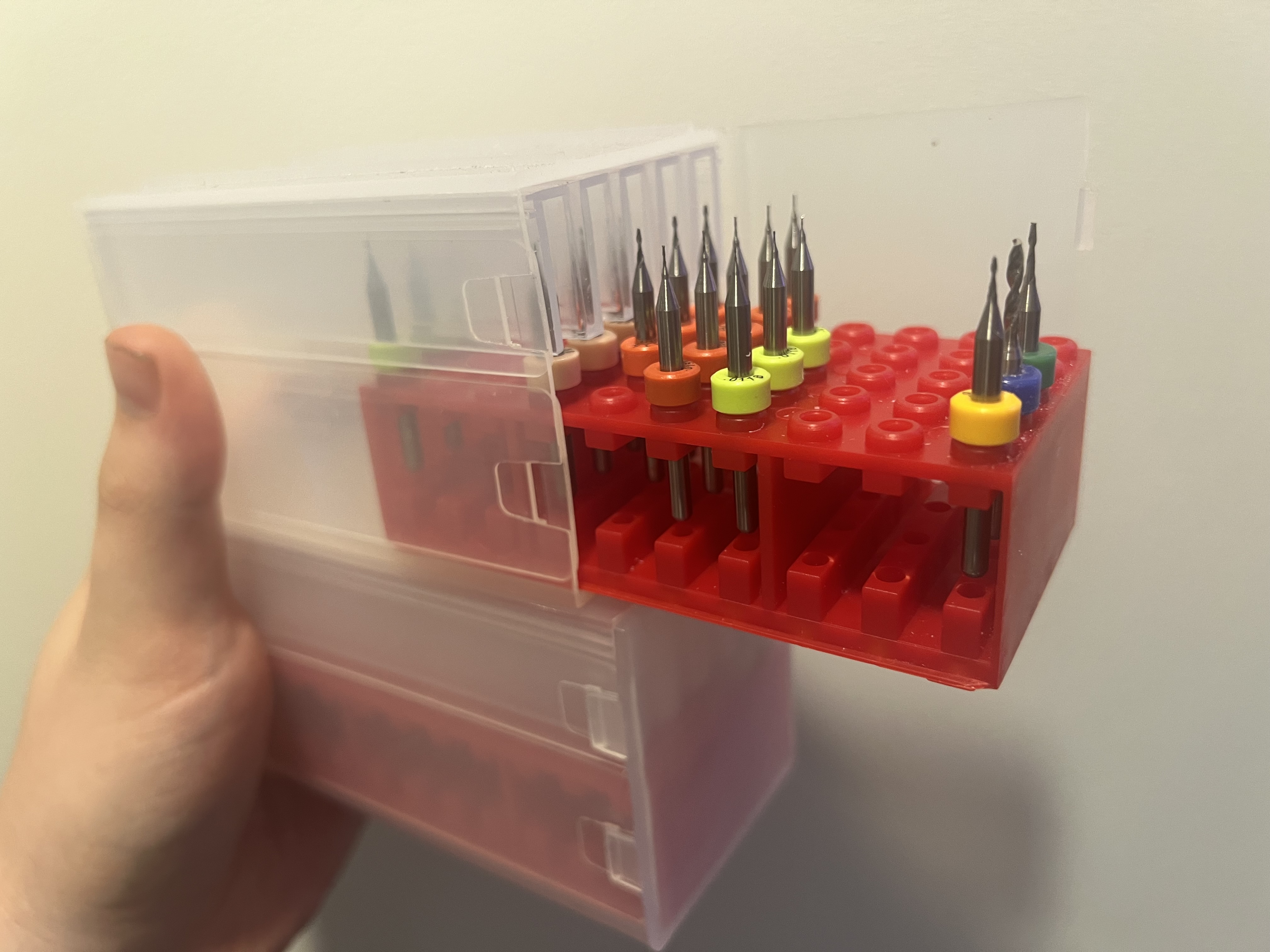

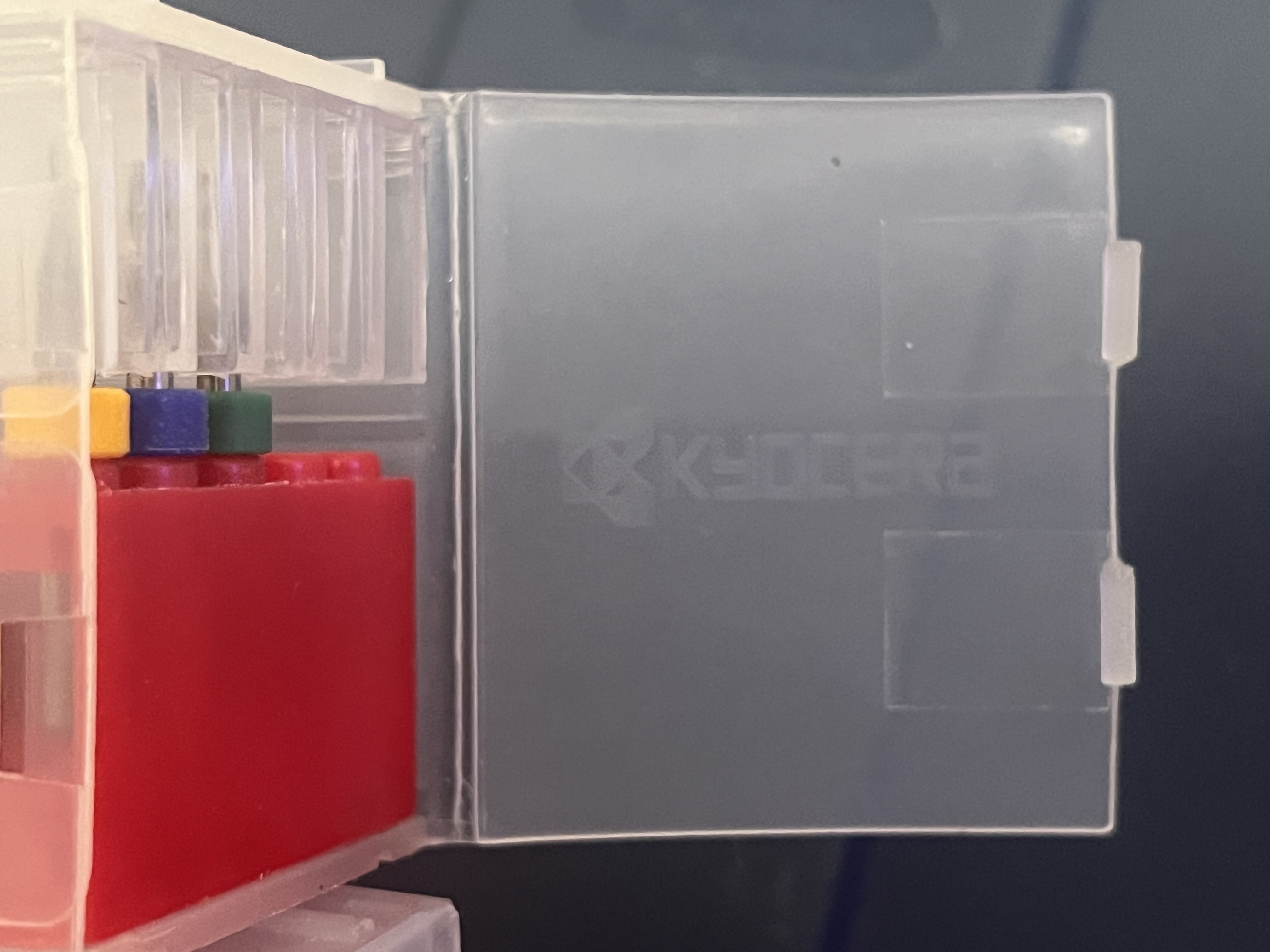

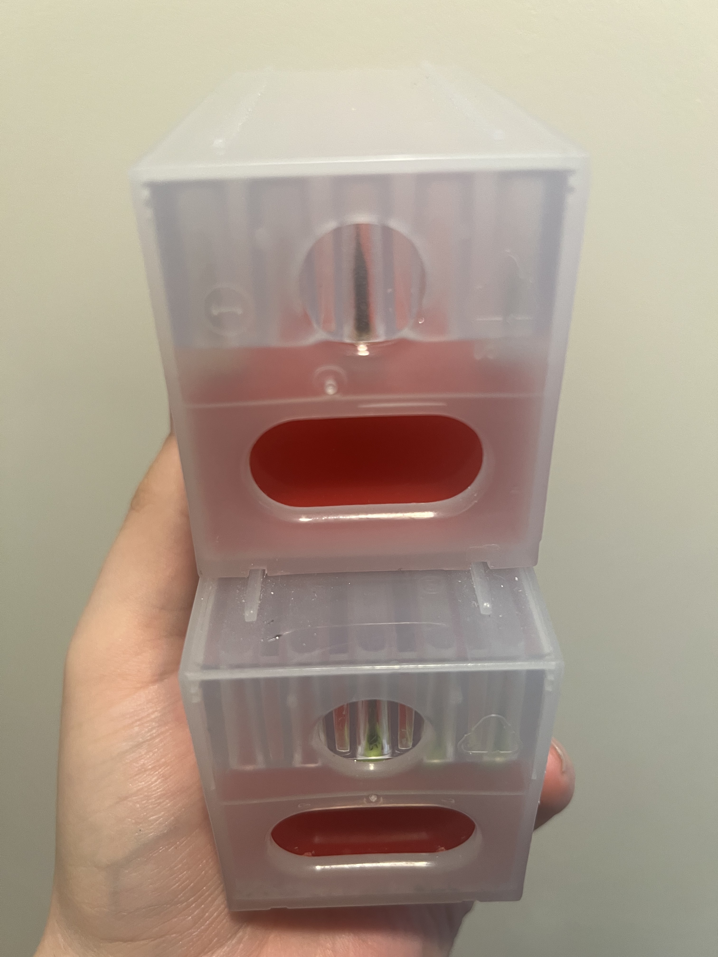

I’m also a big fan of drillman1, they’ve never let me down :slightly_smiling_face:
I usually try to order enough at once to get the fancy tool holders but I’m always annoyed when I forget which tools they hold :person_facepalming:
Someday I’ll 3D print a little shelf for them to slide into and label the cubbies. (Leveraging the nice features like the rails on the box to allow stacking)
Love these dumb little boxes :sweat_smile:
I have one of those large cases and I keep all of my 1/8" V tools in it, since it’s pretty obvious which is which — I need to order 10 each of two additional angles (or maybe stock up on 1/8" downcut tooling?) to fill it out.
