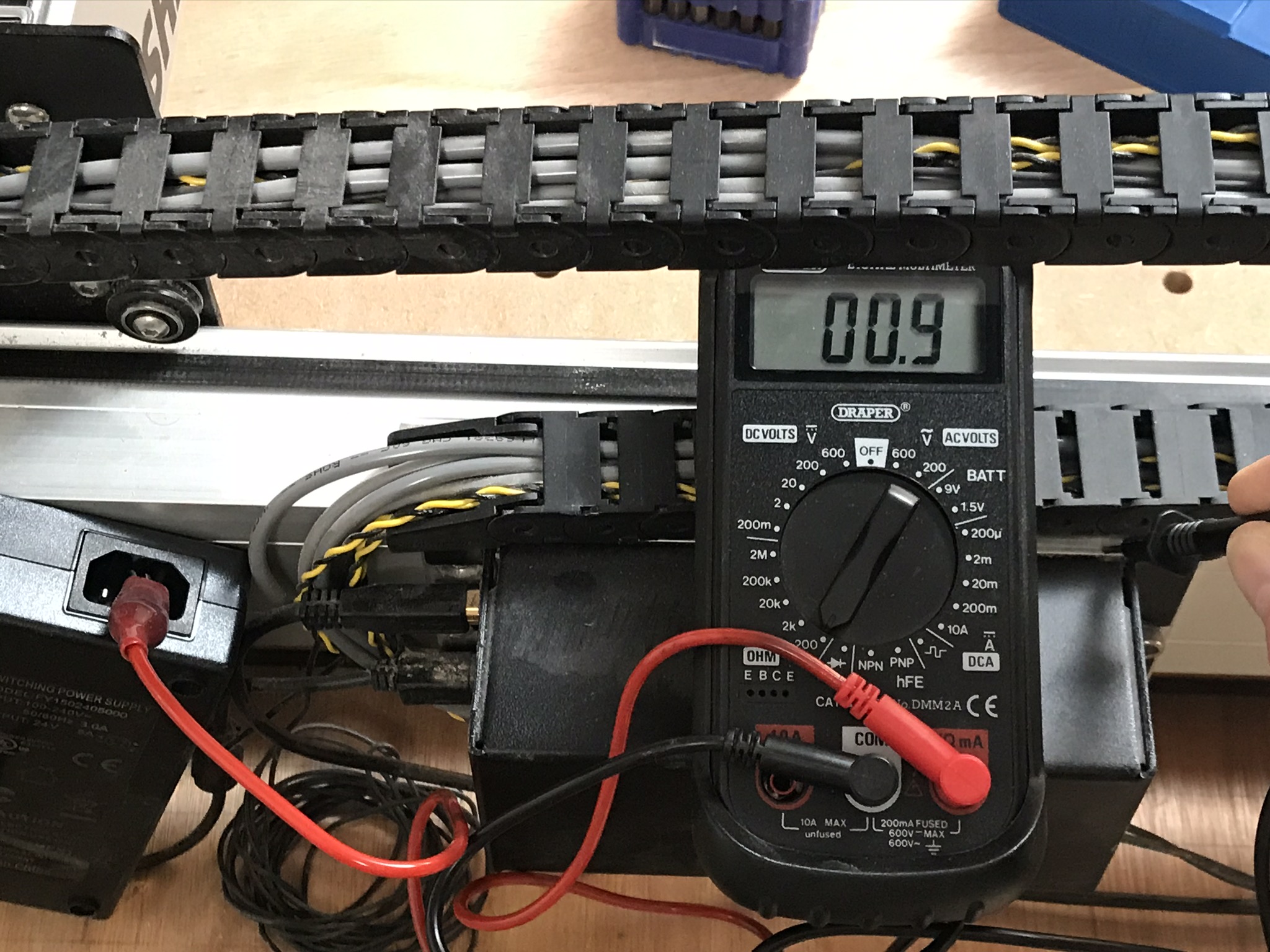

Ah, the VFD users’ grounding horror :wink:

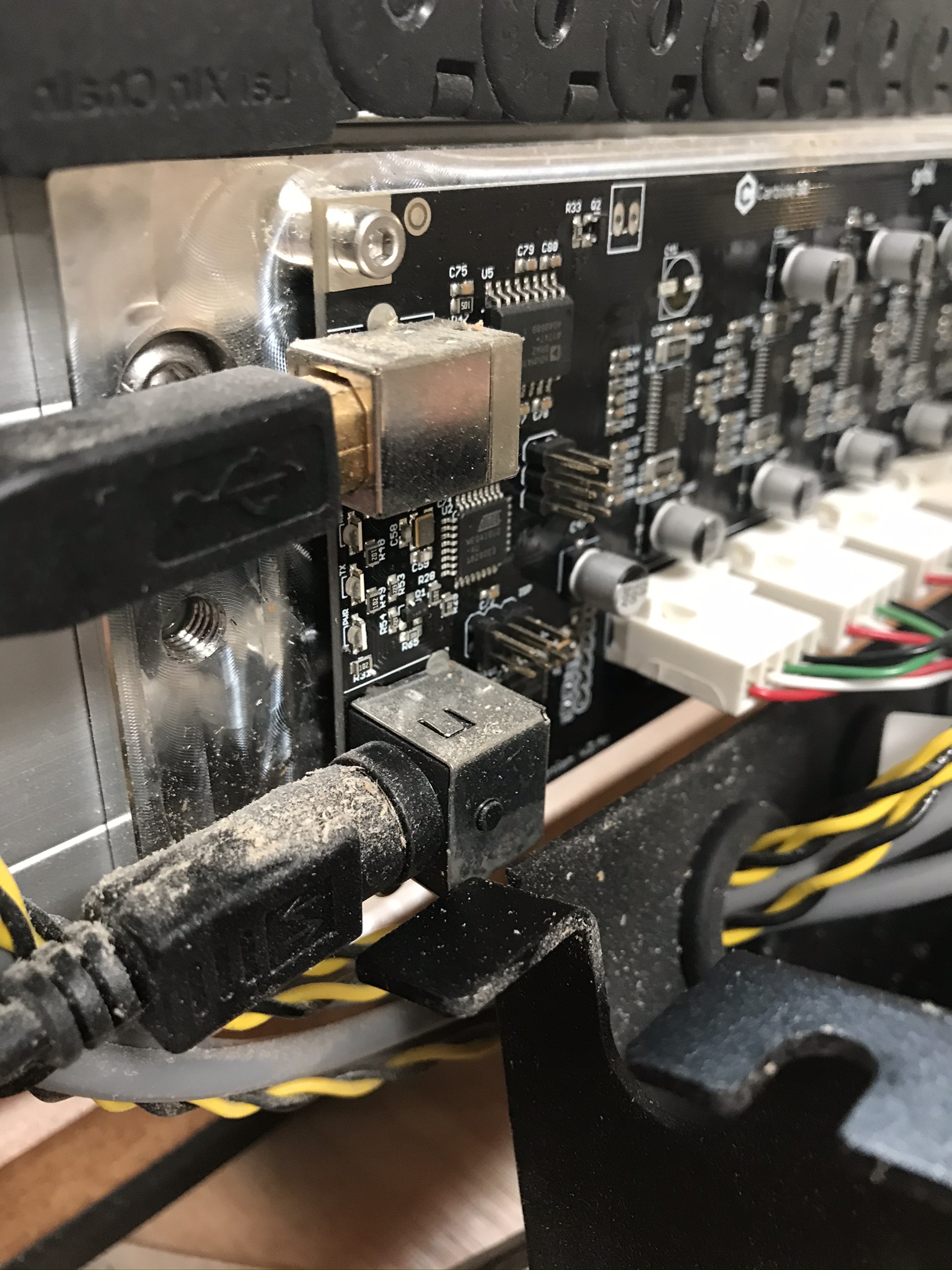

Apologies if I’m teaching grandma to suck eggs. Try star grounding first, bring the Shapeoko 0V and the PSU for the ODrive / Arduino all to a central star ground with nice short fat wires. After that it’s worth looking at an isolator for the comms signal, not sure what the frequency is but the may be an Opto fast enough and latency isn’t really an issue here.
When you say ā€œShapeoko 0Vā€ what pin specifically should I pull that from? The AUX power plug? Also what gauge and how short? Might need to redo my electrical enclosure for that.
From my brief inspection whilst grounding things on mine the Shapeoko control board seems to have a nice chunky ground plane surfaced at the major bolt holes mounting to the aluminium heat sink backplate.
So I’d probably start by putting a crimp ring under one of those bolts to pick up the groundplane in the board.
Note that the USB shield is not meant to be grounded, there’s a nice isolating USB chipset there (the whole board seems to be pretty well done).
Looks like the ODrive HATES it when the Shapeoko turns on even when sharing a ground. Going to have to opto isolate.
