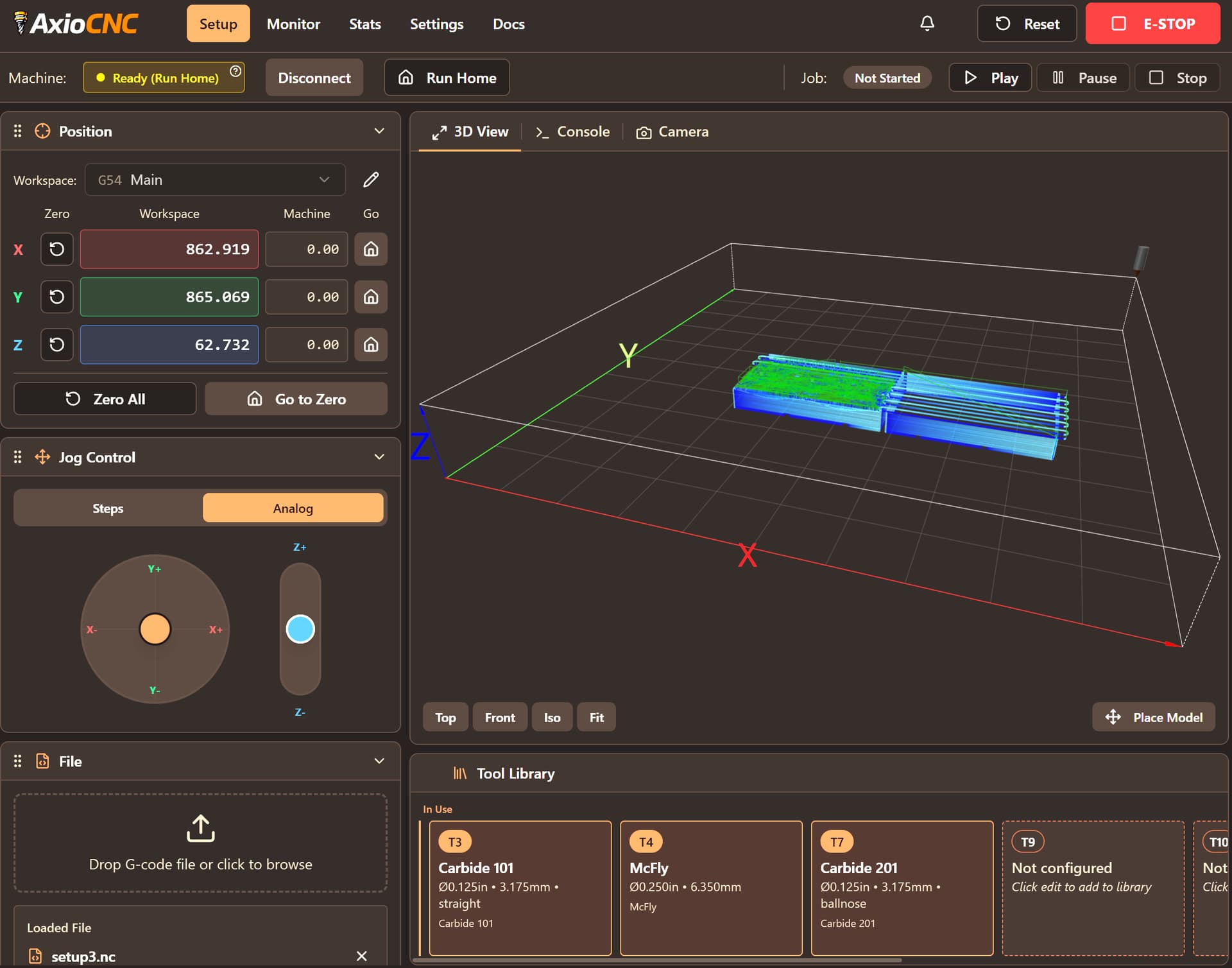

Love my Shapeoko 5 Pro, but I wanted to run a different controller software. I liked cncjs, but wanted more, so I built a new app on top. It’s called AxioCNC and adds a lot of features, especially for Shapeoko machines
  • Native BitZero and BitSetter tool changing
  • Modern design with themes
  • Job outline so you always know where your tool will cut
  • Gamepad support (connected to either the server or the browser)
  • Tool library so it says the next tool is “Carbide 201 1/4” Straight Endmill" instead of “T4”
  • Shows time left to next tool change, how much cutting each tool has done in its lifetime, and how much time was spent cutting vs. transitioning
  • Lots, lots, lots more
It’s completely free and open source. I built it for myself and my own Shapeoko but wanted to share as I think it’s the best controller/sender software out there now. Check it out at https://axiocnc.com

Will this work on a regular cnc running on basic grbl? My second cnc is a Genmitsu 3020 that i use for public demonstration.

In regards to the Machine Presets, when you choose a machine it sets 4 values: the machine’s XYZ size, and which corner it homes too. I know the preset for Shapeoko 5 Pro is correct because I have that machine. I’d like to build the rest of those presets out and add more, but the ones there are just placeholders. It’s VERY simple to add new ones, so I can support any machine you’d like. If the size for the S3 is wrong or different that the S3XXL, I’ll just add new items to that list.
There’s no specific requirements for gCode.
For zero setting blocks, I have the BitZero and generic Touchplate. I just looked at the Sienci Auto Zero touchplate and they provide docs for open source developers to integrate into their own senders! So I’ll add this to the list to work on and get it supported :slight_smile:
A Mikita router setup should work just fine.

It should work just fine on a basic grbl machine. The joystick and analog jogging only work on Grbl 1.1+. Other than that, it should work great. Let me know if you run into any issues, as I only have the S5Pro for testing.

Does it have a warmup cycle built in?
It has a spindle delay that you can set. Whenever an M3 command is part of a gcode file, it will execute the M3, then wait n seconds before going to the next line.
It doesn’t have a built-in warmup (e.g. 60+ seconds at different ramps), but you can either do that with a very simple macro, or I’m happy to make it an optional button. You could also just turn the spindle on and adjust the speed.
What kind of ramp do you use and what would you find most valuable?
a) Very custom - rpm and duration with adjustable number of steps
b) graphical ramp where you can adjust the curve
c) A couple of simple presets so you can just choose and go
I’m still new at this (~ 2 months) and from my understanding if the temps are lower than 59 degrees the Shapeoko spindle and maybe others require a warmup cycle.
I like the idea of option “C”. Maybe a setup for a “Warmup Cycle” where we could tell it to make 4/5 steps at specific “xxxx” RPMs and “xxxx” seconds as duration then save those presets and when we hit the “Warmup Cycle” button it would progress through those settings?
