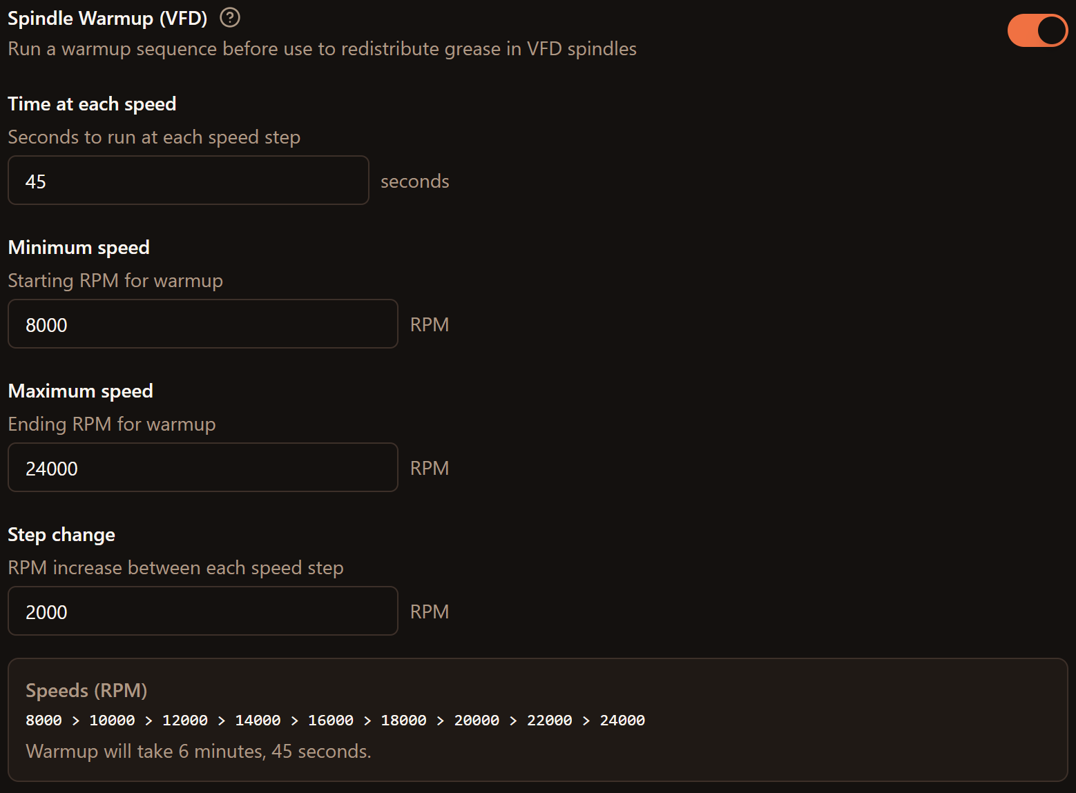

Warmup cycle:
Any thoughts? Look good?

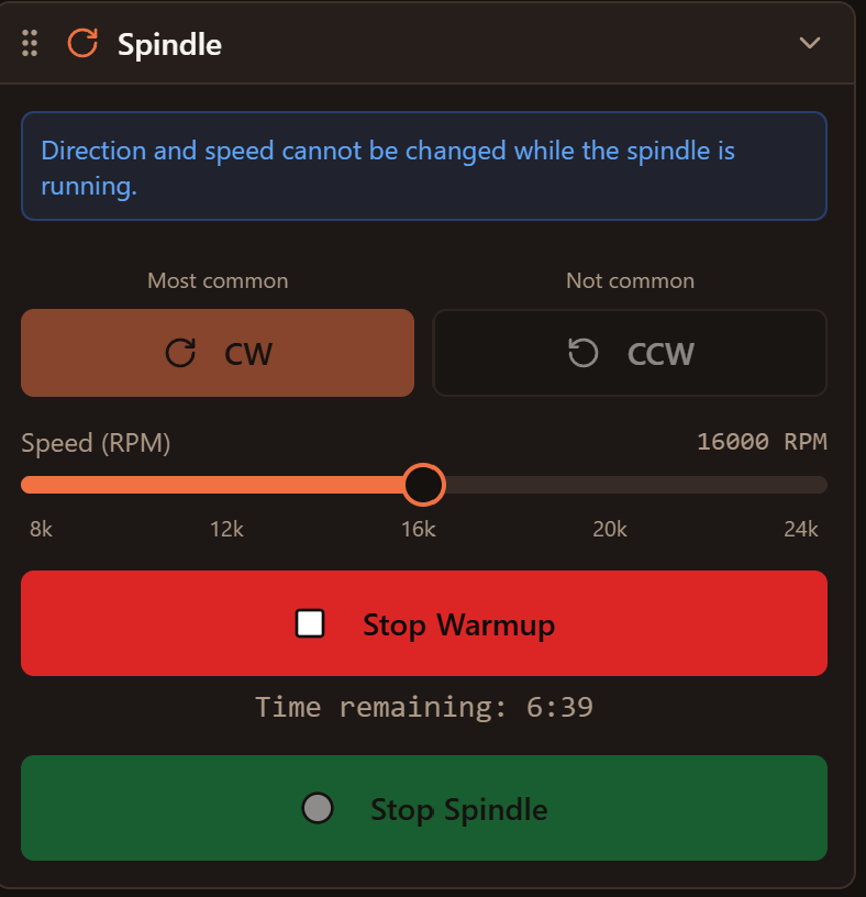

That looks like it would work. What’s the difference between Stop warmup and stop spindle?
I have Stop Spindle disabled while Warmup is running. Maybe I’ll just hide it while warmup is running to make it simpler. They do the same thing.
So would be like “Exit” to get to the previous menu? I wouldn’t think the spindle would be running while getting ready to run a warmup. Either way it looks great!

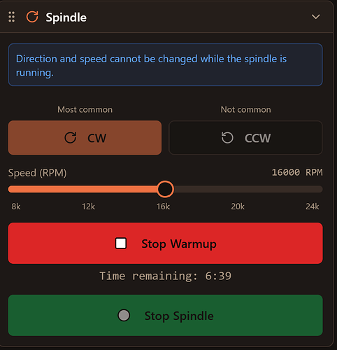

Video worth a thousand words:
You can normally choose a direction/speed and start the spindle manually.
But when you go into Warmup mode, I hide the stop spindle button. To stop the spindle in warmup mode, you push “Stop Warmup”
Hope that makes sense :slight_smile:

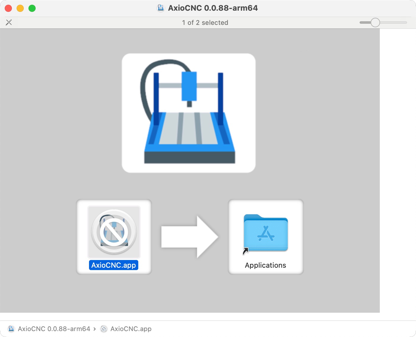

This looks awesome. I do my design work on a Mac, then have a Windows tablet to run CMotion at the table. I tried to install the Mac version on my Mac and got these errors:
Thanks for letting me know! Can you try this one instead?
https://github.com/rsteckler/AxioCNC/releases/download/v0.0.88/axiocnc-desktop_0.0.88_x64.dmg
