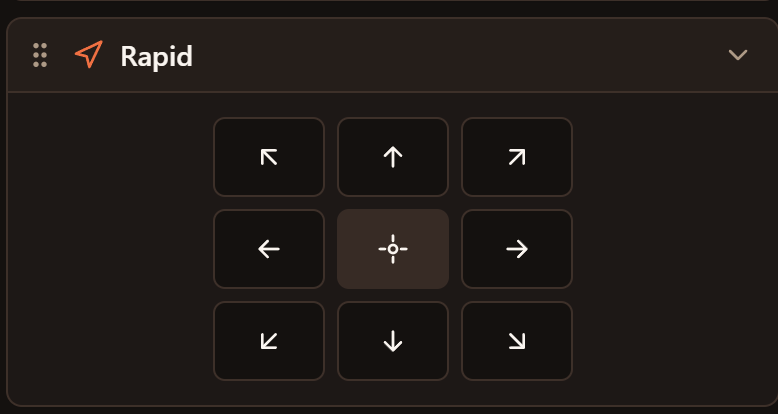

Built a new controller app - feedback wanted
Yep - rapid is already in here!
Keyboard shortcuts are on the list:

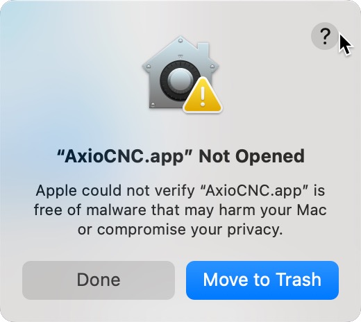

It didn’t have the slash through it, so it seemed to install, but Mac didn’t like it…
Sorry - the website only has the arm64 Mac version. I suspect you have an intel Mac. Try this one:
https://github.com/rsteckler/AxioCNC/releases/download/v0.0.89/axiocnc-desktop_0.0.89_x64.dmg
Yes I do have an intel mac. That one gave me the same error.
