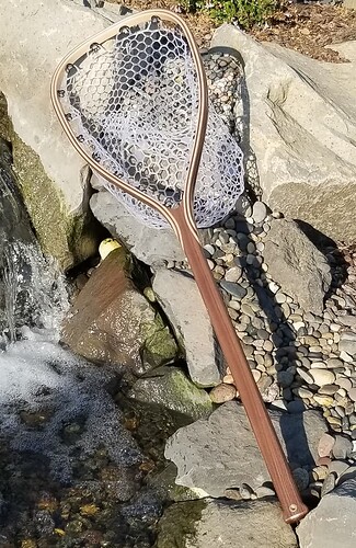

I teach a steamed bent wood fly fishing net class for our local nonprofit fly fishing club (www.csfly.net) as well as for the local chapter of “Healing Waters” which is a military veteran group that fishes. If/when something happens to me I’m donating all of my files, equipment, tools and forms to the club and wanted to make sure they received useful up-to-date digital data so the class can continue without me. I’m providing.SVG files as well as .cd2 files but I wanted to make sure they were usable.
The LD1 or LD5 nets bring in $250 to $350 at the annual fund raising auction.
