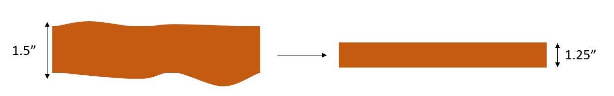

The discussion of flatness comes from this scenario; If we want to take a rough uneven slab and make it have parallel sides.

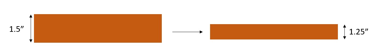

Sounds like you have flat boards so our starting point looks more like this:

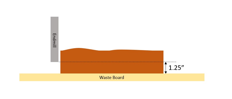

If your boards are flat, there’s no need to cut them again as we can already attain the configuration to thickness the board:

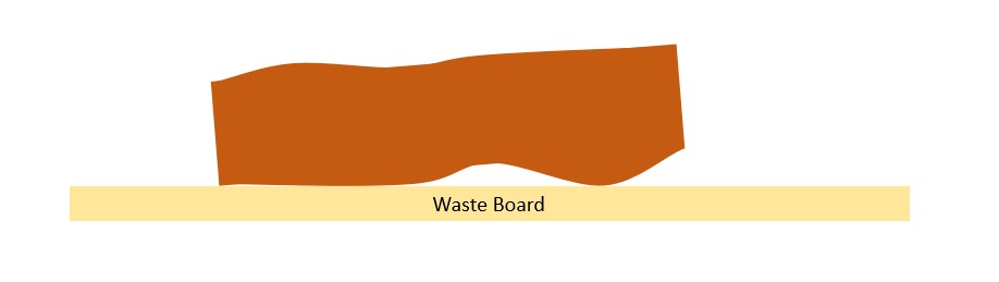

The reason we need at least one flat side is because without it we get this scenario:

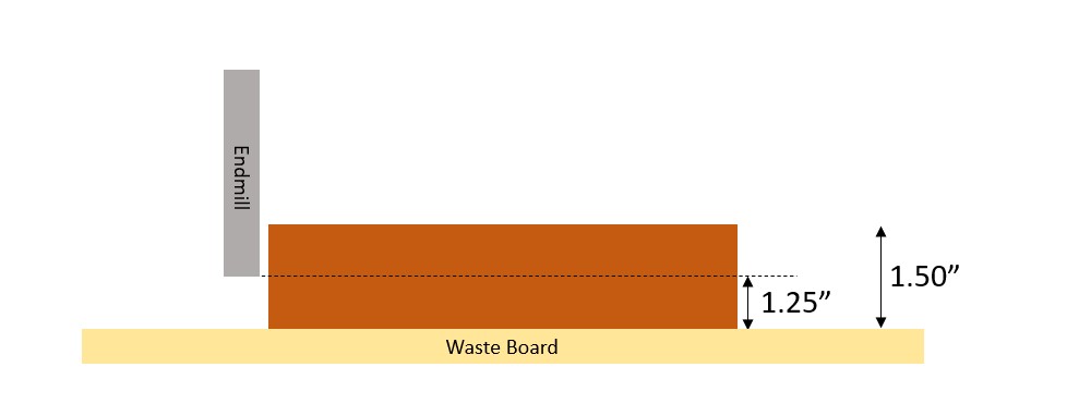

Its also only necessary to flatten one side before surfacing:
