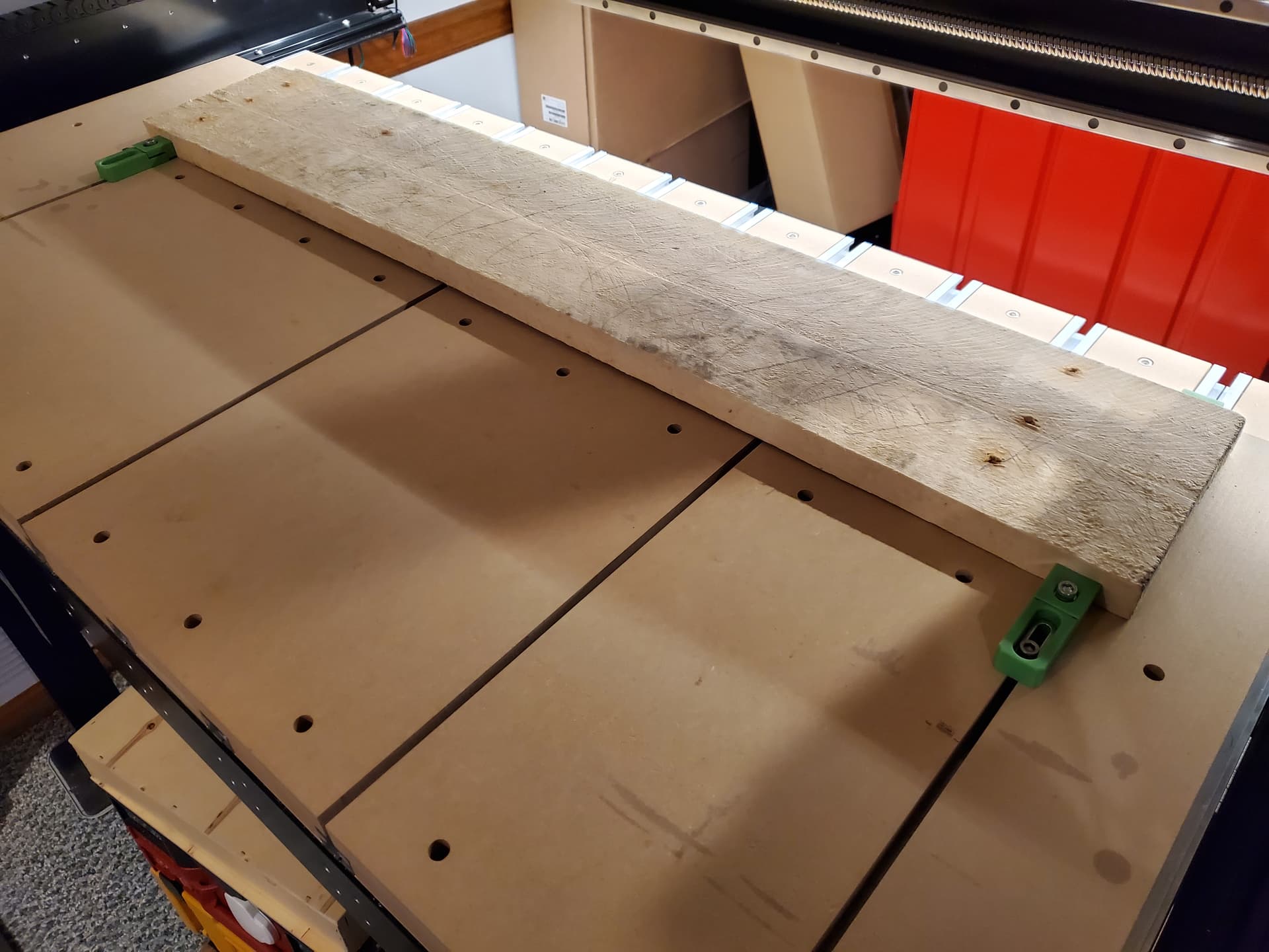

Preparing rough cut lumber for machining
Given a rough piece of stock:
one sets it on the machine, and if need be, adds shims where/as needed to make it as level as possible. and clamp in such a way that the entire top may be surfaced off
set zero, then begin cutting:

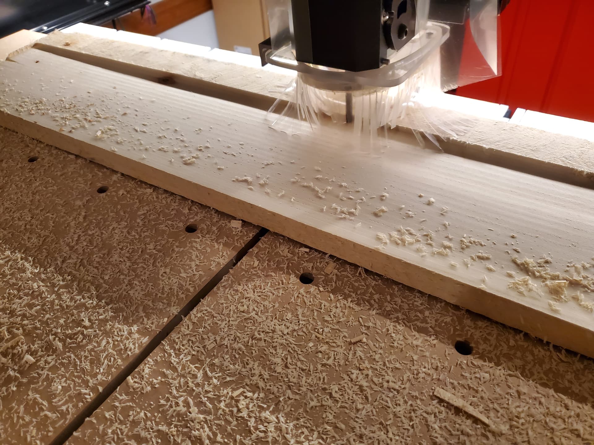

After running the file once:
pocket_464x116_1mm_LOWERLEFT_TOP.c2d (44 KB)
if a repeat is necessary, jog down to zero, then down by the cut depth of the file (1mm) set zero there and repeat — the zero may be adjusted as need be until one arrives at:
and then one flips to do the other side:
Just had to do this with the chunk of red cedar I used in my recent topographical carving. Would have been nice of you to jump in your time machine, @WillAdams and post this about two weeks ago, lol, probably would have saved me the time I spent pondering best way to approach this. I can vouch for this procedure, exactly same solution I came up with.

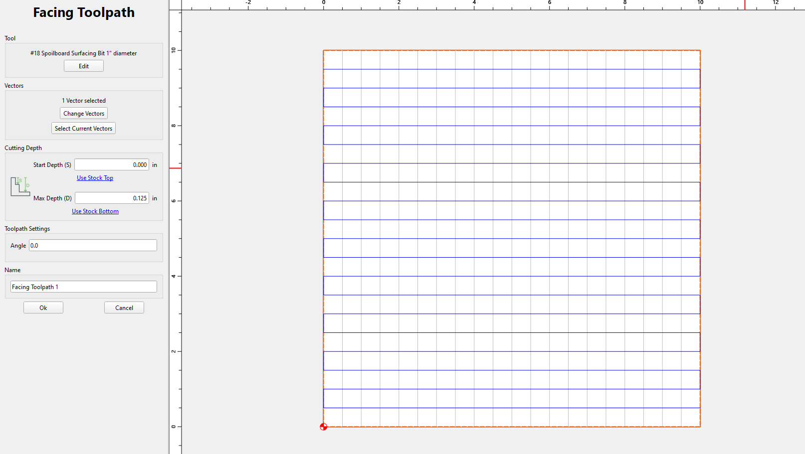

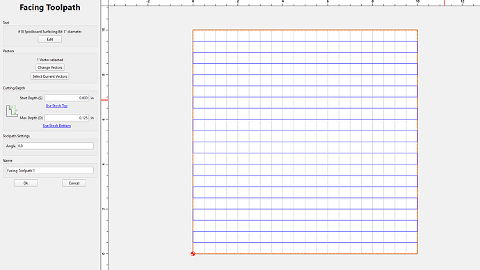

If one wants to surface off for example an 8x12 area:
then the easiest way to do this is to increase the Stock Width by 2 inches and the Height by 1 inch:
Center the rectangle showing the area one wishes to cut as a reference:
Align Vectors
and then draw in the ends:
(and increase the Grid size to match the desired stepover)
Then go into Node Edit mode:
and Cut each circle:
then delete:
Done
Draw in geometry to connect things:
Select the geometry and use Join Vectors to connect it:
Yes
Then use Linear Array:
To replicate as needed:
Draw in the final bits of geometry if need be:
and join as well:
Then adjust as desired for Stock size, origin, toolpath, &c.

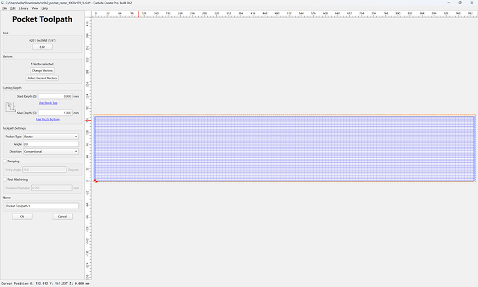

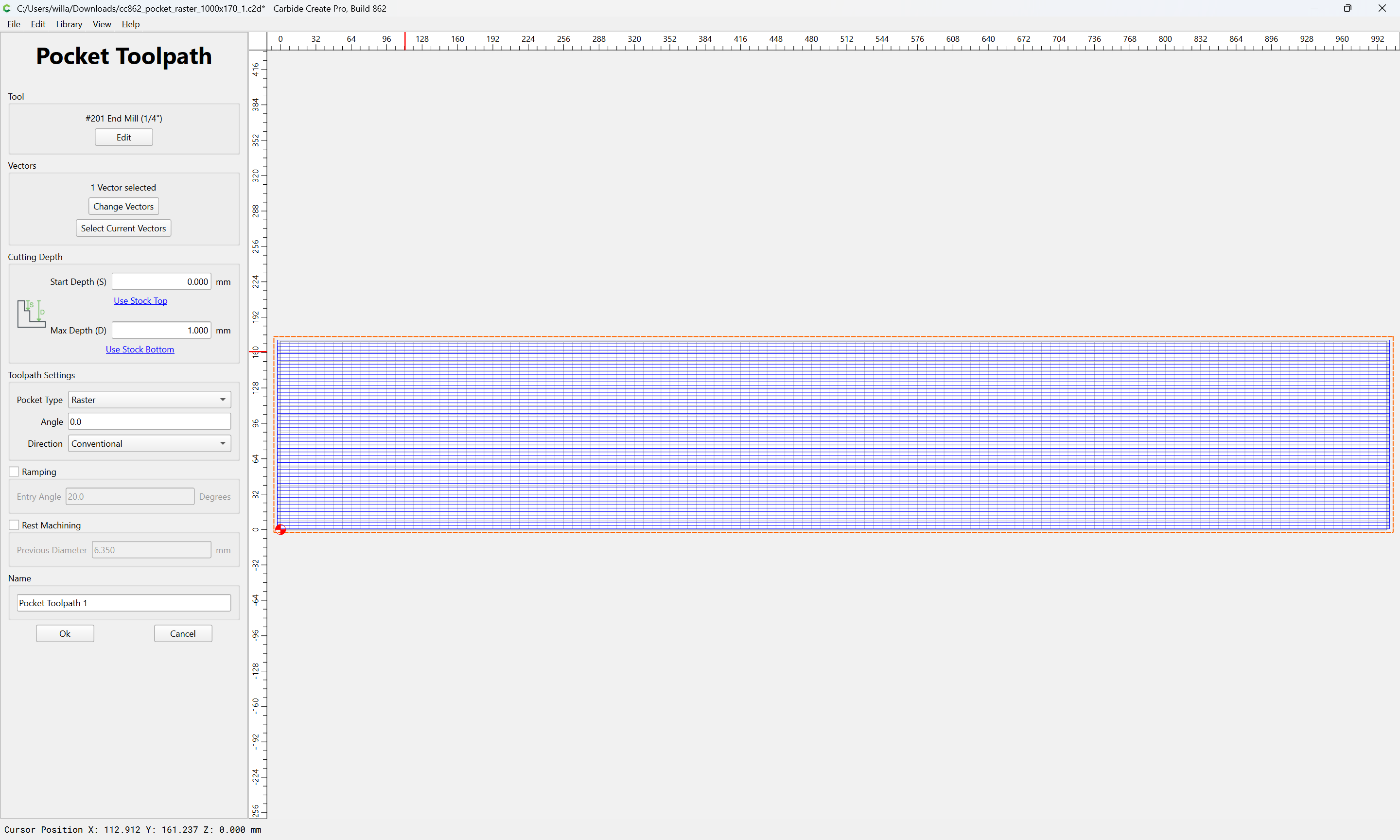

The new Raster option for Pocket Toolpaths:
works well for this as well:
Will - I’m curious to know why you would use the Raster in Pocketing when the Facing toolthpath exists?
Experimenting, and I find the toolpath being limited to w/in the dimensions of a pocket a bit easier to manage when getting low and close to clamps.
Ok so in instances where you’re working in the confines of the clamps or within in a workpiece since the facing tool path cuts past the edges.
