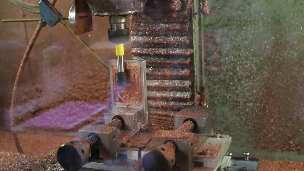

Can the 5 Pro do 0.3mm width saw cutting to make micro fins for GPU/CPU water blocks?
Hello I’m really impressed with the milling tasks the 5 Pro can do with Aluminum. Not sure if I should buy one yet or get a bench top mill such as the PM-25mv converted to CNC.
Curious how precise it could be. Could the 5 Pro can do some precision saw cutting which has a width of 0.3mm?
I will be using VHM 0.3mm saw blade:
I believe I will need some kind of arbor for it. Any ideas how this could be mounted?
To give an idea what I am trying to achieve here, making micro fins which have 0.3mm channel gaps for water to flow through:
Will make various custom parts for PC water cooling.
Thanks for any information.
Here is a video:
Completed part:

We have folks using quite small tooling in our machines, and so long as the workholding is secure, and the feeds and speeds are appropriate, they can cut quite well.
There is one representative @TDA active here, the company for which he works, Precise Bits, is as the name implies a shop specializing in such small tooling — I believe you will find his posts uniformly informative and helpful in evaluating the possibilities of such tooling:
https://community.carbide3d.com/search?q=%40tda%20order%3Alatest
These as the original post indicates, are typically done with saws on the high end. For the highest end ones I’m aware of in production check Optimus. They talk about some of it like the difference between skived and sawn channels (keep in marketing in mind some though). They also have some info about their machines and tools (be ready to choke).
Typically these are attached to a spindle through a toolholder and in some cases a gearbox. You can find a bunch of examples by searching for ISO 30 saw. You could in theory use something with a smooth shank into a collet. However, you would need extremely low runout for the length, weight, and speed of these or it could be dangerous to you and/or the spindle.
There are a handful that use end-mills for this (we sell to a couple). However, the tooling is so small that you need a very high speed spindle (60KRPM+) and extremely low runout for more than one offs. In some cases it’s also specialized tooling as they end up needing extended reach to hit the numbers they want.
If there’s something I can help with let me know.
To be clear, I’ve cut pockets to form slots in that size range. I’ve not cut a grid as you’ve described. I think it would be interesting to try though.

You’re a PC modder, so I’m sure you’re not averse to technical challenges. But the spindle you are speccing out is going to cost you several thousand dollars and is in a class that few (if any) have ever put on a Shapeoko. Particularly an ISO 30, that’s in a different league than anything you would ever find on one of our machines. If you can get away with a lower RPM and more conventional spindle, that would be highly recommended.
You also need to consider whether or not coolant is required for the alloy you want to cut. If so, that’s going to be messy and problematic on a Shapeoko unless you remove the MDF boards.
Realistically, I don’t think your current plan will be feasible on the Shapeoko without easily pushing the price into the 5-figure range. If you can rotate your workpiece upright and use a simple saw on a shaft that would be best IMO. That 60k RPM, micron precision requirement you’re setting is just going to be more trouble and cost than it’s worth.
Going to separate this into 2 sections. One from the machining side and one from being a water cooled PC user for about 20 years (yes back when we used car heater cores and pond pumps… Anybody remember DangerDen?)
From the machining side:
I was saying that from the standpoint of if you were going to chuck up a shanked version as opposed to a ISO version. This is due to the length you would need on the shank of the arbor. With radial runout the runout increases the further you get from the collet face and with something that long you can run into issues. In industries that use things like that (collet extensions over 4") typically you see tolerances for total system runout not more than 0.0004" (0.010mm). This changes some when talking about running end-mills in metal. In this case I’m just talking about forces that the machine can take due to balance issues from the offset mass. Technically this comes down to the allowed amount of dynamic load that the bearings in the spindle can take and that will go up with spindle size and quality. Specific to saws there’s an issue of which teeth will engage, by how much, or completely miss based on the runout in the configuration shown in your video.
Those are an option and change a lot of the parameters. If these or ones more like the ones in your video are used depends on application. These “right angle” ones have a lot of advantages from the standpoint that you are reducing the Z distance to the cut. They also change the axis that you will be milling from making your Z need less distance and let you potentially fit more plate on a single run.
Depends on which way you go. If you are looking at saws they have different requirements and typically require much more power than end-mills would. In that format you are looking at spindles that are in the thousands and usually require a 3 phase VFD to get to the frequency for the high RPM.
On the end-mill side when you get down to stuff this small you need RPM and reduced runout more than power. A common “cheap” entry point here would be NSK or maybe Jaeger spindles either air or electric powered as you need almost no torque when getting down to bits this small.
In terms of runout for bits it’s down to the size bits and life you are looking for. The old rule of thumb was that 10% of the diameter of the tool in runout would snap a bit. This is more related to runout’s effect on chipload but it’s a decent number to start from. The tool life for large tooling in metal usually works out to a 10% increase in tool life for each 0.0001" (0.0025mm) of runout reduction. In smaller tooling it’s more (studies vary on the amount…by a lot) and also effected by the number of flutes on the cutter and the percent of runout related to chipload.
Yes but not one I’ll post here. We sell tooling which technically puts us in competition with Carbide3D. Additionally, I try to stay brand neutral and avoid anything that could be taken as marketing. If you want some specifics send me a message or email.
There’s no reason the the SO5 couldn’t do the motion side for something like this. There would though be modifications required that would probably exceed the cost of the machine. That would also be true of a PM-25. In general there’s not a lot of machines that could do these kinds of things out of the box without a large price tag. Lot’s of people get there by incremental steps on less expensive hardware though.
You probably aren’t going to get as much in this specific application by going over to a “heavy mill”. Usually the advantage there is to the rigidity and deflection resistance. Once you start talking about things this small the accuracy/repeatability are what matters more than almost anything else. Both your examples don’t have as much of this as I would like for the application.

Just to get it out of the way now as it seems to keep being lost. You don’t need high RPM if you are doing the saw. If you start looking at using end-mills in that size that’s when you need the high RPM as you surface speed goes through the floor.
Yeah, they would have been before your time. As far as I can remember they where the first ones to offer “main stream” maze designs (pre pin) and some of the first pin designs. They have been out of business for a while though.
In terms of advanced block designs in general, pin designs for the most part aren’t. Even with jet plates they suffer from dead zones. A lot of the more recent leaps have been forcing the water flow and turbulence. That has mostly come at the cost of higher resistance though. It’s also hard to do with grid, pin, or maze.
From my perspective the main issue with the Chinese spindles isn’t if they CAN make a good spindle with low runout. It’s that you can’t rely on the quality unit to unit or that the parts like bearings will hold up to their much more expensive competitors. That’s not to say that they are a bad option, just that you have to know what you are getting into.
Make sure that you are testing the bore. That’s what the runout spec is on a spindle. Test it at the face near the chamfer and as high as you can get in the bore. As you are doing this mark the high points in both cases. If they are 180° apart you have an issue even if it is to spec as that will produce angular (skew) runout. This type of runout gets worse the further from the collet you get and you are going to be sticking out a lot. After you do that test the collets. You might get lucky but in most cases the collets that come with most of these aren’t great. If you need high quality spec’ed ones check us (precisebits), Rego-Fix (inventors of the ER collet), Techniks UP grade, or Pioneer.
Just depends on how you want to mount them. They are functionally the same internally.
