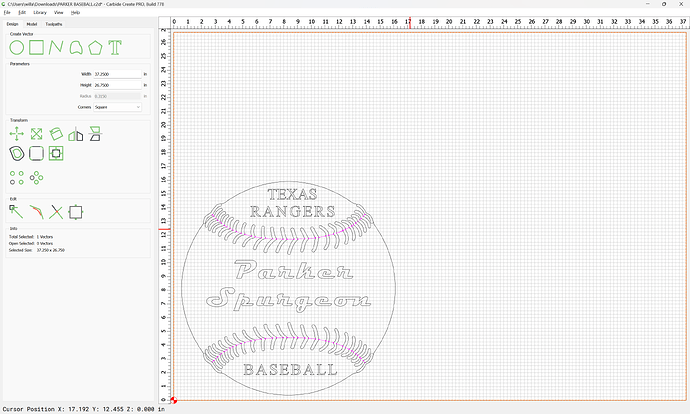

Just bought a Shapeoko 5 pro and the preprogramed library for the baseball, I cannot get the seams to look good in the simulation. Also, I’ve tried the Army seal and not all the art will be displayed after Vcarve.

Upload the files you are having difficulty with?
For techniques for military designs see:
PARKER BASEBALL.c2d (860 KB)

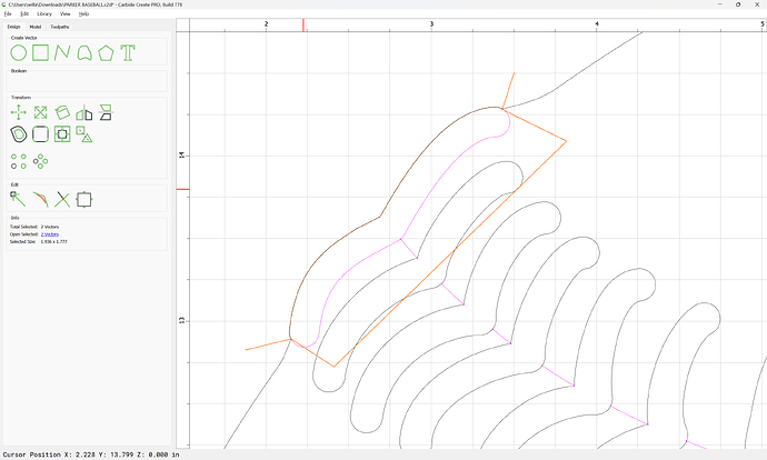

Two issues with this file:
First, delete the extraneous surrounding pieces (zooming in to see which is in the right place), then draw in geometry which defines how the surrounding profile may be incorporated with the seams at the edge which are partially drawn with open geometry:
then duplicate the surrounding geometry and use Trim Vectors to isolate what is needed to close this geometry:
OK
Remove the geometry used for trimming:
Then select the open geometry which defines this outer seam:
Yes
Repeat for the other seams

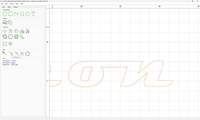

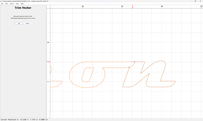

Note that where text overlaps:
The text should be converted to curves:
and then Trim Vectors used to remove the overlapping geometry:
OK
Use Join Vectors to close this geometry:
Yes
