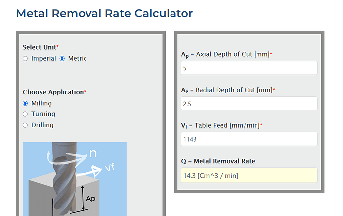

Thats a 1/8" 3 flute endmil with a 50% stepover and a .125" DoC.
The BLDC-8015 driver sucks, so I can’t suggest it at all. No speed fidelity at all with a 14 pole motor… I’ll be making a pwm to pmm converter and throwing a VESC on there to drive it with some actual speed fidelity so I can cut steel and have better drilling, but right now for cutting aluminum it RIPS! I’ve got some 5mm cutters on the way and I can’t wait to see what the MRR will be like with those. I think this has a lot more overhead in terms of power, so I think I can swing a larger diameter endmill with a deeper DOC and maintain a 50% stepover.

Oh man. I just tried a 5mm cutter. This is actually a reasonably fast machine now.
I have video of it that I need to upload. Its wild how fast the chips build up now. I can’t believe how much this has transformed the machine from a metal scratcher to a chip flinger. Having the ability to rough in a large 6x6x1" material in 30 min or less is going to drastically change the projects I do on this thing. I believe the 8mm spindle is the current bottleneck and I have what may be a simple 10mm shaft upgrade. I ordered parts and they’ll be here in the middle of June. If it works, that makes this whole project a bolt-in affair that gives you over 1/2hp, maybe closer to 3/4hp in a Nomad. My peak wattage measured at the plug was 680w. With the motor off it consumes 12w. That poor little timing belt LOL!
