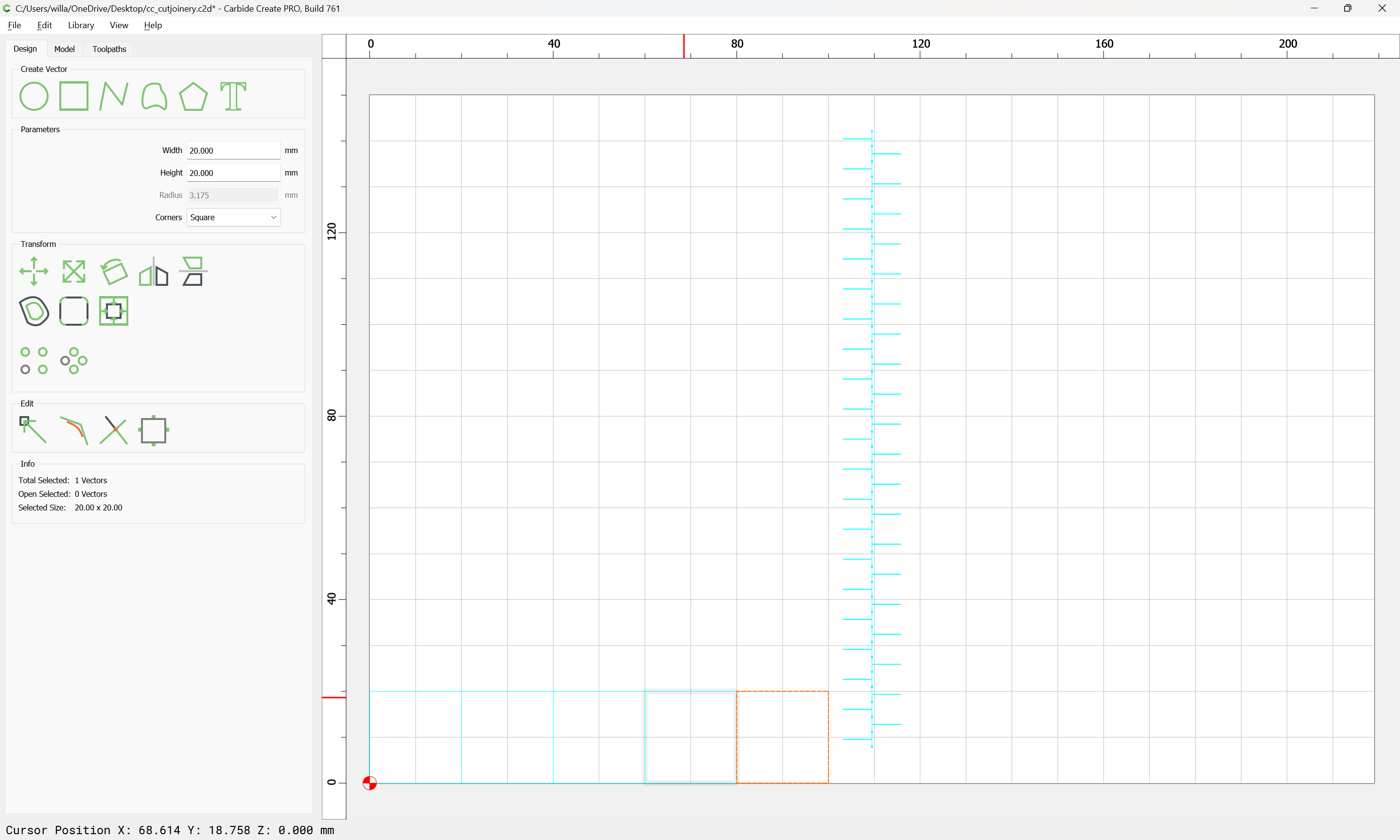

I get an accurate highlighting for a row of five 20mm squares in my current project:
and was able to select each of the 5 at will.
Usually zooming in a bit will help.

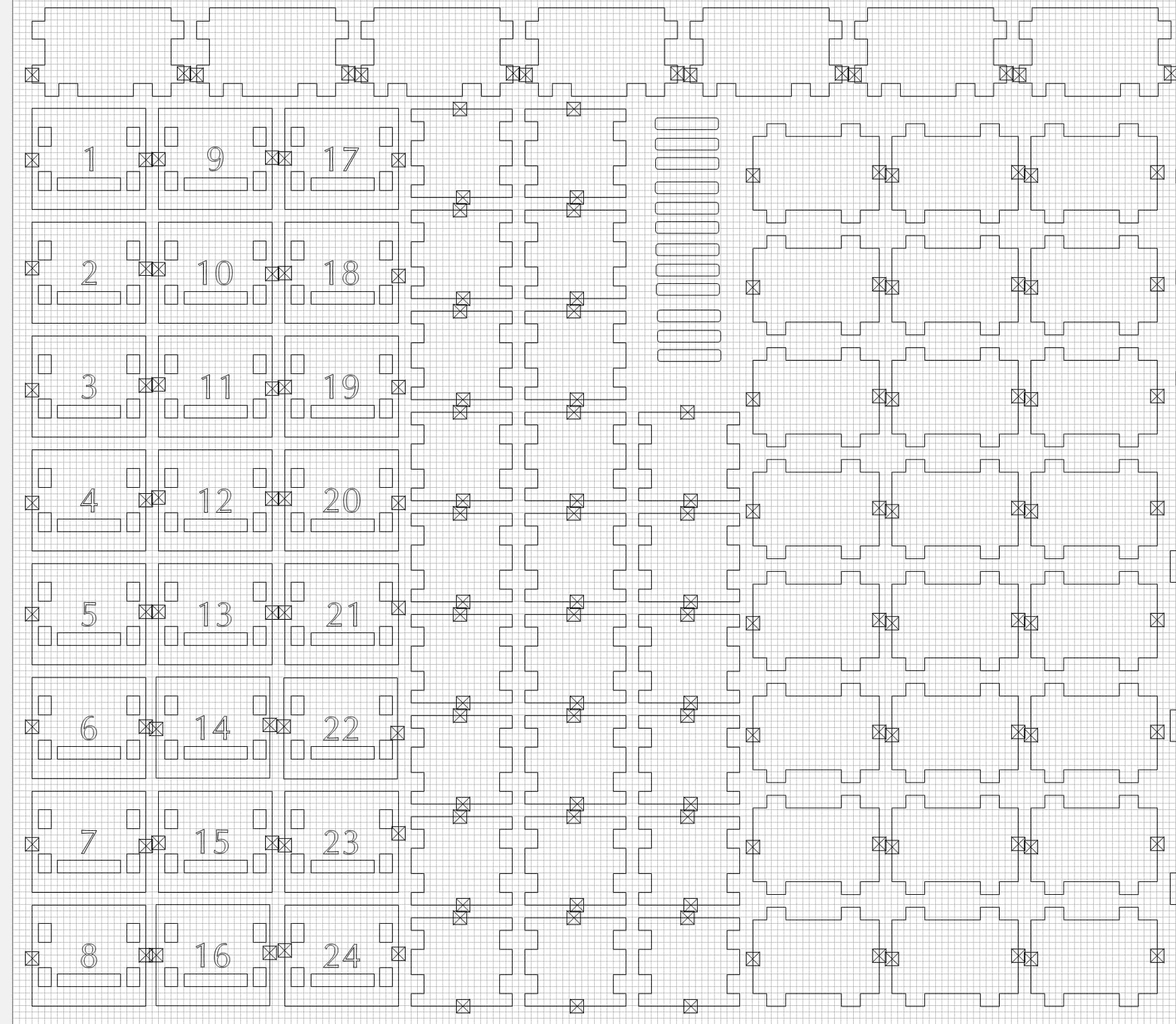

Here’s an example of what I am working with.
Honesty the problem pops up with smaller jobs too. It feels like the pointer tool is just not accurate. It often just selects the wrong thing.
I’m working with a full 2ft x 4ft bed. Zooming in will work but its very hard to zoom in then out then in then out to try and select 24 boxes to group.

This is more easily seen with nested objects. A huge part of the problem is that the ‘tip’ of the pointer is not the point of selection - instead, it seems that whatever object the pointer touches stays high-lighted for selection as long as any part of the pointer touches it, even if the pointer moves over other objects.
Of course I can’t take a screen shot of this behavior, since a screenshot removes the pointer :(.
In this image, the tip of the pointer was located outside the outermost box. It had started inside all the boxes, and I moved it towards the outside. But, since it was still touching something else from before, that is what got selected.

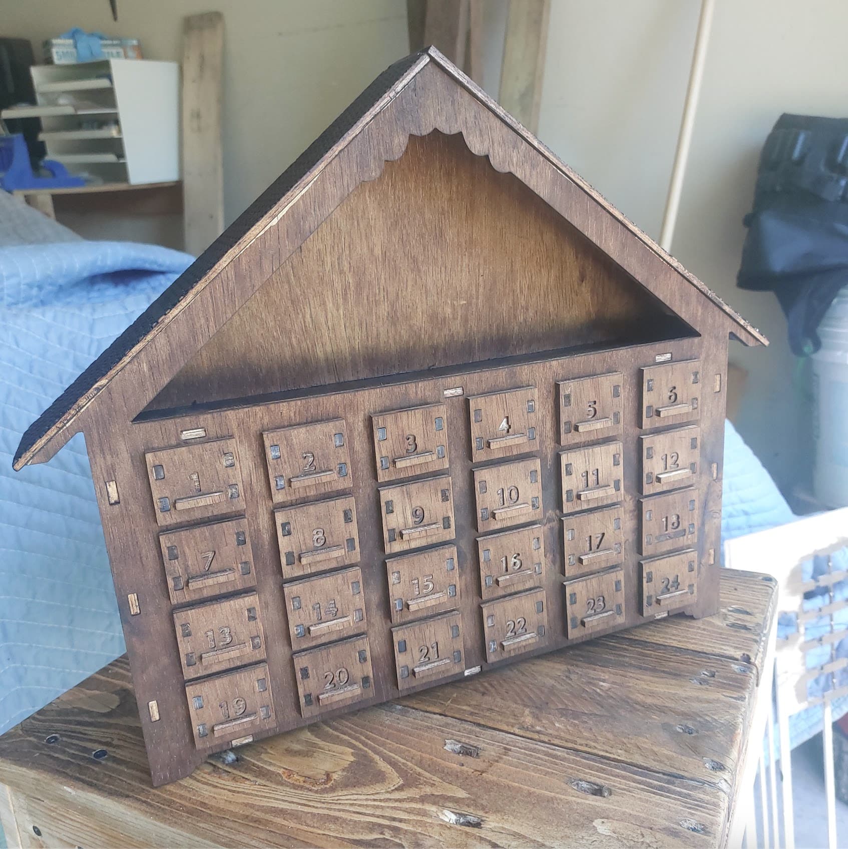

Have you cut that file yet?
Are you using a laser, or do you square up the mortises with a file? Or do you relieve the tenons w/ a roundover tool?
Why no dogbones?
With a 1/8" bit on 1/8th luan ply, the tenans fit snugly without any filing. I think dogbone would take too much space for such small work.
