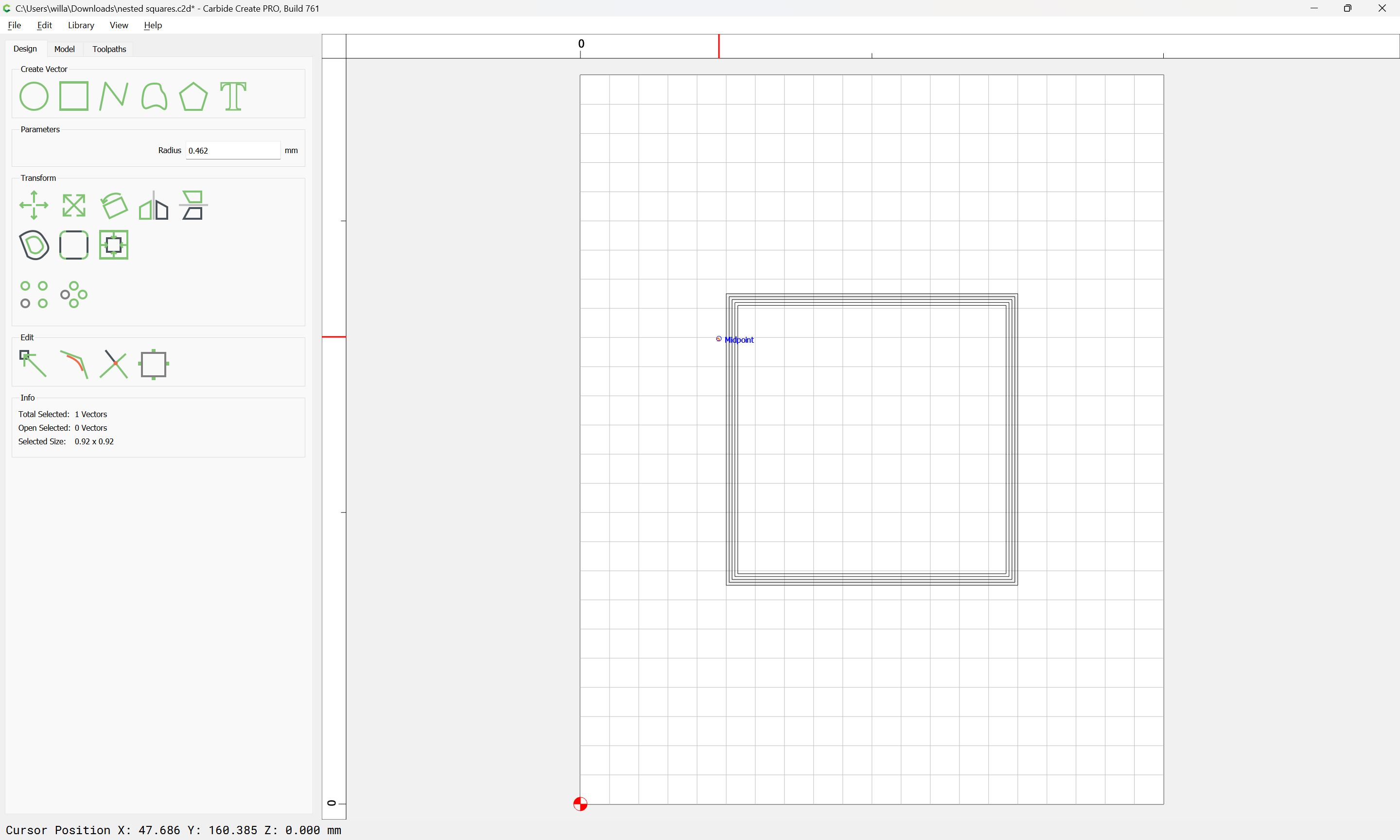

Here is some nested squares, 1mm apart. If you are zoomed out enough that the pointer will hit two or more lines, it quite confusing what line will be selected.
For example, try to select the second line in (from either side) It’s very difficult unless you zoom in enough that the pointer only hits one line.

Done, no zooming:
I will note that the cursor was a bit further away than one might want, roughly at:
so perhaps this will be a useful datapoint:
nested squares.c2d (44 KB)
(you can select the rectangle in question if one moves to the circle, then a bit up/down and clicks while it is highlighted)

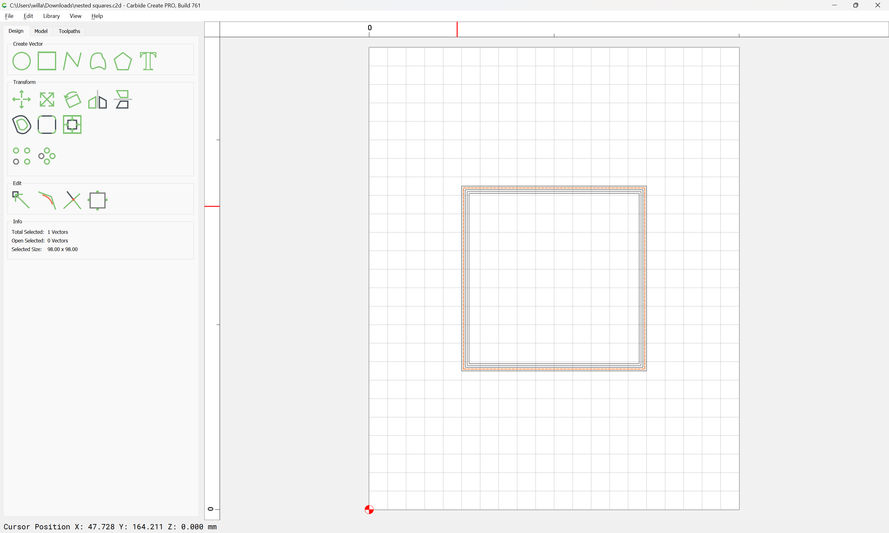

Here’s another version of the nested squares where the creation order is different. Selected the second outermost of these is also difficult unless zoomed:
Nested 2.c2d (44 KB)
One thing I’ve noticed is, although the highlighting is indeed sensitive to the tip of the arrow, it highlights from a good 10 pixels away.
So you need to zoom in so close vectors are at least 20 pixels apart to select the ‘other’ vector.

I suspect the tradeoff which has to be considered here is what performance will be lost by the current algorithm which uses object creation order — it’s nice when it presents the recently made thing which one wants to work with, but an obstacle when one wants some other object.

We added some code to try and look closer at which object is nearest to the pointer tip for the next release. Hopefully it will not add too much of a delay on older computers and larger files.
We’ll still be a little limited by the Qt framework, which may not recognize some objects under the mouse if there are a lot of candidates (seemingly in a specific, overlapping orientation), but it seems to be a step forward.
763 is up with the fix: Carbide Create Beta 760 - #27 by robgrz

I just checked the beta out, it does appear to have made the problem better, also it feels more speedy.
