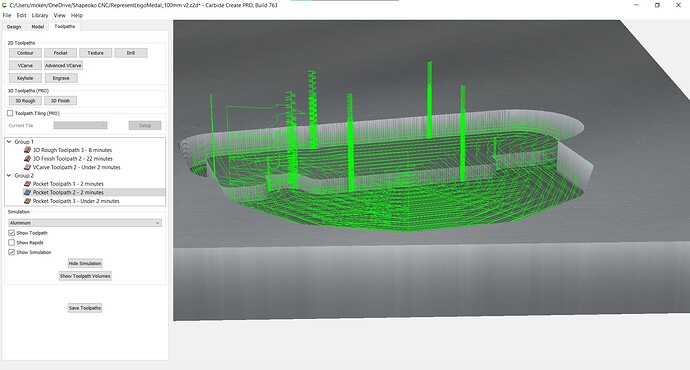

I feel like this is a stupid question, but how do you get the toolpath volume? I’m running 763, I’ve got the simulation showing and… I see nothing about a toolpath volume. It’s a pocket operation, so the volume should exist.
EDIT - Toolpath Volume is Pro only, I missed that part. Problem solved!
Nothing in the menus, no buttons, nothing on right-click. What an I missing?
Run Simulation…
It’s a Pro-Only feature. From the looks of that screen, you’re not running the pro version.
