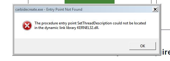

So is carbide create beta 814 the pro version or the free version. I get and error message when I try to run it.
That error message means that you’re probably on Windows 7 or Windows 8, which are missing some functions we rely on.
For what it’s worth, there’s been no change to the versions of Windows we support for a while, so this is not specifically related to this beta release.
I am running on a windows 10 pc. Now when I try to install I get a message can not run on this computer. It appears this will require a new pc. Don’t really want to spend money on another one. I guess I will be left in the cnc dust going forward.
Windows 10 is currently scheduled for end-of-life 14 October 2025:
So, getting a new computer is pretty much inevitable, arguably better sooner, while the computer is still running and data can be transferred, than later.
If I remember correctly, that function got added midway though WIndows 10, so you should be able to update to the current Windows 10 to get it.
To answer this one, they are one and the same. The “Pro” code is there, it’s just disabled until you apply the license. If you have the pro license “license.txt” in the data directory it should fire up in Pro mode.
