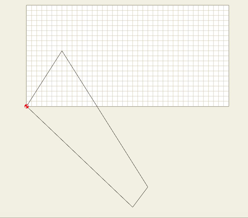

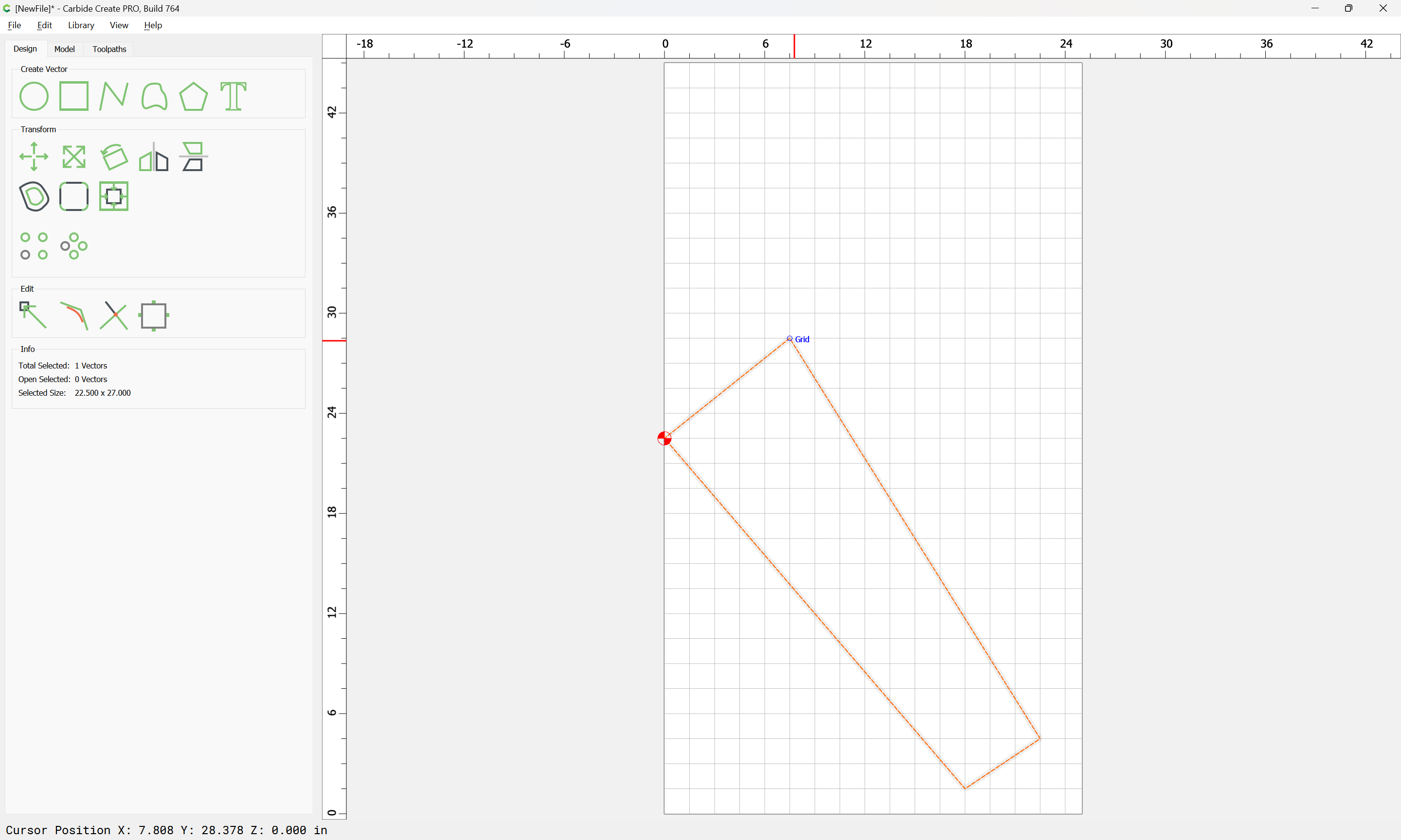

I have a Standard Size Shapeoko Pro. Turns out one of the shapes I need to cut out is too big to fit in the “normal” orientation, but if I rotate it 60º clockwise, it’ll fit, like so:
In this setup, the grid is sized about 7-8mm smaller than what my Shapeoko Pro Std can do in terms of bit center movement, so that I can use a ¼" diameter bit to cut things out.
As you can see, the object fits with some room to spare, but now I have a problem in choosing and finding an XY zero. I’ll almost certainly start with stock that’s rectangular, but the lower left corner of that stock isn’t in any of the choices for Toolpath Zero.
What’s the best way around this in Carbide Create? Yeah, I could go to Fusion360, but these are simple cut-outs in 1/4-3/8" stock, so CC is just way easier all around.

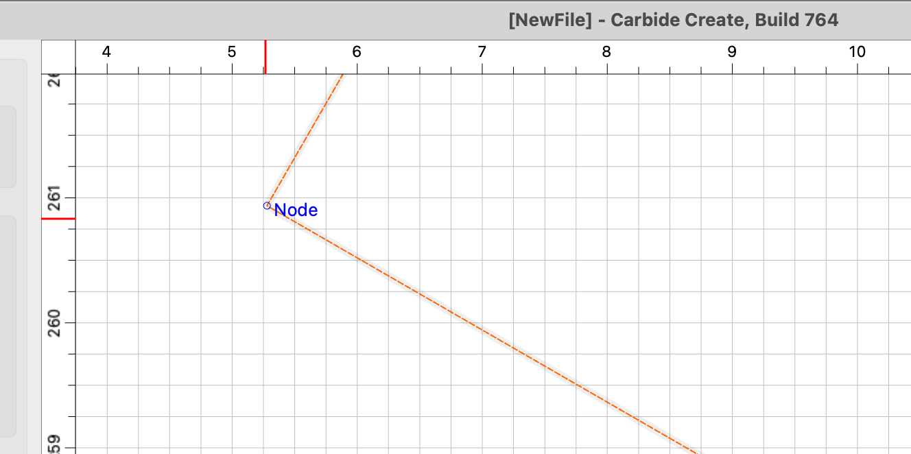

- Now, ideally I could find the leftmost point of the object, but CC doesn’t tell me that. Here’s the best I can do:
So, the X-location is slightly over 5.25mm.
Question: Is there come way to get the exact X/Y location of that point?
- What I’ll do next is mark the top reference board at X=5.26mm. This would be my zero point, and use “Top-Left” in CC. Of course I won’t be able to mark that board to a 0.01mm accuracy.
