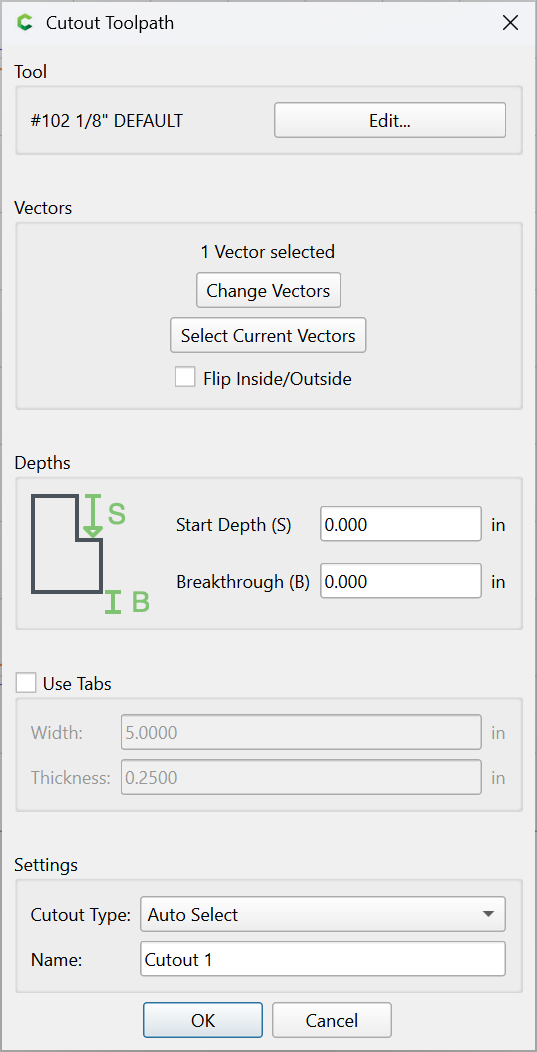

Carbide create newby question
Can someone point me to the setting, so this simple toolpath cuts in a single 1/8" pass?
Thanks!
See:

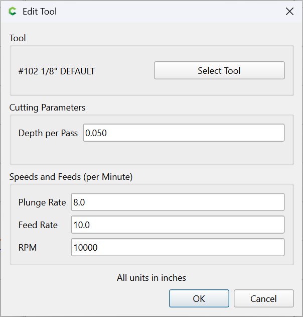

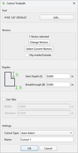

Specifically you want “Depth per Pass” which is a tool setting, so edit the toolpath:
Edit the Tool

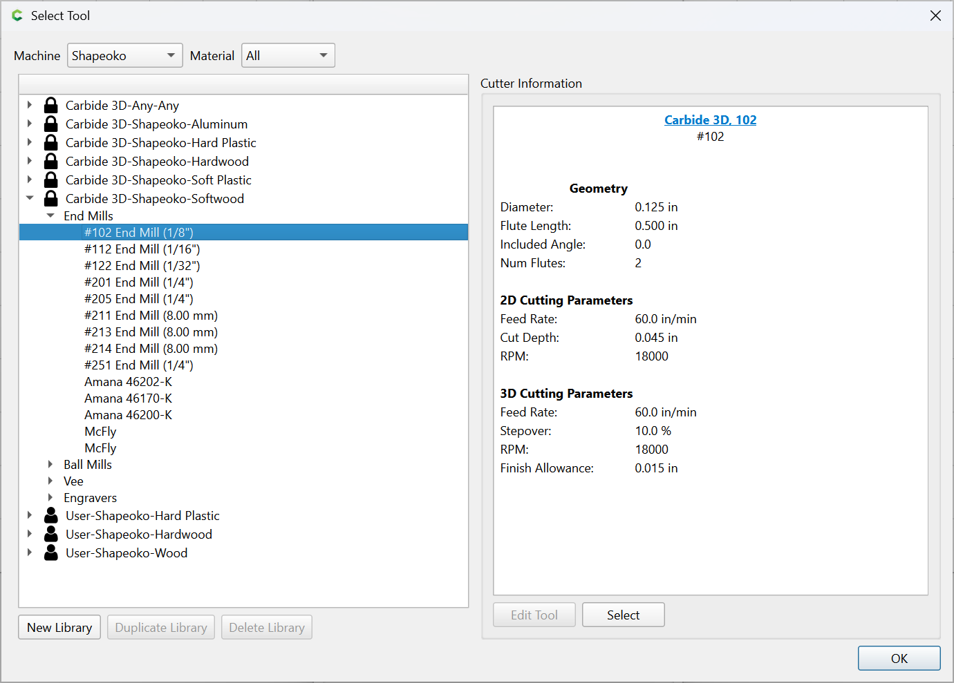

If need be, select a suitable tool/material.
Select Tool

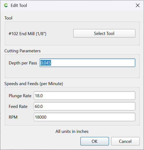

then change the Depth per Pass to a setting appropriate to the tool you are using, the material you are cutting, the torque of the spindle, and the rigidity of the machine
c.f.,
That said, please upload your file — that’s a long time for a Cutout toolpath.
