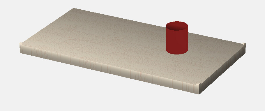

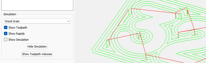

I’m not seeing the toolpath
And the slow speed is still way too fast.
And there really should be a step (one block at a time) option.
Really cool would be to see the toolpath listing & have it follow the simulation ![]()
The top plane and the toolpath are overlapping each other. We’ll probably do something to shift the toolpath higher in Z when rendering so it’s not covered by the stock in process.
This was a big change to the internals of Create so, for now, the priority is to check for stability across a range of customer PCs. We have a lot of ideas for where to go in the future, but we won’t be doing any of that until we know it’s stable.
Nope, If I turn off the simulation to show only the path it still doesn’t display.

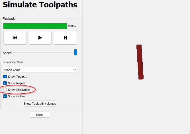

The animated simulation is a very useful feature however is there anyway to turn it on and off ? (new way verses old way)( 3D animated simulation verses right to 3d image) or a button to jump to the end >>I ? There is a button to jump to the beginning I<<

I also asked about a fast forward when I just want to see the final results. Other software has a “Suppress Graphics” option that only shows the result when that’s all you need to see.
All of the rendering and graphics happen in a different thread, so if you have a semi-modern PC, there should be little to no slowdown from the animation. If you have a two core machine, it could be a little slower, depending on the project.

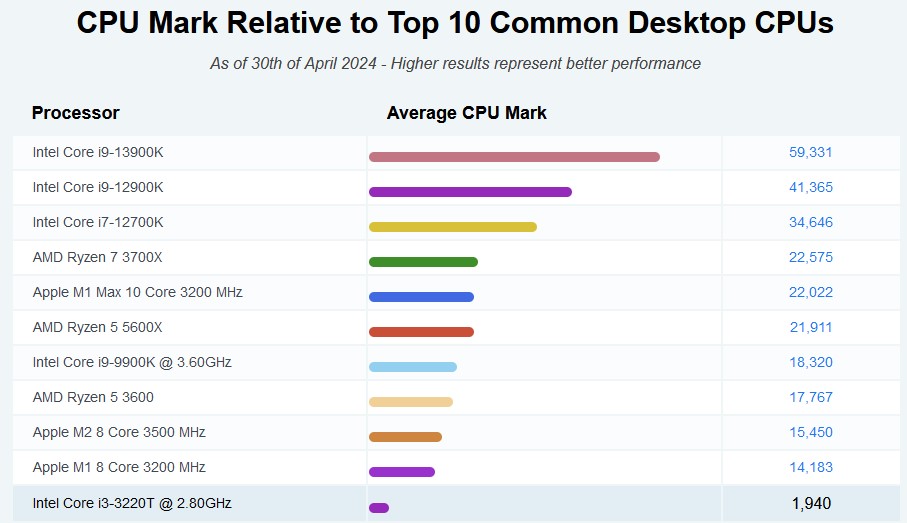

Processor Intel(R) Core™ i3-3220T CPU @ 2.80GHz 2.80 GHz
Installed RAM 8.00 GB
Graphics Intel HD Graphics 2500 .
System type 64-bit operating system, x64-based processor
Drivers are all up to date.
Windows 10
PC has been rebooted ![]()
Also If I change from high res to low resolution it drastically decreases the time .
I am hoping there will be an option to skip the animation. ???
Thanks however it worked fine for 764.
Therefore 773 comes with an understanding that you may need to upgrade your PC just to run the animation. Not sure I believe that is reasonable.

I just checked with a fellow C3D carver friend of mine and his shop PC is older then mine. There are many people that use less expensive or maybe older machines in their shops. Or cascade their older machine to the shop.
I have many programs running on this machine mostly CAD and image programs for my 3D printing. Including other carving software. This is the first program to display this for me.
