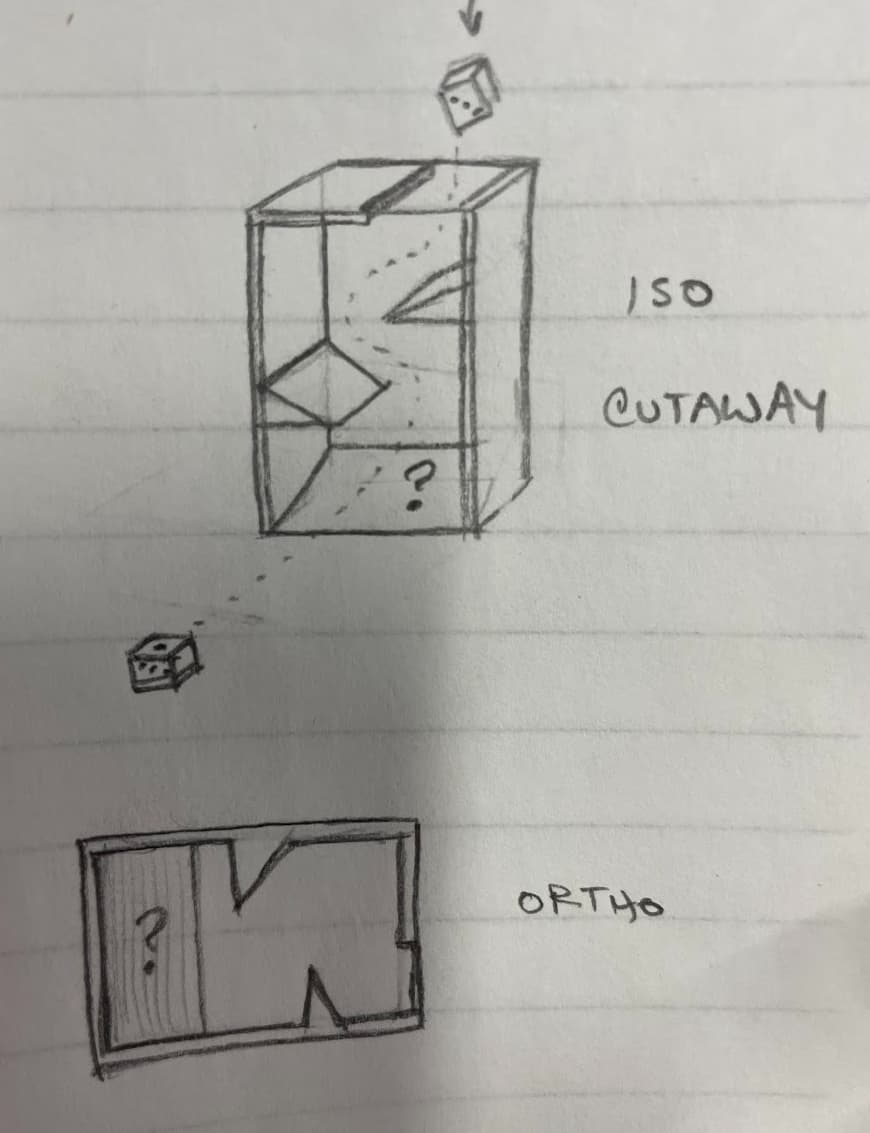

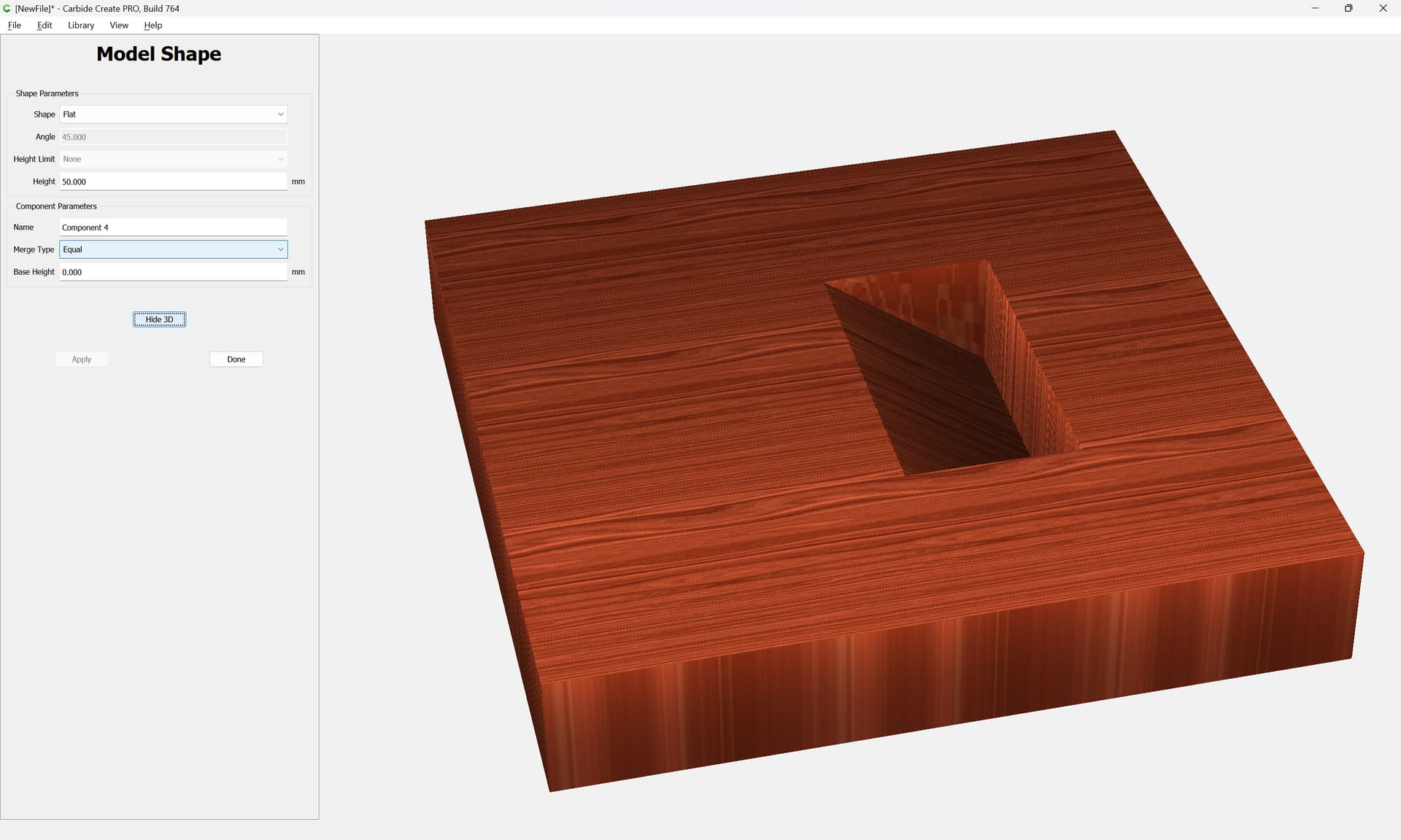

I’m designing a compact dice rolling tower that will be cut on a CNC and require minimal assembly. I am trying to figure out how to make a “forward angle”. I would like to design this as two mirrored pieces and just glue them together to create a sealed inside (see drawing). I have cut topo maps and am familiar with cutting 3D shapes from grayscale or STL. However, this seems like it should be simple and less “hacky” than generating a grayscale image in photoshop or modeling an STL in another application.
Here’s a diagram:
In the isometric cutaway sketch, you’ll see that the die is dropped in a hole in the top, bounces off two angled surfaces, and then is ejected in the front by an angled surface. This is the surface I’m struggling to create.
In the ortho view, you can see that cutting the first two angles is easy since they are 90 degree cuts into the work material. But the final angle needs to ramp with a rough and finishing pass.

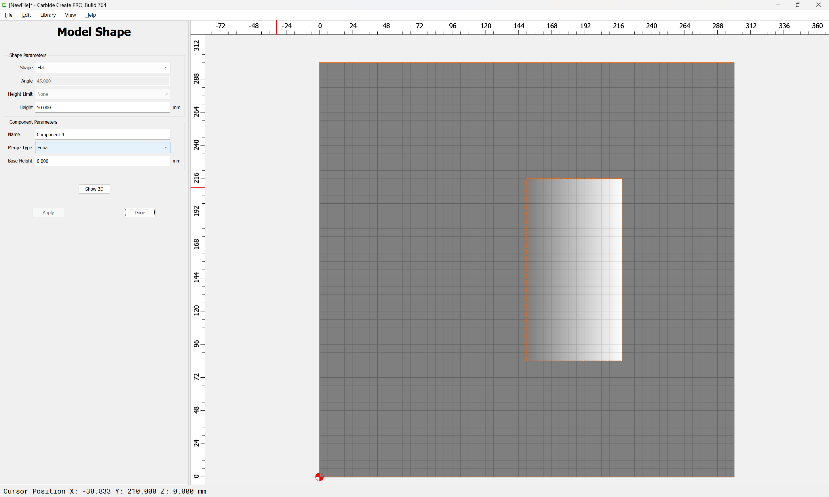

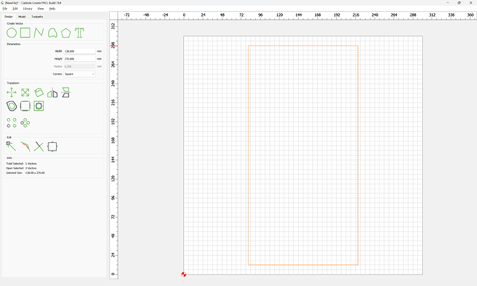

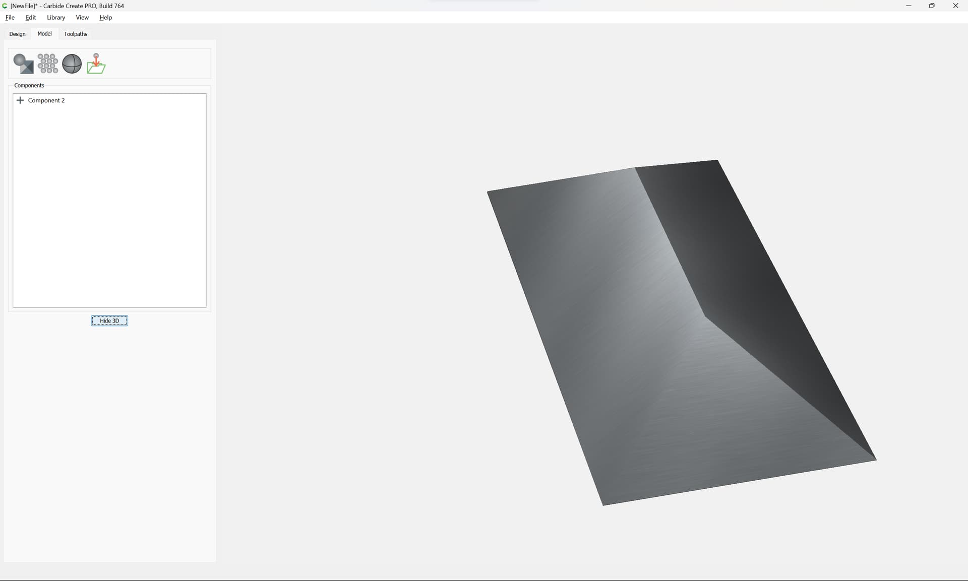

To do this using 3D shape components you have to create geometry larger than expected:
Use that to model the angle:
Then either restore or cut away what is not wanted:
It’s not obvious what is happening in those screenshots without a deep understanding of what the 3D shape properties do. I get the general idea that you are making an oversized, additive wedge shape and somehow stacking a flat surface component. But even if I fully understood this, it feels unscientific compared to parametric modeling I’m used to from 3D printing. For example if I wanted a 27 degree angle, I’d have to do some mental gymnastics to figure that out. For this project I think I will just cut the wedge in X/Y space and glue it in during the finishing process.

The hardest/weirdest thing for me to grasp was that the 3D in CC Pro is not a geometric model, but a gradient bitmap / height map. And the tools were just geometric parameters to create the bitmap.
The next epiphany would be the vector you select for 3D toolpaths is just a boundary, and it cuts any/all 3D geometry within that boundary. So you can model what Will shows above, but only cut a portion of it.
You don’t have dimensions, so I’ll guess overall 3x3x6. I’ll start with a 12x12 workpiece knowing I need some extra space for the 3D model, and I still want to zero at the lower left corner of my actual stock.
Draw the pocket for the part with vertical walls
This is the actual box

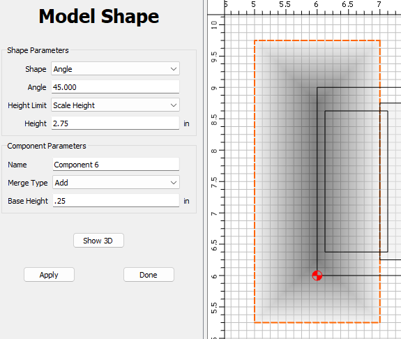

Draw the rectangle to build your pyramid / model. I also added another rectangle to make a ledge to prevent the 3D toolpath from falling through the back of the box.
Model the pyramid. The angle doesn’t matter since it’s scaled. 2.75 is the 3" height minus the 1/4" back. The 0.25 base height starts the taper 1/4" above the table.
Make the ledge 0.25 high, and use the Merge Type: Equal. This will prevent the modeler from adding the edges that coincide.

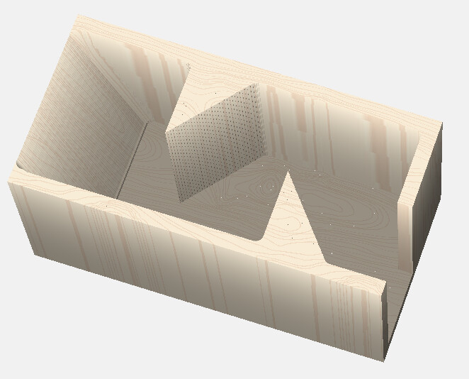

Now design the 3D toolpath boundary. 1/8" offset from the inside wall of the box. 3D paths drive the tool ON the boundary, leaving the radius of the tool outside the boundary.
Mill out your main pocket
Rough & finish the angled surface using the boundary
I created a bogus toolpath outside to mill away the extra workpiece stock that really isn’t going to be there…
Leaving…

I think my biggest gripe with this system (coming from parametric modeling of geometric shapes) and hardest thing for me to understand is the lack of control over that face angle. From what I understand, you pretty much have to the angle and length of the hypotenuse manually based on the height of the cut and the scale of the grayscale image. And if you want a scoop (fillet-like) shape instead of a linear angle, you don’t have very precise control of the radius in Z space like you do in X/Y space.
I will experiment with this, thank you for taking the time to create such detailed instructions for my specific problem!
Agree. And it’s not really made to do precise angles, radii, etc… But you can get close.
Best bet is to draw it up in a side view & transfer the dimensions, or do the math.
