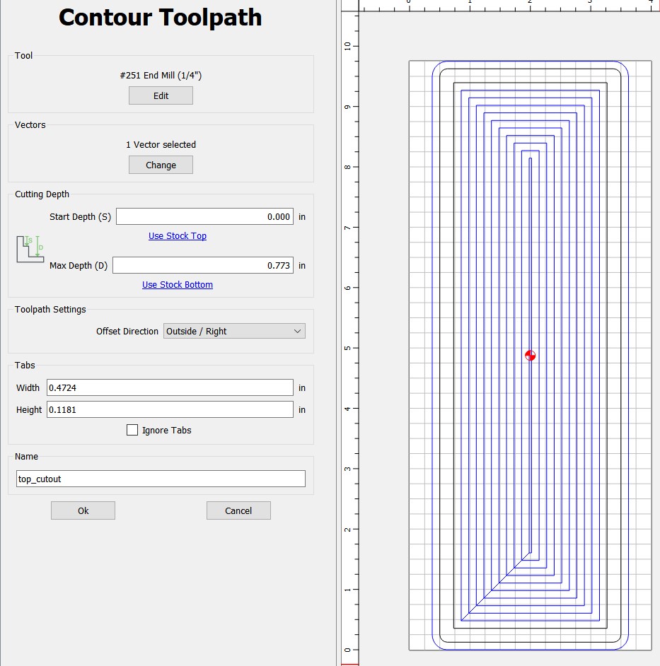

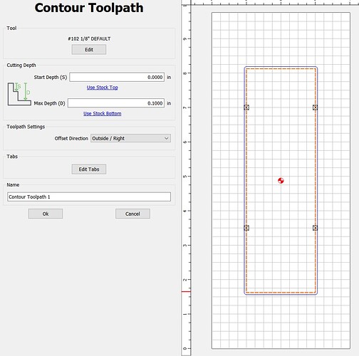

I have updated to 710 and on 708 I had a problem figuring out how to add tabs. I see the place to put your measurements for the tabs but I cannot get tabs to appear while clicking on the tool path. In V6 CC you went in to the “Edit Tabs” and placed your tabs. See picture below
V6 652 CC
In the new V7 version 710 and in 708 I cant figure out how to place tabs. There is a place for the measurements of your tabs but cannot get tabs to appear. How do you get tabs on the project?
Additionally what does “Ignore Tabs” do?
V7 710 CC

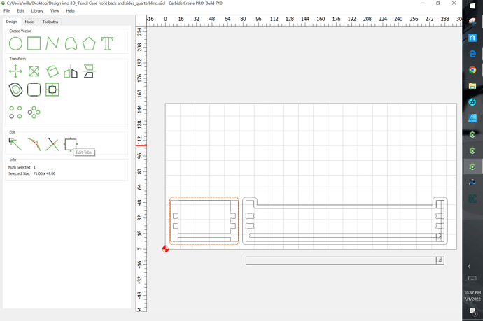

Tabs are now set in the Design pane:
Thanks Will, knew there were hiding somewhere.
One additional question. The tool path lets you set your tab width and height. I usually do not use the default ones C3d sets. So if I forget to change the default sizes are the edits made in the tool path after tabs are added and they change or do you have to remove the tabs in the size you do not want and go back to the tool path and set what size you want and go back to design and add the tabs in the size you want.
@gdon_2003 Guy - It looks like the position of the tabs is a design element, but the size of the tabs belong to the toolpath. So it looks to me like you have to adjust them in the toolpath. Seems like that’s the only place.
That’s an interesting point…couldn’t the size of your tab (the length, not so much the depth) impact the design layout in certain circumstances?
@GJM 's observations match my understanding:
  • tab position is set in the design pane
  • tab sizing is associated w/ a toolpath
  • tabs are generated/instantiated when one generates a 3D preview/G-code

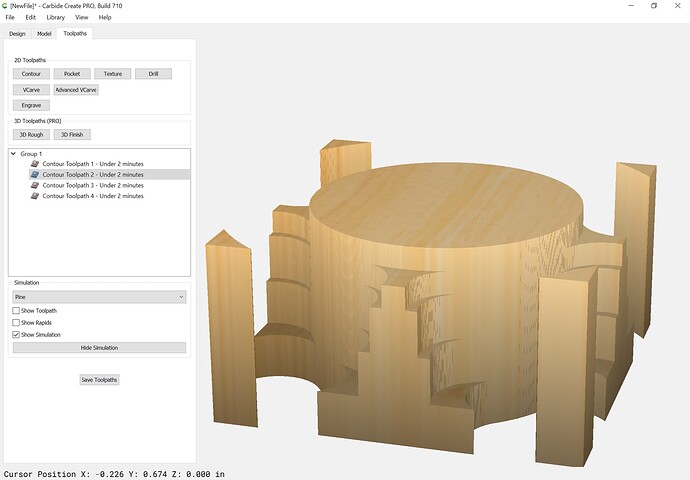

For example, one can do:
w/ a single circle, w/ 4 tabs, and 4 toolpaths which have different tab definitions.
