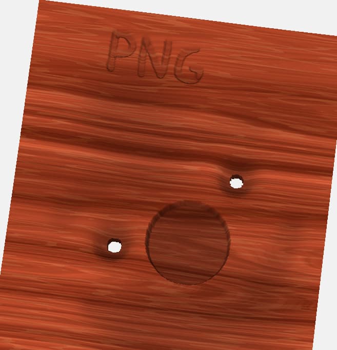

This issue is unrelated to STL’s. It seems solely due to trying to make the high point of a png lower than the substrate surface.

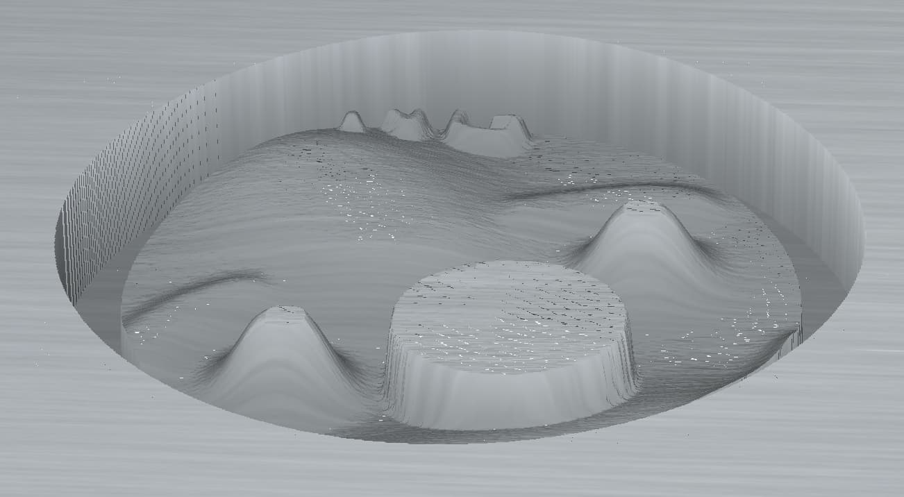

Here’s the simulation with Base Height 0 mm:

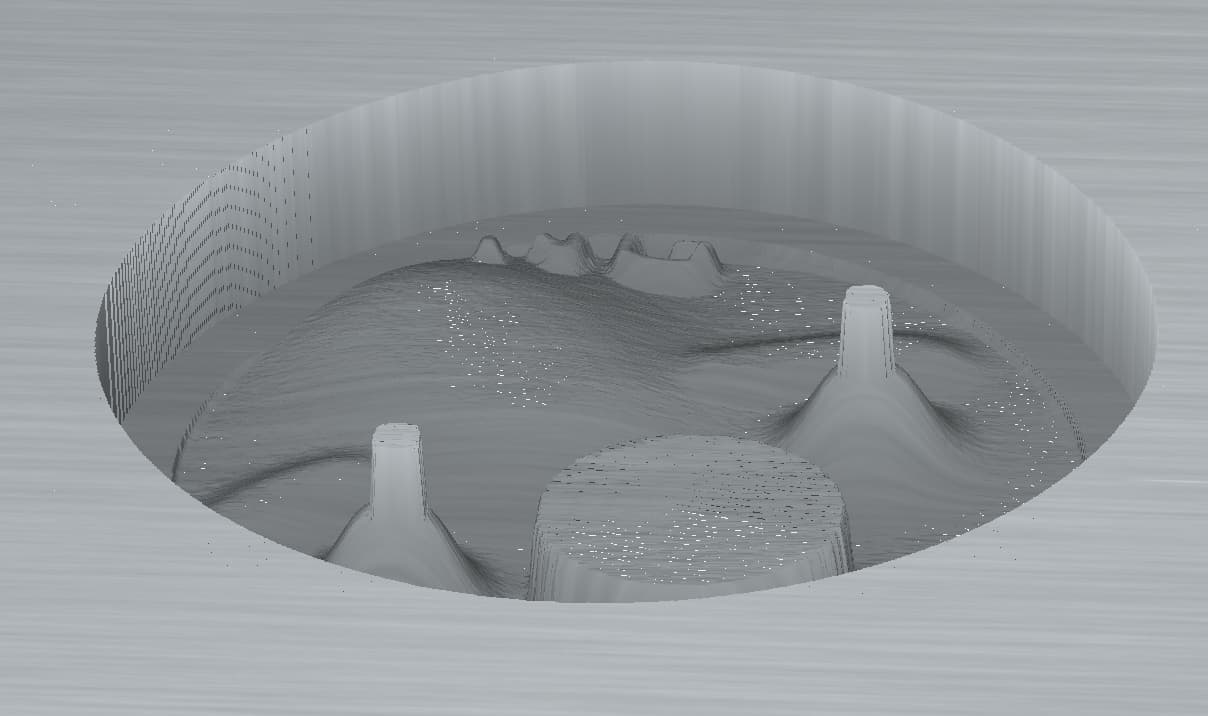

Here’s the Base Height set to 2.0 mm:

This does not seem dependent on an area having 100% black but will occur at the darkest region in the rendered space.
I have not placed the tabs, oooops:o. It seemed that the earlier version automatically did this. How do I place the tab?
If you turn off the base component & add the “png 2mm base ht”, you can see that zero values don’t get modeled. They are just a hole. So you are subtracting a hole plus the 2mm base with a hole.

Oops, apologies. It appears that Include Ambient Area also applies to png’s as well as STL’s. And it works! Still learning the 3D aspects.
Again though, curious what this affects png and not jpg.
Not sure how that applies. As mentioned the issue occurs where the png is darkest, it doesn’t need to be 100% black in the png, which I guess is zero value.
