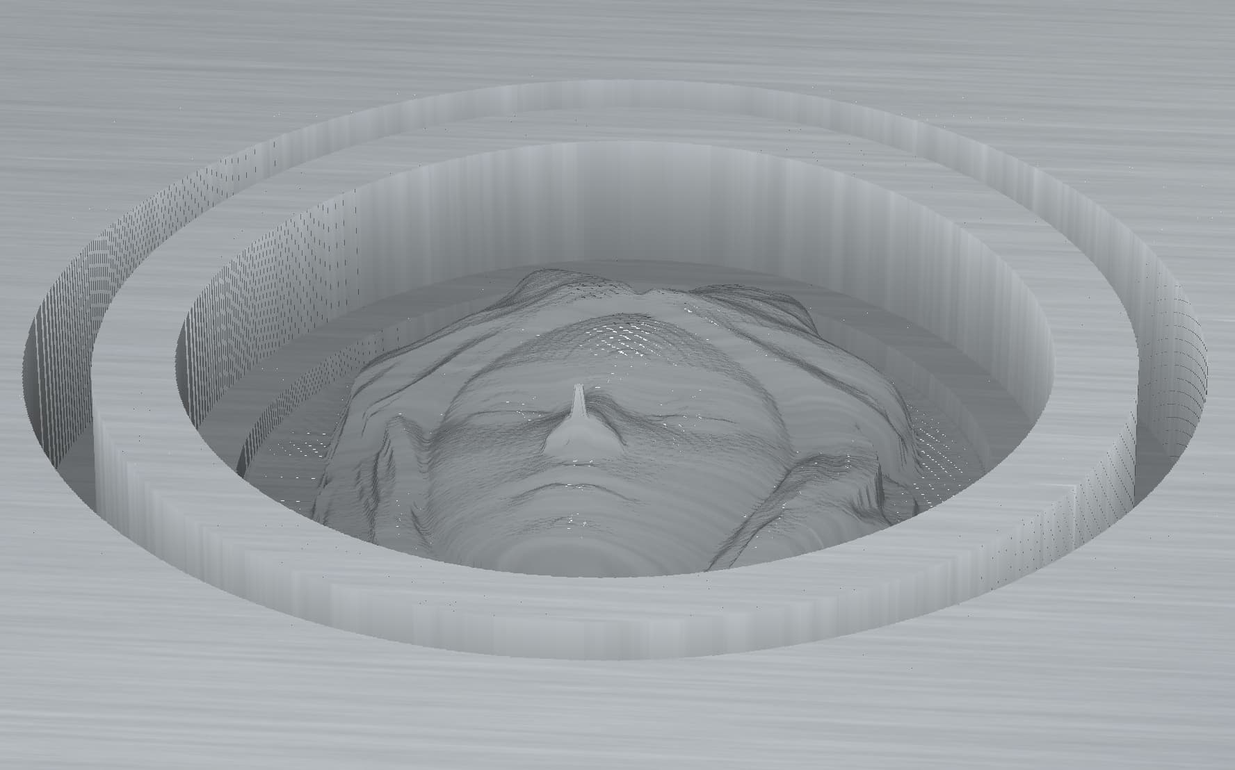

I’m making a cameo from a height map, the bust is set in a recess:
In the Model pane I have a flat ModelShape equal to thickness of the substrate, 8.0 mm. The heightmap element is subtracted from that. The perimeter of the recess is a Contour cut equal to the depth of the heightmap element. All is fine so far.
But I want to lower the carving a bit so that after it is inlaid I can safely sand the outside perimeter without doing a nose job. It seems plausible to do this is by lowering the Base Height of the heightmap. Here I’ve exaggerated the amount to show the issue:
I’m still getting my “sea legs” with 3D, it’s a new thrill every day. File enclosed, any ideas? BTW, this doesn’t seem to happen when I use the STL on which this was based.

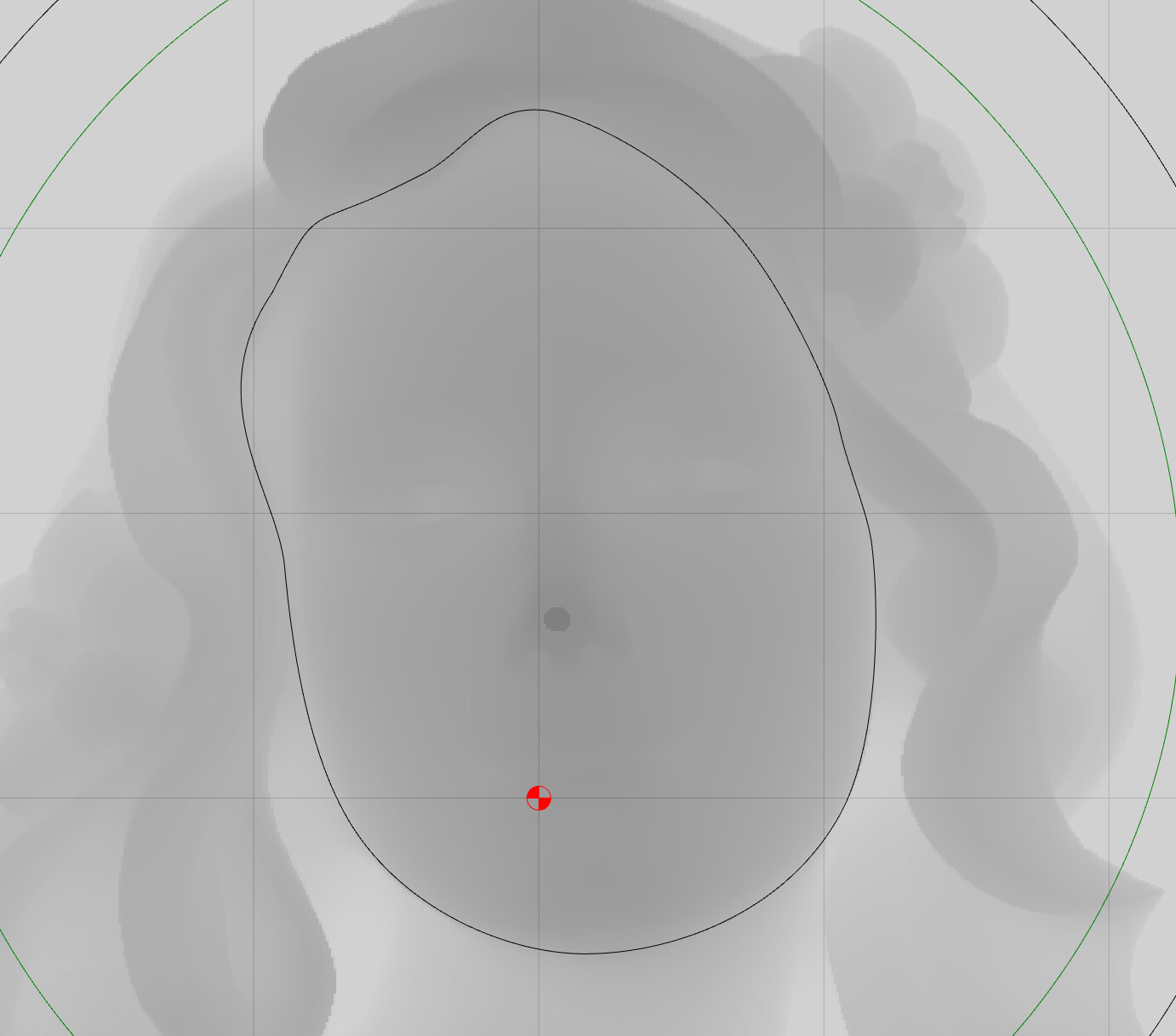

I suspect this is a difficulty in how the 3D model is stored.
That dark nose circle in the heightmap only shows in CC when I make the Base Height non-zero. The heightmap was created in CC by exporting it as a png. It was modified in Affinity Photo, that aberration didn’t appear there either. It’s unclear to me how this, if somehow a function of the stl, could have been retained in hidden form in a png.

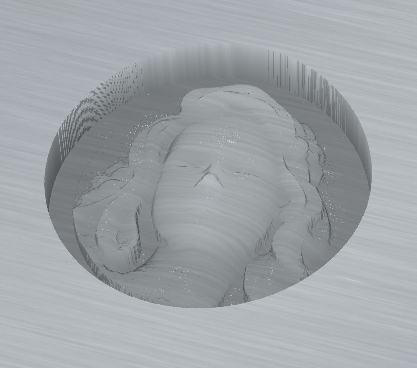

After further testing: I opened the png in AffinityPhoto and exported as a jpg, the problem went away. I re-opened the jpg in AP and exported as a png. The issue returned.

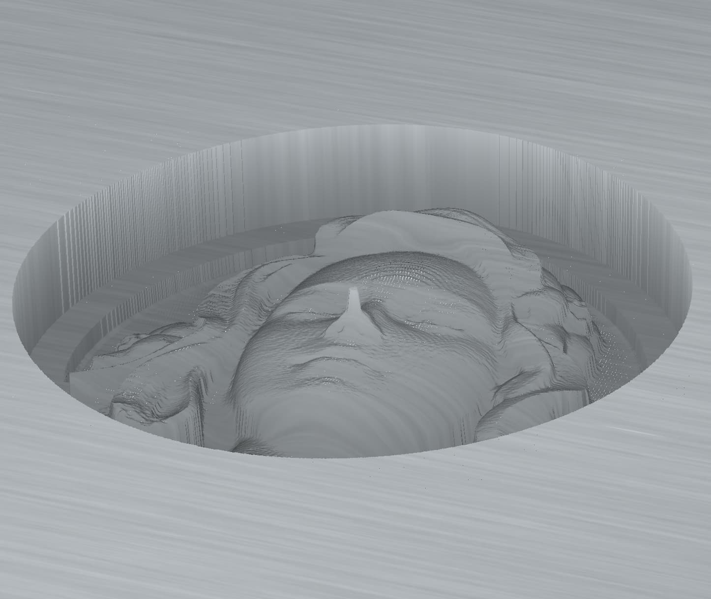

I then tried another png heightmap from another figure:
I repositioned the model, also cut out the nose so another spot was the darkest in the heightmap. In both cases the spike was emanating from the darkest region in the heightmap.
Am I possibly the first to try a carve, with a png, where the highest point is below the top of the substrate? Or is there something unorthodox in my approach?
EDIT: I painted a new file in AP, from scratch, saved as a png. Same result.
It appears, at least using my workflow (I know no other), that CC automatically forces the darkest part of a png to the top surface by creating an artifact at that position. That area does not need to be 100% black for this to happen.
