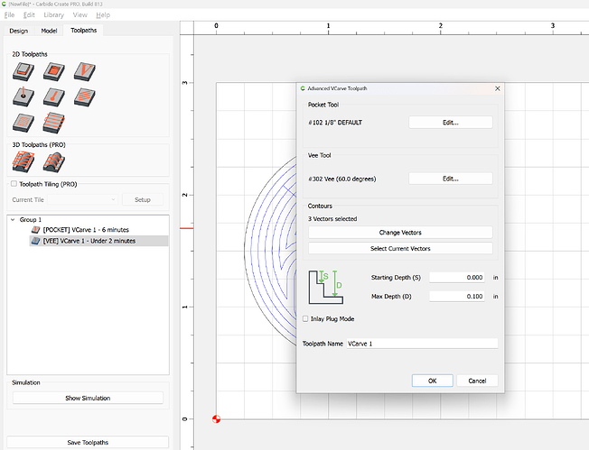

After using the V8 Beta for awhile now. Im liking it very much. BUT still have to issue of the if I try a Vcarve. It doesn’t break it up into 2 files like a inlay plug does. Will or can this be remedied. I have tried to write the code to send it home after the initial pocket cut but can’t seem to locate the correct spot in the code line to do so . Any Ideas? Thanks in advance
Upload a file where the V carving doesn’t split into two toolpaths which may be output separately in v8?
When I do a Vcare inlay it keeps the pocket file and the VCarve as one file. As when I do a Plug inlay it keeps each file separate if that makes sense. I don’t own a machine made for Carveco create. I built my own. So Its got this little glitch It wont return to home or start X,Y,Z, Zero after the pocket clearing. it lift up a little then stops. Im unable to swap the bits. I thought I figured out how to fix this issue. I still might have But Im would consider myself still a learner when it comes to the code tampering, changing. Adding Ect. I figured out if I remove the M05 code from the G-code I can keep it from shutting off my machine. So I figured I try and find the spot where it stops and input a command to send it back home for a bit change. Not sure this is making sense. But got to try. Thanks

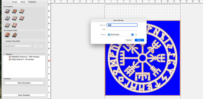

If I do Plug mode I get two files:
and two toolpaths when I disable that:
Upload your file and a screengrab showing no second toolpath?
I threw something together quickly to show its no longer splitting the files into separates. Or Im missing something Is probably what it is.
I tried uploading the code but it to large. heres a link

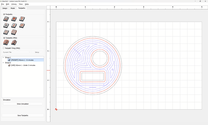

In order to get two separate G-code files, you will probably want to move the separated toolpaths into two separate groups:
and then disable one or the other before writing out G-code:
Ya that seemed to work But I swear when I first downloaded V8 Beta it automatically did the file split into separates. In Fact I know it did. because I was like VERY COOL. But if I have to do it this way then so be it Thanks for the help
It did not. We’ve never generated multiple files automatically.
Ok Then if was a fluke in my putter or else Im going craze LOL But anyways thanks for the help its working again
