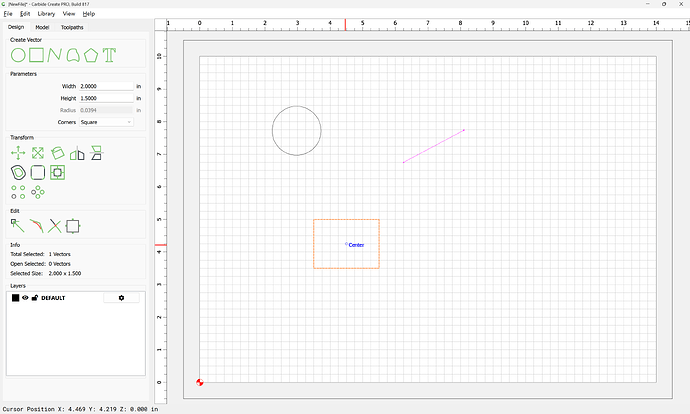

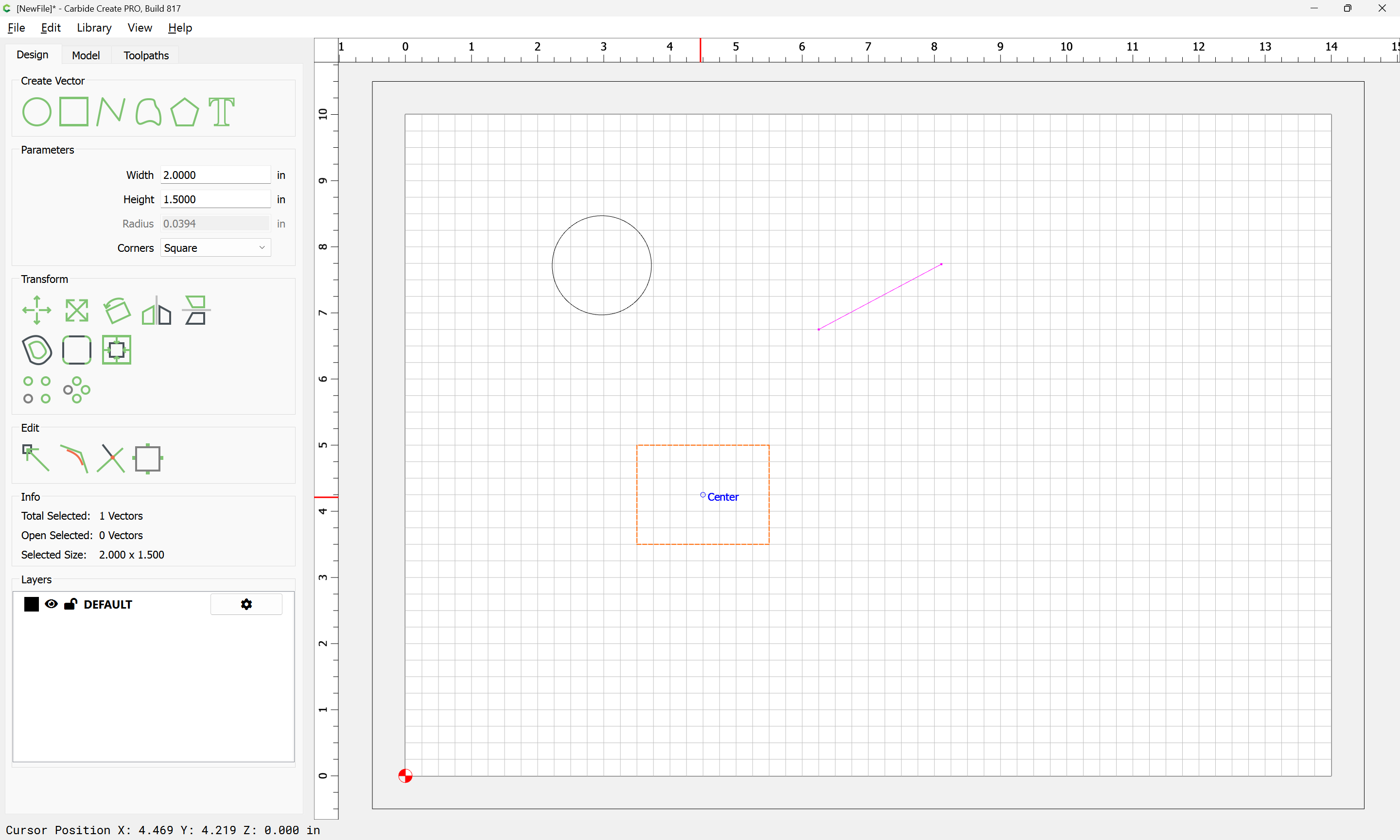

OK, first thing I notice is I can’t move a circle.
I created a circle with the center on a grid point. I want to move it using the center point.
When I click on the center point the circle becomes de-selected.
It wants to focus on the grid point rather than the center.
If I toggle off Snap to Grid, it highlights the center point, but de-selects on click.
It seems to be all of the drag from center drags which are broken:

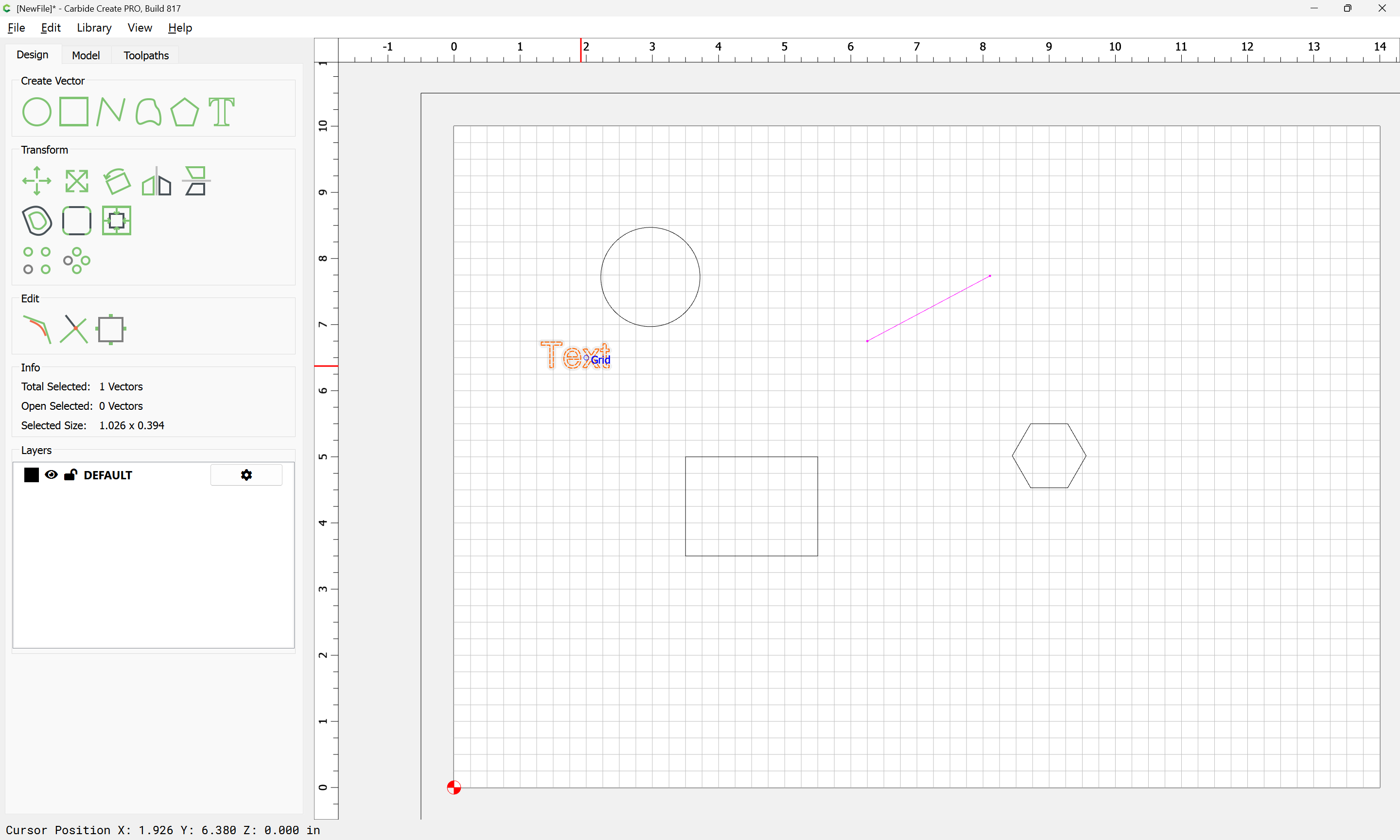

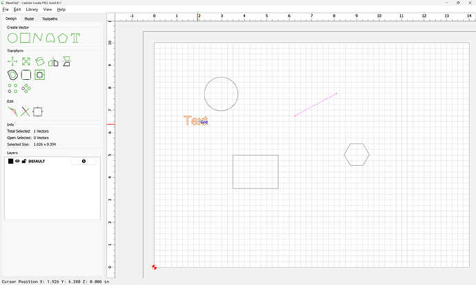

It’s also difficult to bring up a Baseline on a text object:
FYI: You CAN grab the middle of a circle if you activate the MOVE tool:

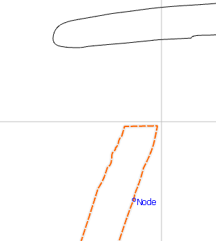

Within the Node Edit mode, right-clicking a node does not bring up a functions menu - so there’s no way to cut/add/delete a node via mouse. Keyboard commands still seem to work.
Would be nice if the node Join command could be within the Node Edit right-click functions menu.
That was in the original post; right-click context menus didn’t make it into the first release. It’s done, so context menus will be in the next release.
