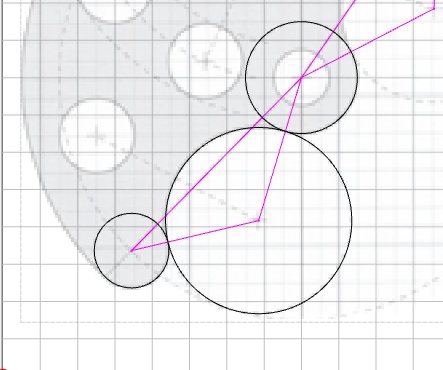

Try to trim & join the 3 circles. You first need to move the large circle to be as nearly perfectly tangent with the other 2 circles. I moved the other geometry out of the way…

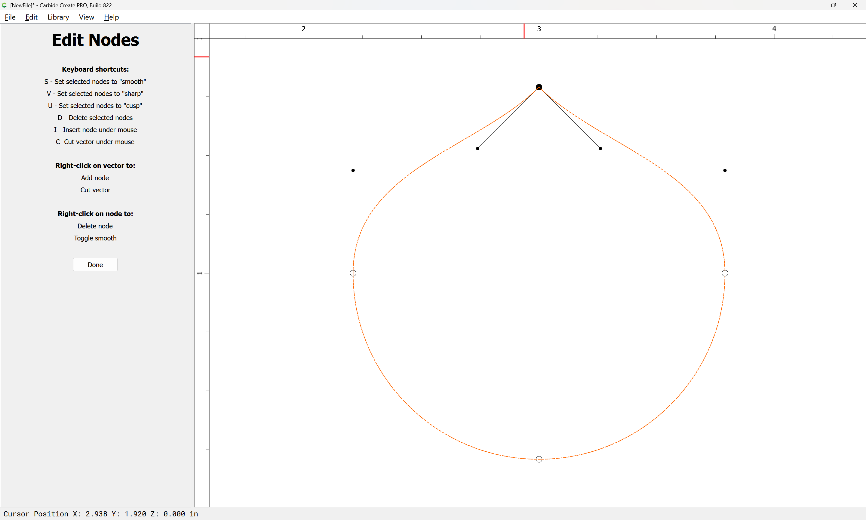

  • (FIX) Lots of rework on node type when node editing, including changes to the shortcuts.
  • (NEW) Added explicit “cusp” type for nodes.

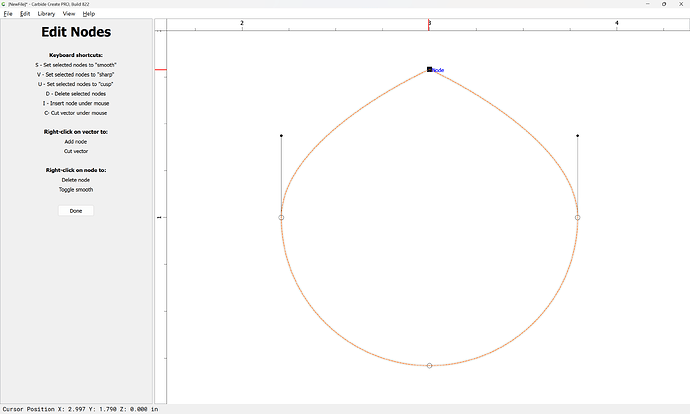

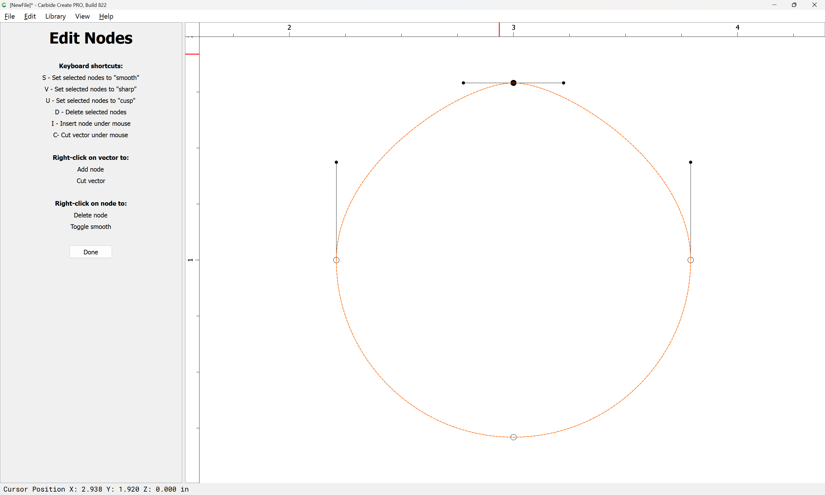

What is the definition of “cusp”?

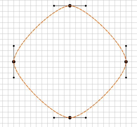

What determines the magnitude of curvature (the length of the arrow) when smoothing a node?
I would expect if you made a square & then ‘smoothed’ it, it would become a circle. ??
Can the layer panel be made accessible in the model & toolpath views?

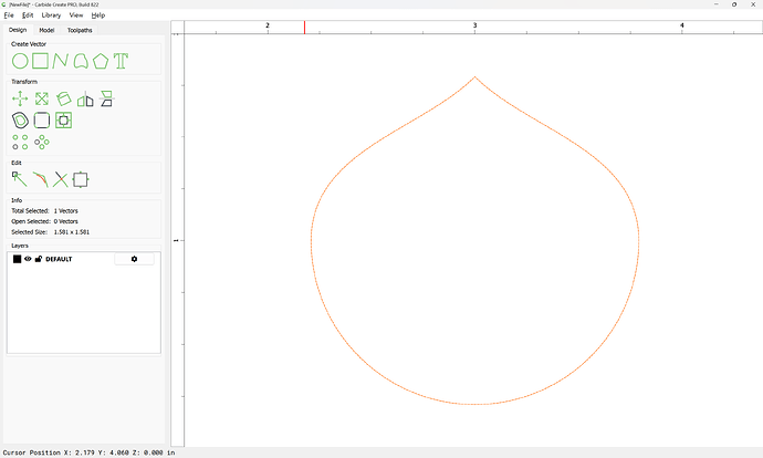

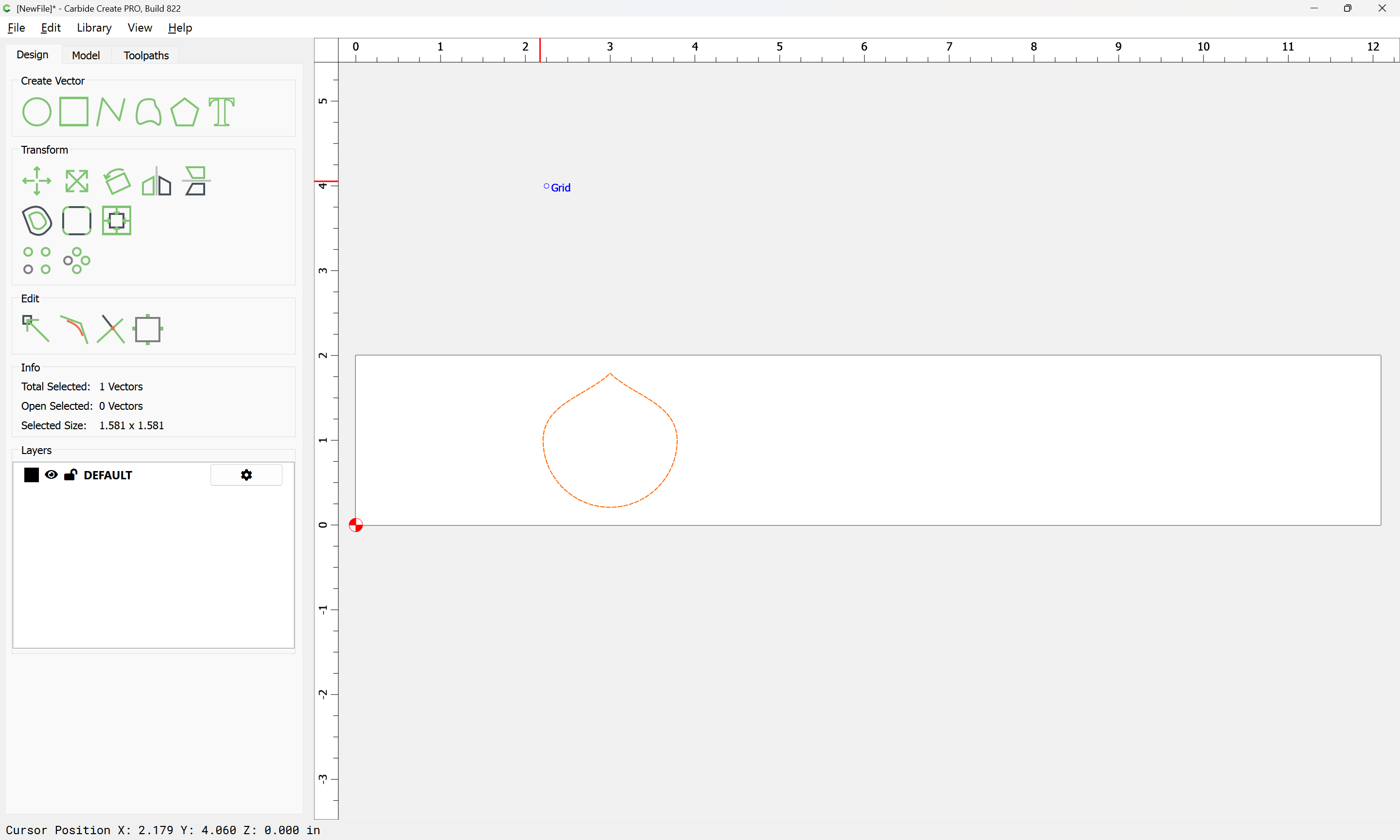

I created a line & added 2 nodes between the ends. If I delete the first node, it deletes the other end (the 2nd or End node)
I tried one with only one node added, and it reduced it to a (almost) point. These would be really hard to find!

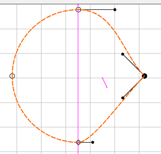

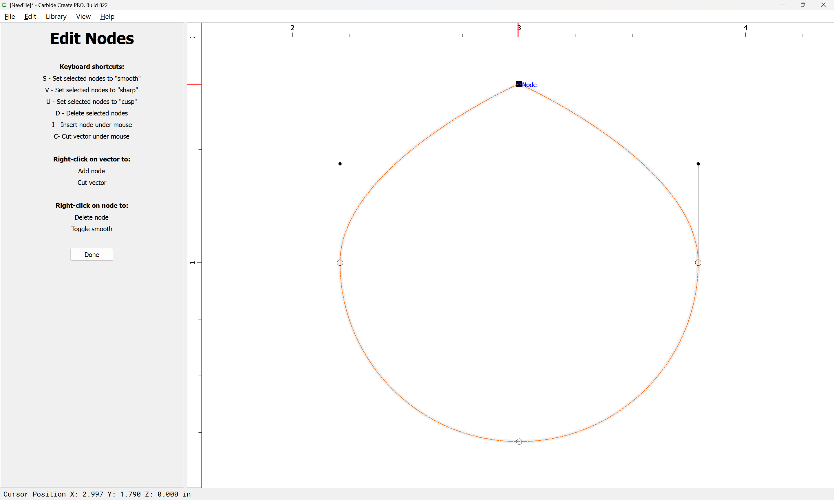

When drawing with a Bézier curve, there are several possible relationships between the on-curve node and the two associated off-curve nodes.
Freya Holmér did a wonderful video:
which examines some of the underlying math and has this definition/image:
where:
  • Broken == Cusp
  • Aligned is not specifically supported in Carbide Create, but can be drawn (usually by aligning to a grid) or imported
  • Mirrored == Smooth
There is also the case of:
  • Sharp
which is where the off-curve nodes are retracted/coincident w/ the associated on-curve node.
This seems to be hard-coded — cycling through the options in Carbide Create we get:
  • Smooth
  • Cusp
in addition to the Sharp node setting shown above.

Thanks for catching that. After thinking on it and experimenting with it a bit, my take on it is since the singleton node no longer exists after exiting Node Editing (and usually if the penultimate node is deleted the last one goes as well), that’s a workable trade-off for allowing the user the ability to delete nodes as they wish.

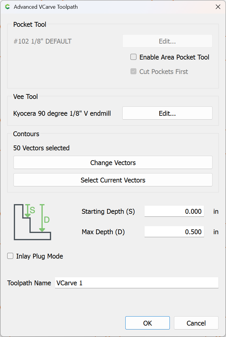

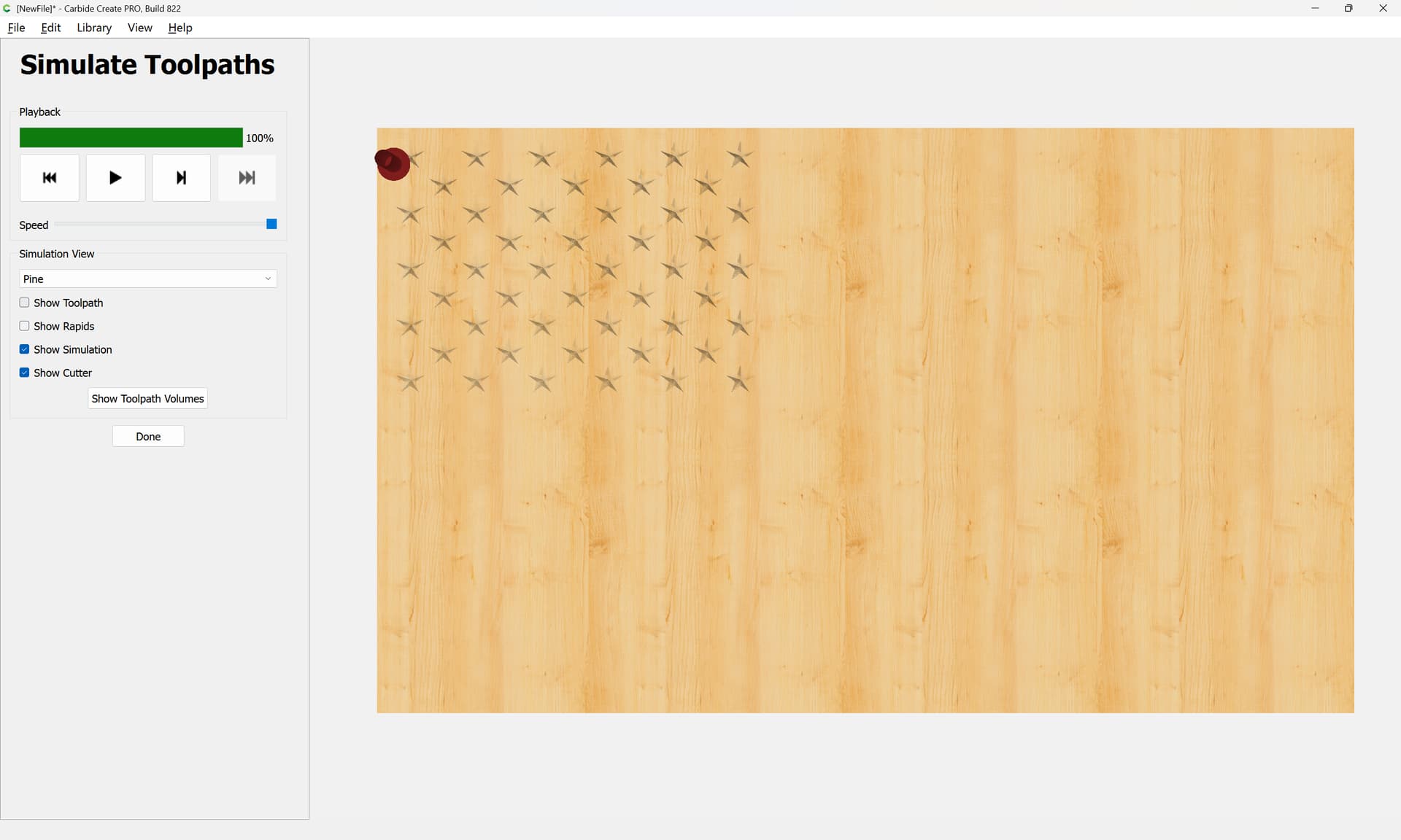

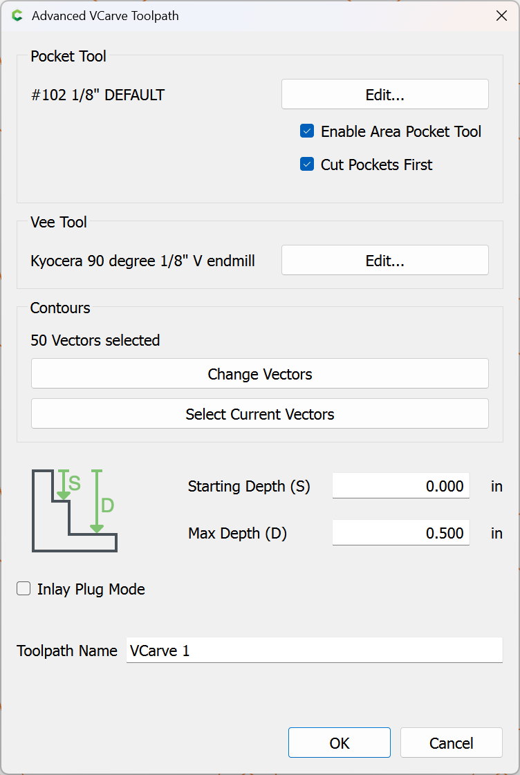

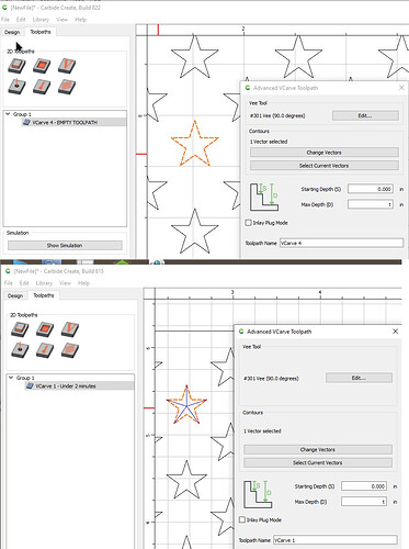

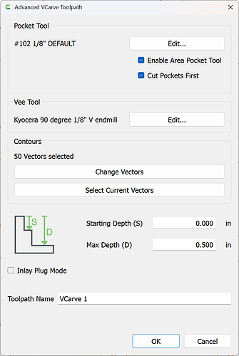

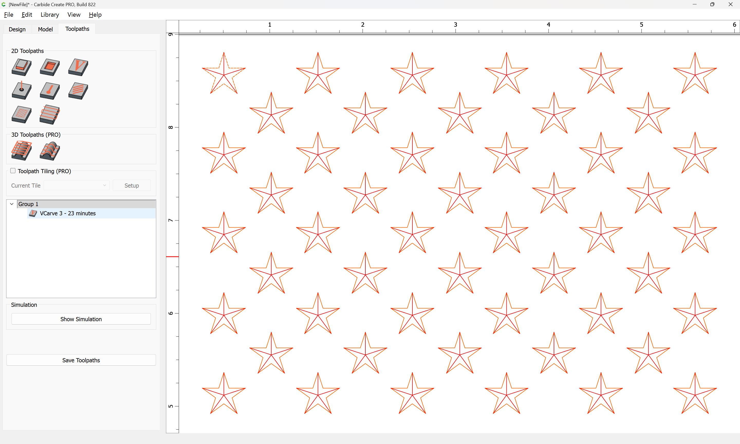

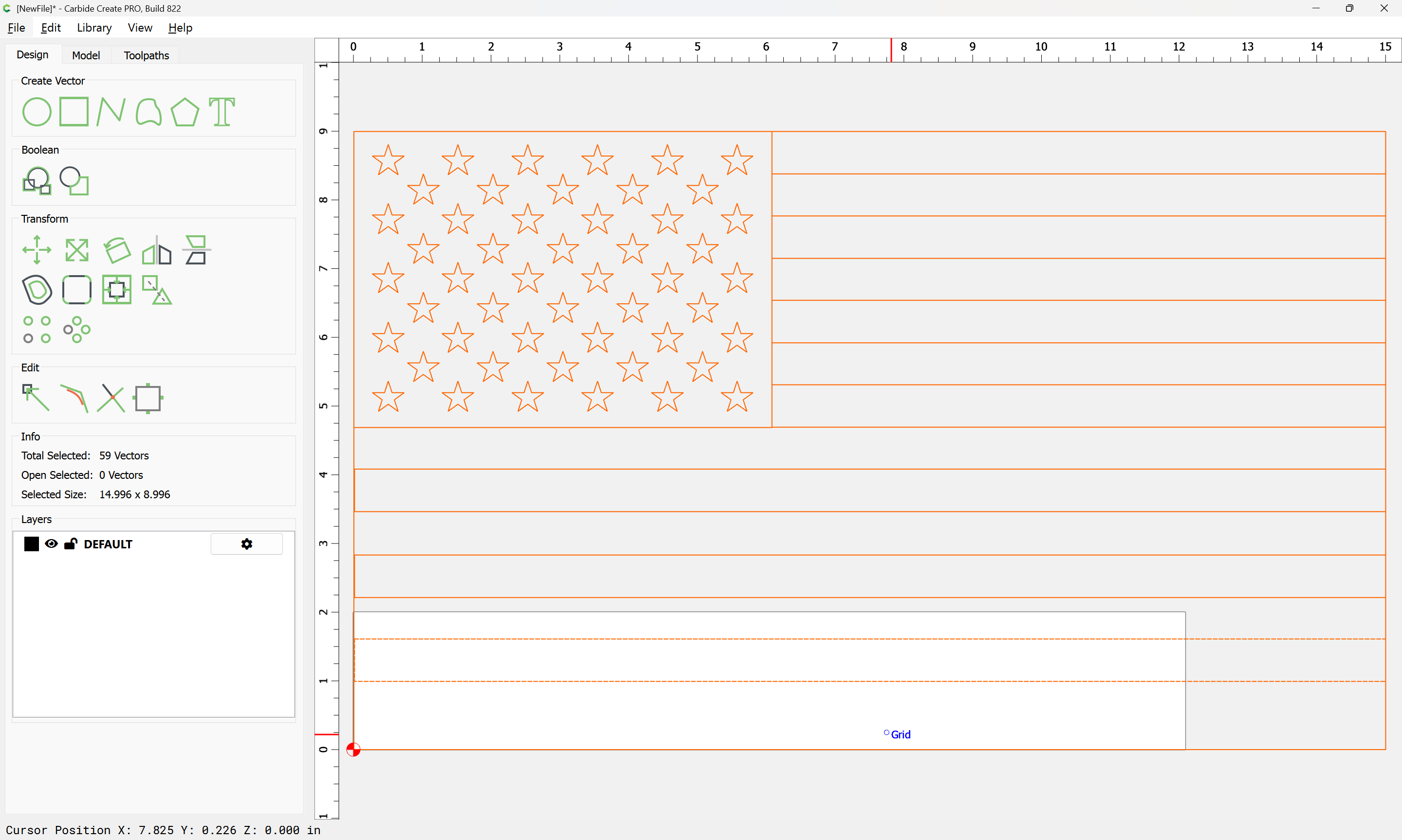

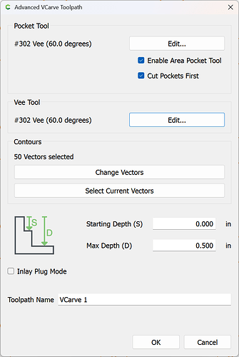

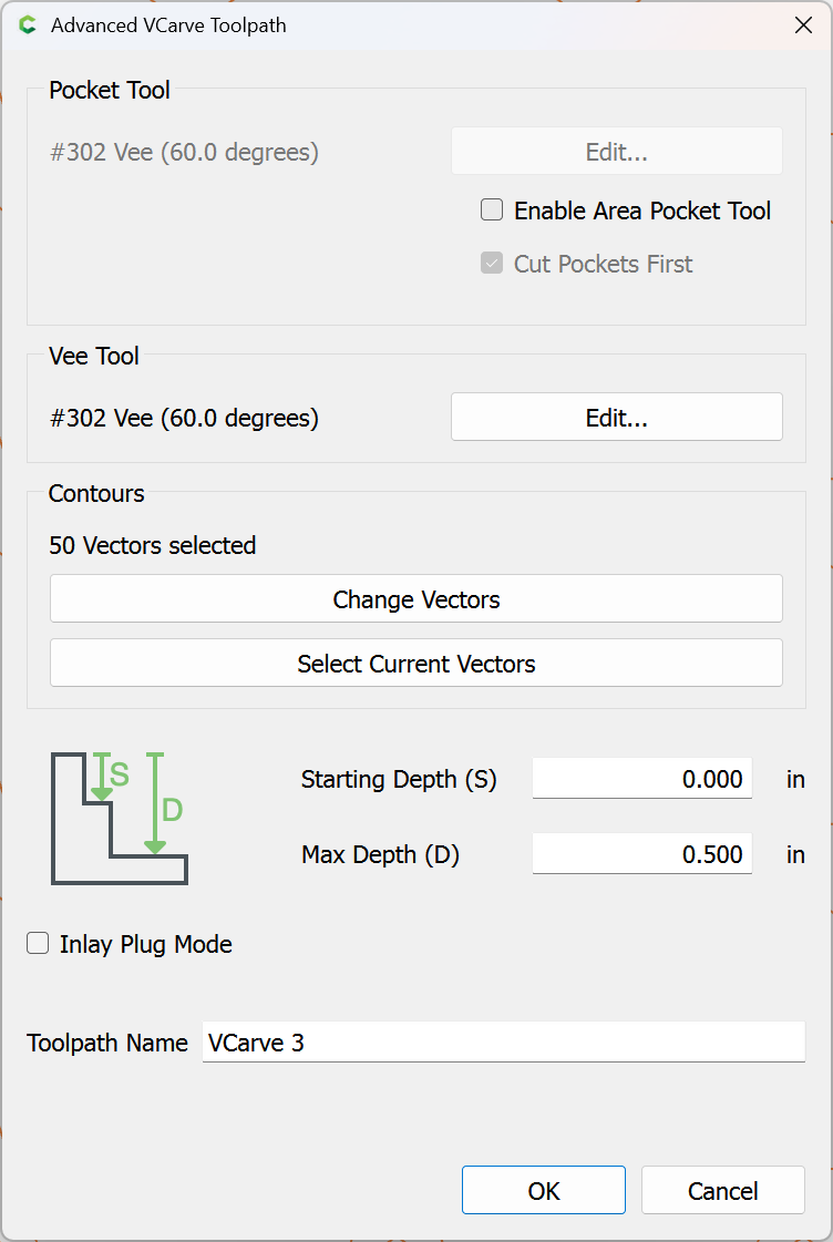

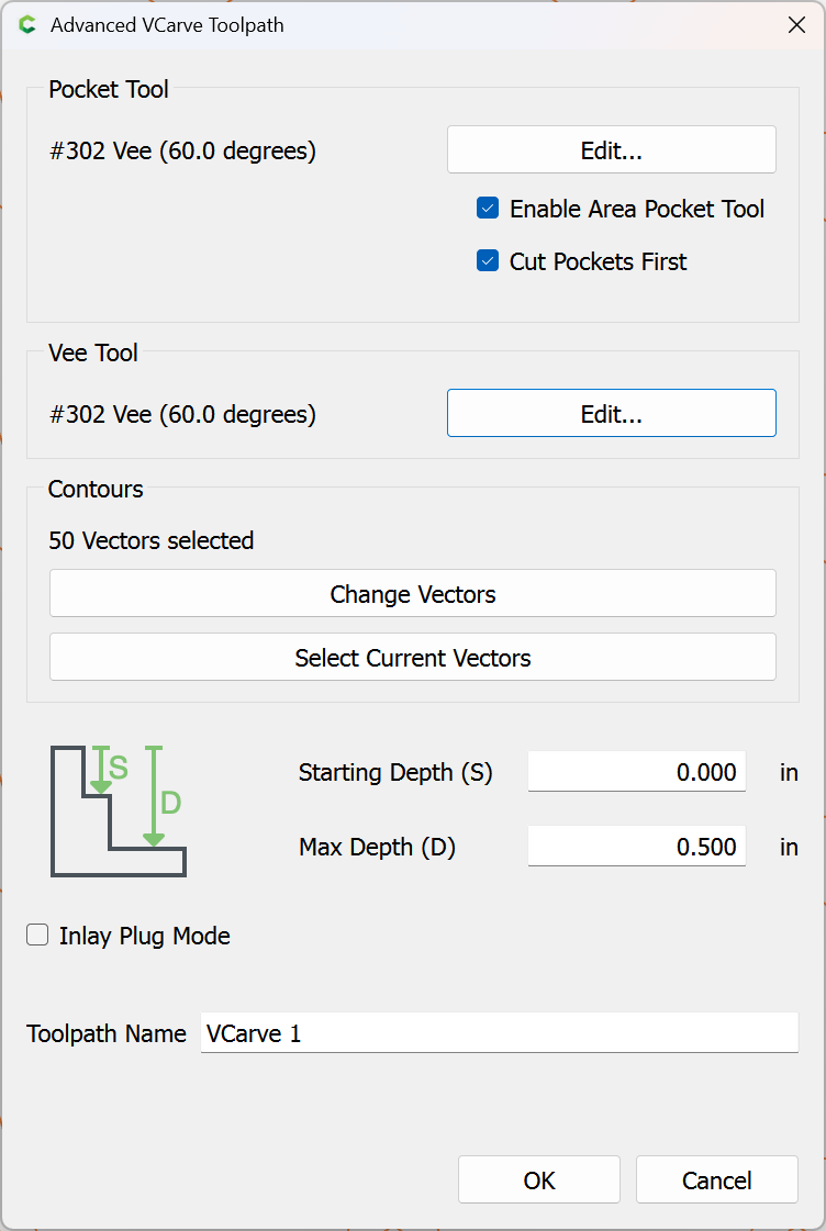

In 815: Load US flag from library, stock set to .5" thick, create vcarve, it works as expected. In 822 same process results in Empty Toolpath even after waiting a full minute and hovering over the toolpath repeatedly. Also, when hovering, it says the tool is a 1/8 in both versions even though the pocket tool is not enabled.

OK, it appears the “cusp” condition points the curvature vectors at the next node
I was asking what direction & magnitude the vectors would point with that condition.
The magnitude seems to be similar to the smooth magnitude.

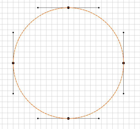

I don’t think so. If I try it with a very large circle or a very tiny circle, the results are the same.
If you make a circle & examine the vectors, they appear to extend about 0.55 * R
If you then change the nodes to smooth, they appear about 0.3 * R
The vectors appear to be too short on any curve to truly “smooth” it. ??
OIC, the length of the off-curve nodes is proportional to some aspect of the size of the curve.
I still think if you go down small enough at some point there will be a (tiny/unusable) size where one gets something close to a circle — but no need for that, since one has a perfectly good tool for making circles (well, approximations of them).

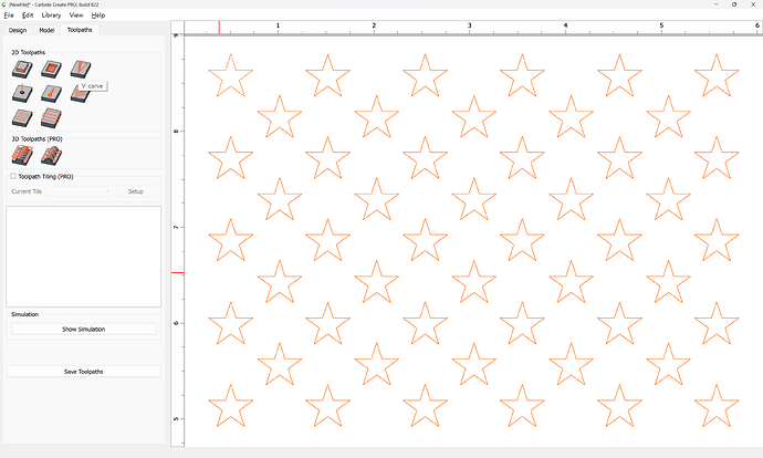

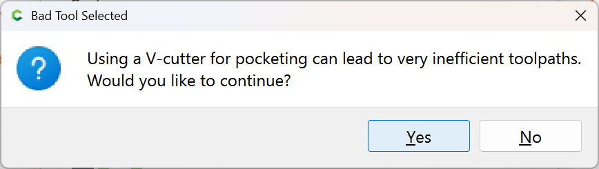

Okay, import the file:
Select the stars:
and assign a V carving toolpath:
check the box for “Enable Area Pocket Tool”:
Edit the associated tool, selecting the same V tool which will be used for V carving:
Yes
clear the checkbox for “Enable Area Pocket Tool”:
OK
R = 0.001, same results
The problem isn’t really with circles since we can make those easily.
The circle just illustrates the issue better.

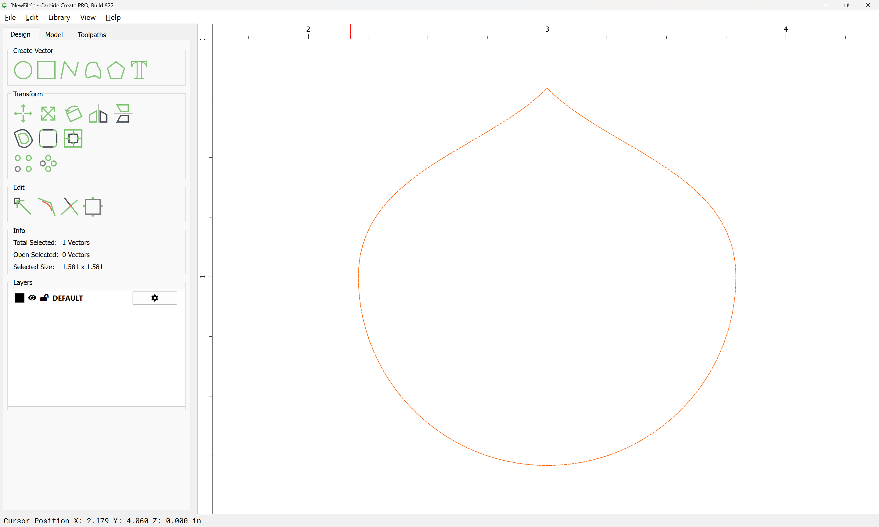

The problem is with bezier/nurb type curves, often imported with erratic spacing
I’ve had several examples where I want to delete some of the nodes, then smooth the remaining nodes.
Before & after smoothing… i.e. what I would expect vs what I get
“Smooth” simply describes the type of node, not the actual effect.
It might be that it would be appropriate for the generated nodes to be further apart (perhaps following the “Rule of 30” where off-curve nodes are ~30 percent of the way towards the next on-curve node), but I view this as a default which gets the nodes created and makes it obvious to the user that they have the option of dragging them to the position appropriate to the desired appearance.
