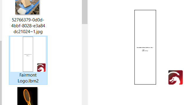

While you’re working on print and print preview…if you could get that image into the icon for the file, it would be fantastic! Like they do in Lightburn:
This would greatly help selection of the right file when you have many in a directory.
Thanks!
