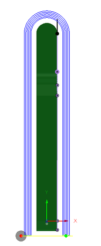

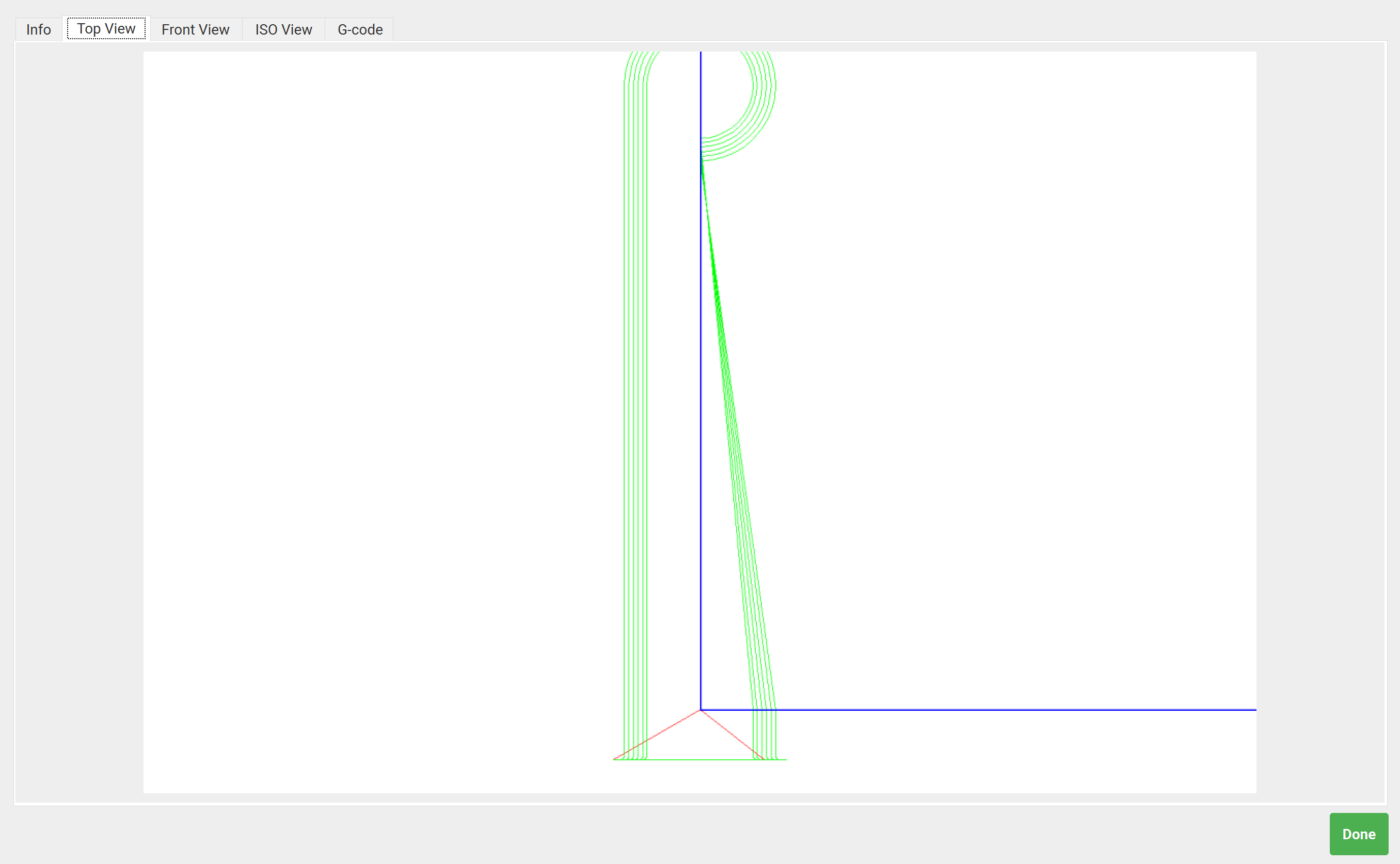

Today I loaded a file that came out incorrect in the preview, it came out like this.
While it should look like this.
The part came out as it should, only the preview is incorrect.
MDI is working fine now.
Knagg_Contour_Job2.nc (6.3 KB)
Thanks for the file, we got it fixed in 563 at https://carbide3d.com/carbidemotion/beta/
