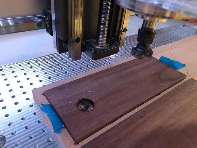

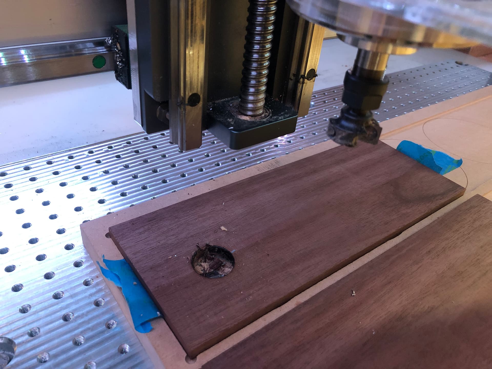

So you’re saying I would have been able to save Marty’s life had I left the comfort of Build 537 and seen in the 3D preview of the Beta that my z-zero was supposed to be stock top?
Oof… RIP Marty.
