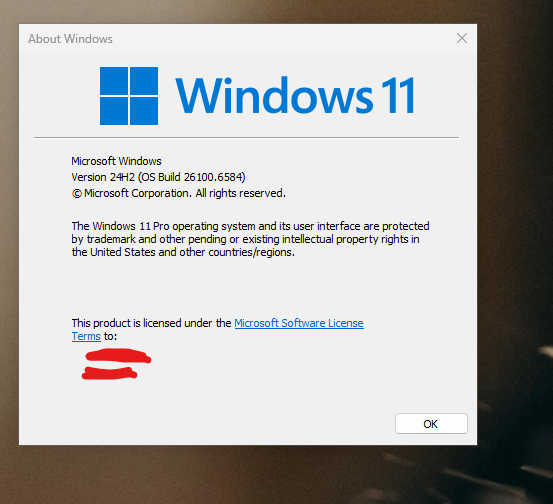

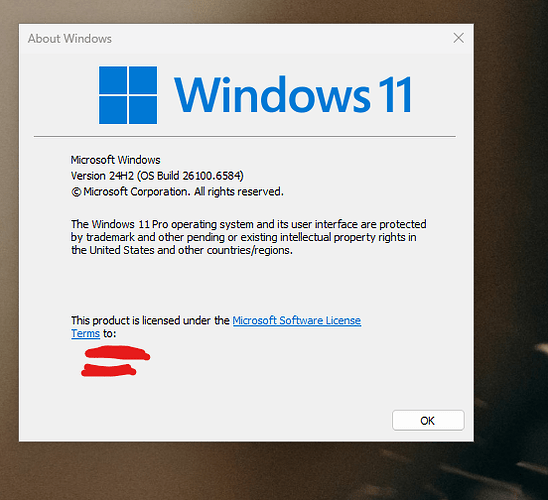

My controlling PC is a Lenovo ThinkCentre, Core i5-45xx, 8GB RAM, Win11 Pro (fully updated).

It looks like you’re running Windows 10, not 11. That shouldn’t matter, but that’s what the crash report says.
According to the crash report, the crash is happening deep within the Qt library we use for the GUI. That’s pretty strange. You might try to update the graphics drivers to make sure there’s nothing wrong there, and make sure you’re not running any other invasive software, like third-party virus scanners, etc.

Running a iGPU driver now to see if that makes any difference. Thanks for the suggestion. :slight_smile:
The system is a clean install, just for running this machine. There’s basically nothing on it except C. Motion, C. Create, and Google Chrome. I also put gSender on it last night, but I haven’t even run that yet, and these issues existed before I installed that. The only AV on the system is Windows Defender.
No, filenames shouldn’t matter, but it was the one thing I could think of to check.
Cool. Yeah, I tried a couple different files, and even different types (gcode and whatever it is CC generates) and it behaves the same.
The iGPU update fixed it. Weird!
