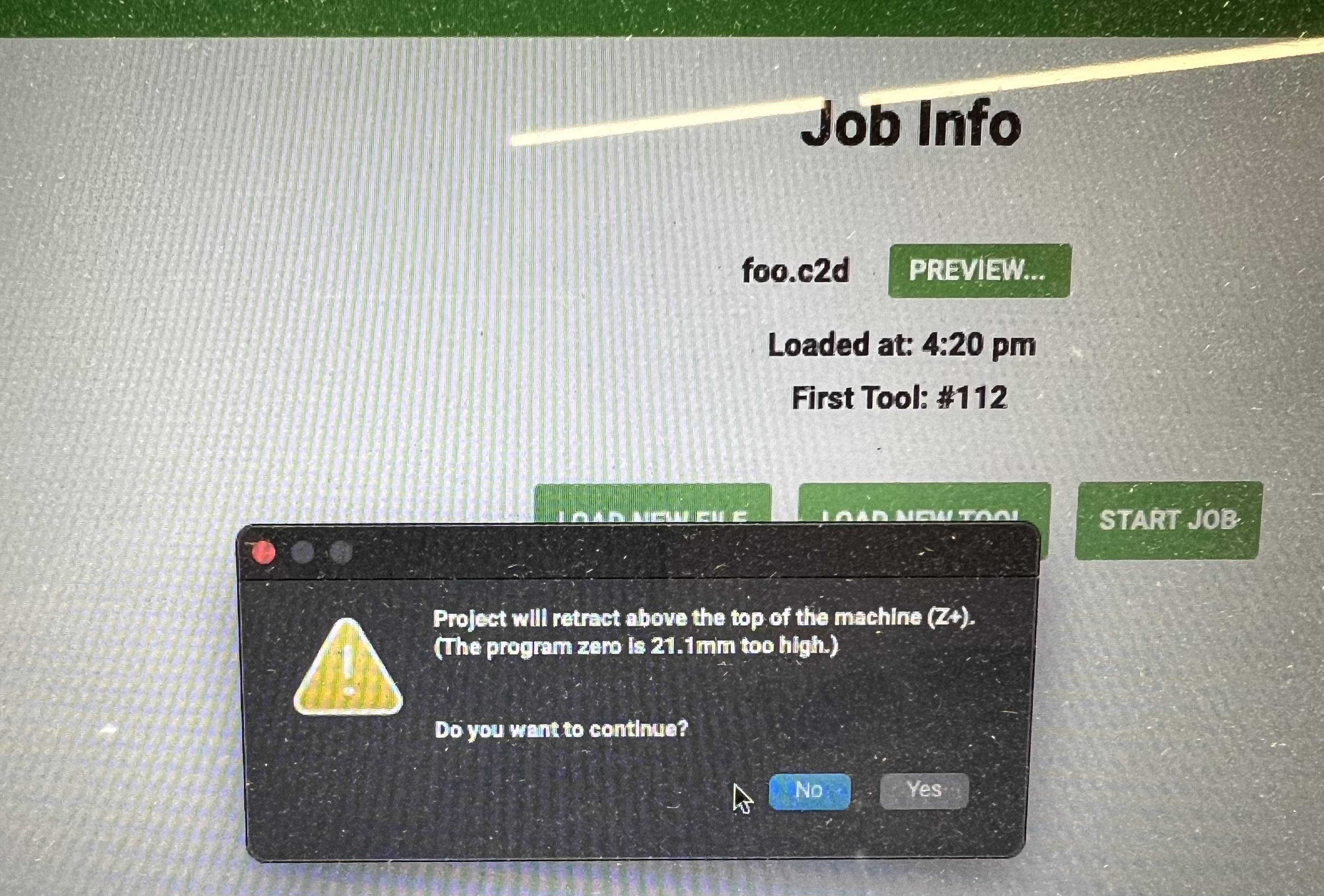

I was using it all day today, it worked, except one time as I started to run a new file, I got this error message:
Pretty sure there was nothing in the file and I didn’t do anything to cause this. A restart of CM fixed it.
Where are you setting origin in the file?
What is the Safety/Retract Height set to?
Where are you setting zero relative to the machine structure?
See:
