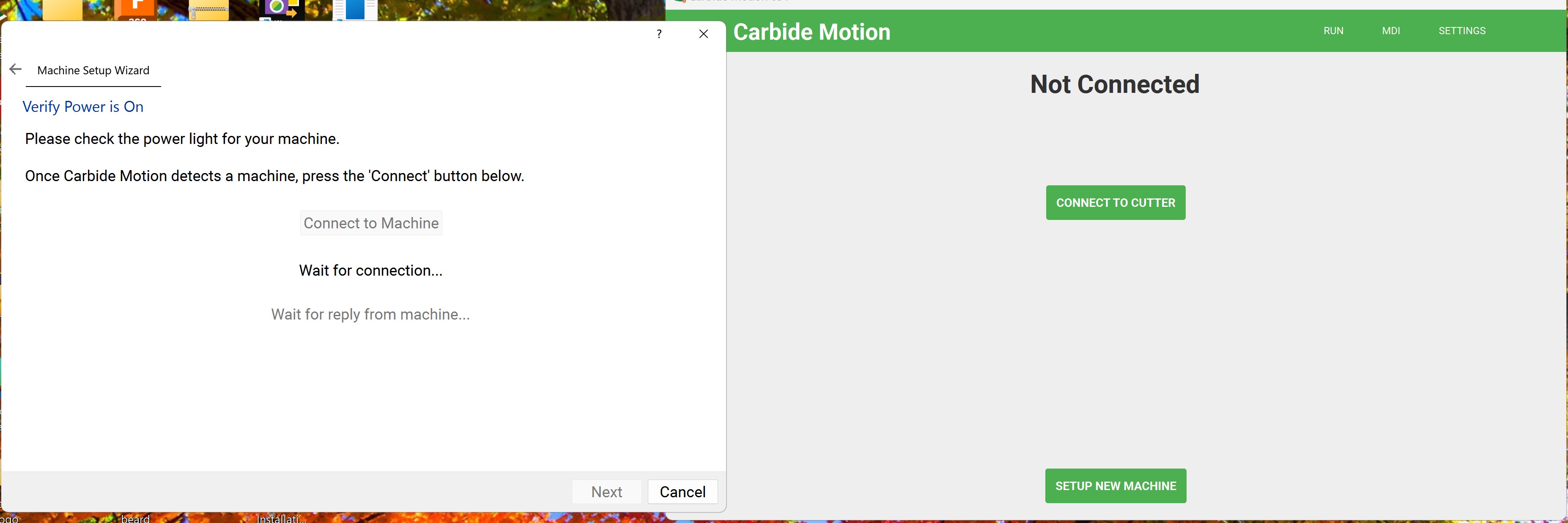

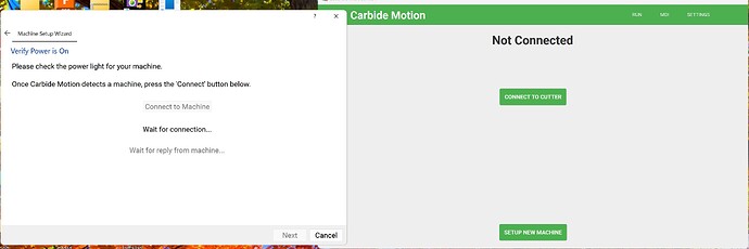

Motion wont let me click on settings while the setup wizard is open, wizard just keeps going from connect to machine, to waiting for connection and back to connect to machine

Still not able to get the beta to connect to my machine, anything else I can try?
The only thing that comes to mind is to restart the computer and run only the beta build to make sure the port isn’t locked up by another program.
Tried above and still the same, wizard is also running extremely slow for some reason.
