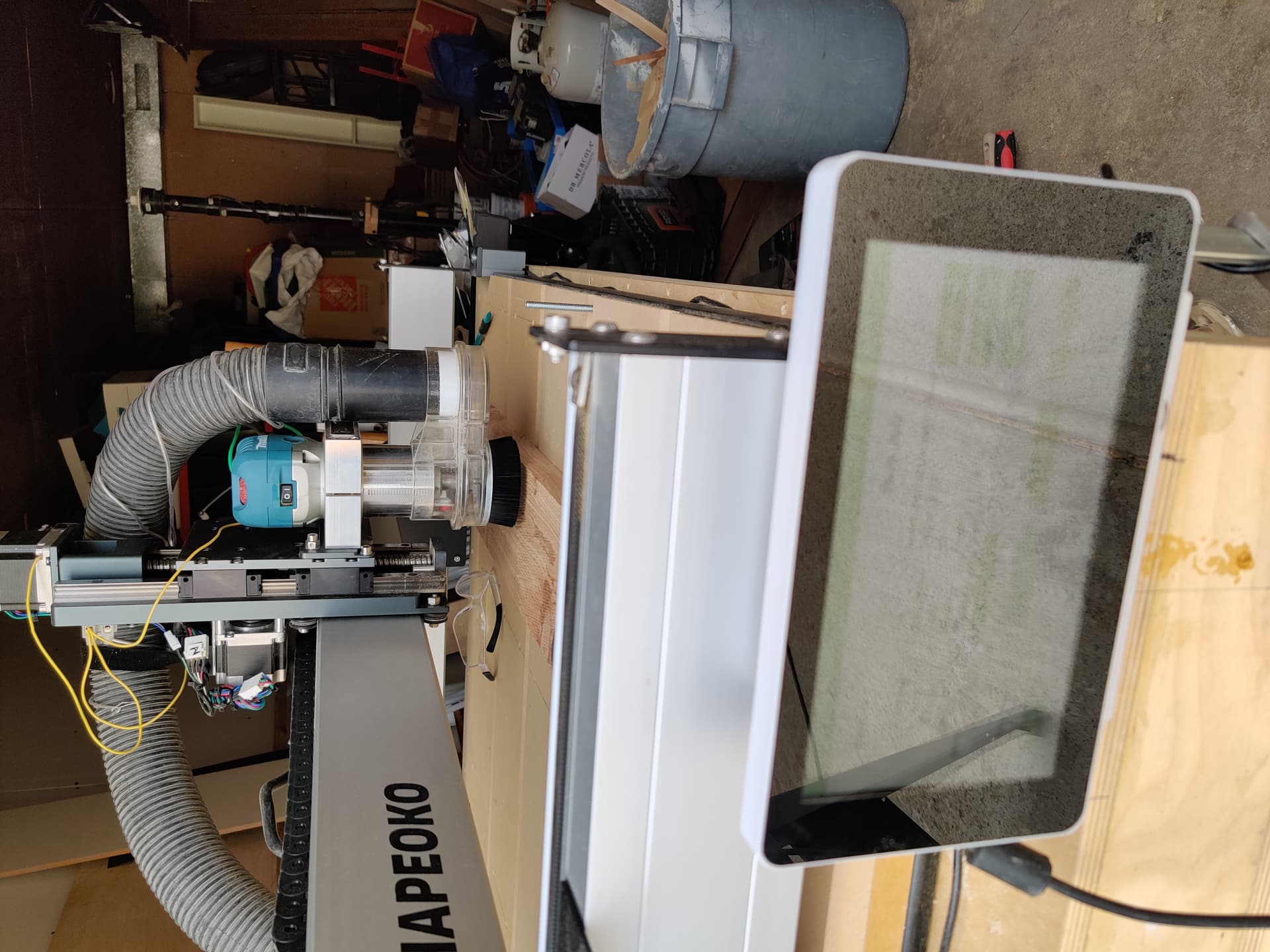

So I finally had the time this summer to do some upgrading to my 3XXL & just finished setting up a Rpi4 4GB with a 7" screen & case.
Just ran its first job… Which seemed to be working fine for the most part… Until I noticed that the progress screen froze up just before 80% of the job was done.
The CNC program still ran to what appeared to be almost the end of the job before the spindle just stopped above the work piece. I’m not sure if that’s due to buffering between the Rpi & Shapeoko controller or Carbide Motion just finally fully hung on the Rpi. But could not get Carbide Motion UI to respond at all.
Had anyone else run into this issue? Only potential cause I can see currently might be the screen timeout on my Rpi setup. The screen appears to shut off after a few minutes of no mouse/touch input.
Three things come to mind.
  1. heat - I don’t know where your PI is but in my garage where I have mine setup it is about 110. I have a fan and heat sink on the pi, I have a fan blowing across the arm that has the PI on it and I monitor to make sure the chip is running between 180 and 200 degrees F.
  2. The screen blank should not cause issues, but that does not mean the PI is not going to sleep due to some setting somewhere.
  3. the USB connection between the PI and the Control board became loose or vibrated out.
I had an issue early on with the default power management settings in the rpi. My issue was related to how power management and a rpi with no display behave. Once I disabled the power management, I had no problems with the display plugged in or when I had the display unplugged and was using RealVNC.
