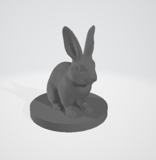

Hi Community,

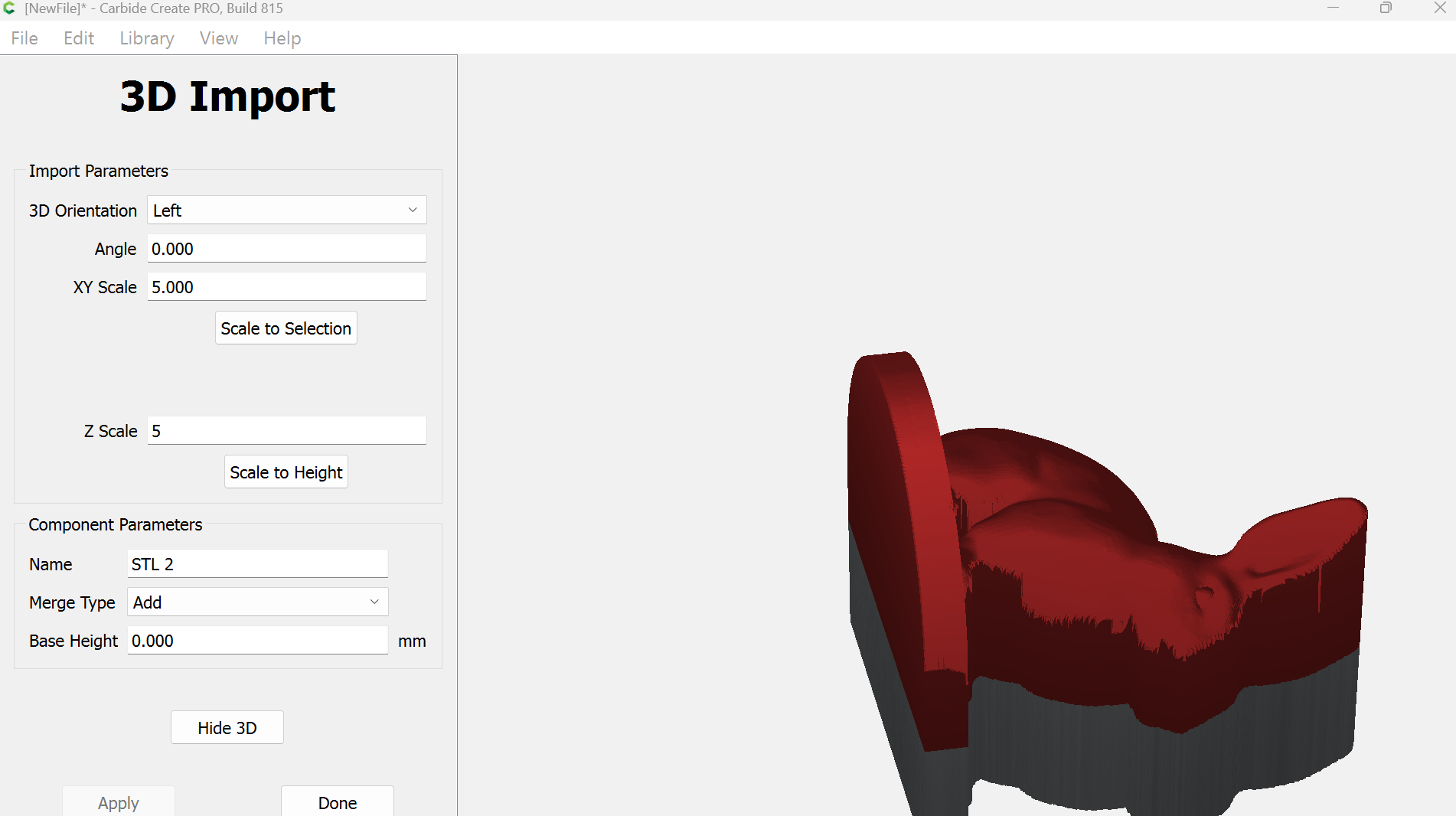

I try to replicate this in carbide pro 8 Build 815 but when i import the stl Carbide extrude my rabbit is like this
I want to create my rabit carve into the wood double side replica my stl.

2
I
want to keep my original shape in Carbide please
WillAdams
(William Adams (Carbide 3D))
3
For such a design, it would be necessary to cut it not just as a two-sided flip job:
but from multiple additional sides:
which would require importing the 3D model in multiple orientations and cutting each in registration after rotation.
I would suggest using a 3D CAM tool such as MeshCAM instead:
