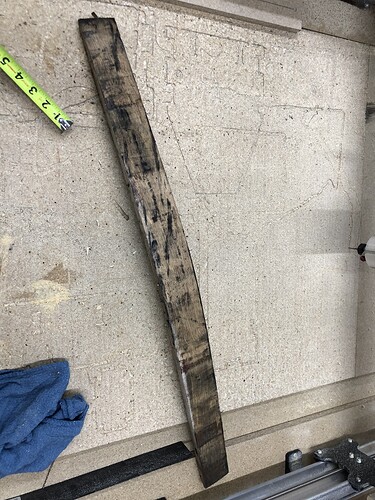

I want to put text on some staves I have been saving. Is it all trial and error or a specific method to go about this? I have plenty and don’t mind messing up a few but would rather succeed sooner rather than later.

Can you measure the staves & provide some pictures?
Here are a few pics, as requested.
They measure at 34” long, 2 5/8” wide at midpoint, tapering to 2 3/8” at end. This varies from stave to stave. 1” thick and the apex of arch is 3” at top surface.

I made the assumption it was a constant curve (arc) through the cross section. It’s more like 2 lines, or 2 very large arcs, with a smaller arc in the middle. I took a guess & made this cross section using your dimensions. This could be refined by taking a few more measurements along the cross section.
