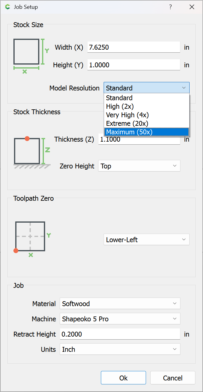

The question is really will CC pro import this size image without size changes.
Once you have a height/depth map, then Carbide Create Pro will import it — note that the current file settings:
allow for quite a lot of pixels in a file — you should be good up to that representation (researching this is left as an exercise for the reader — to determine what it is, make a file and export a PNG) and probably quite a bit higher (though to no good gain).
