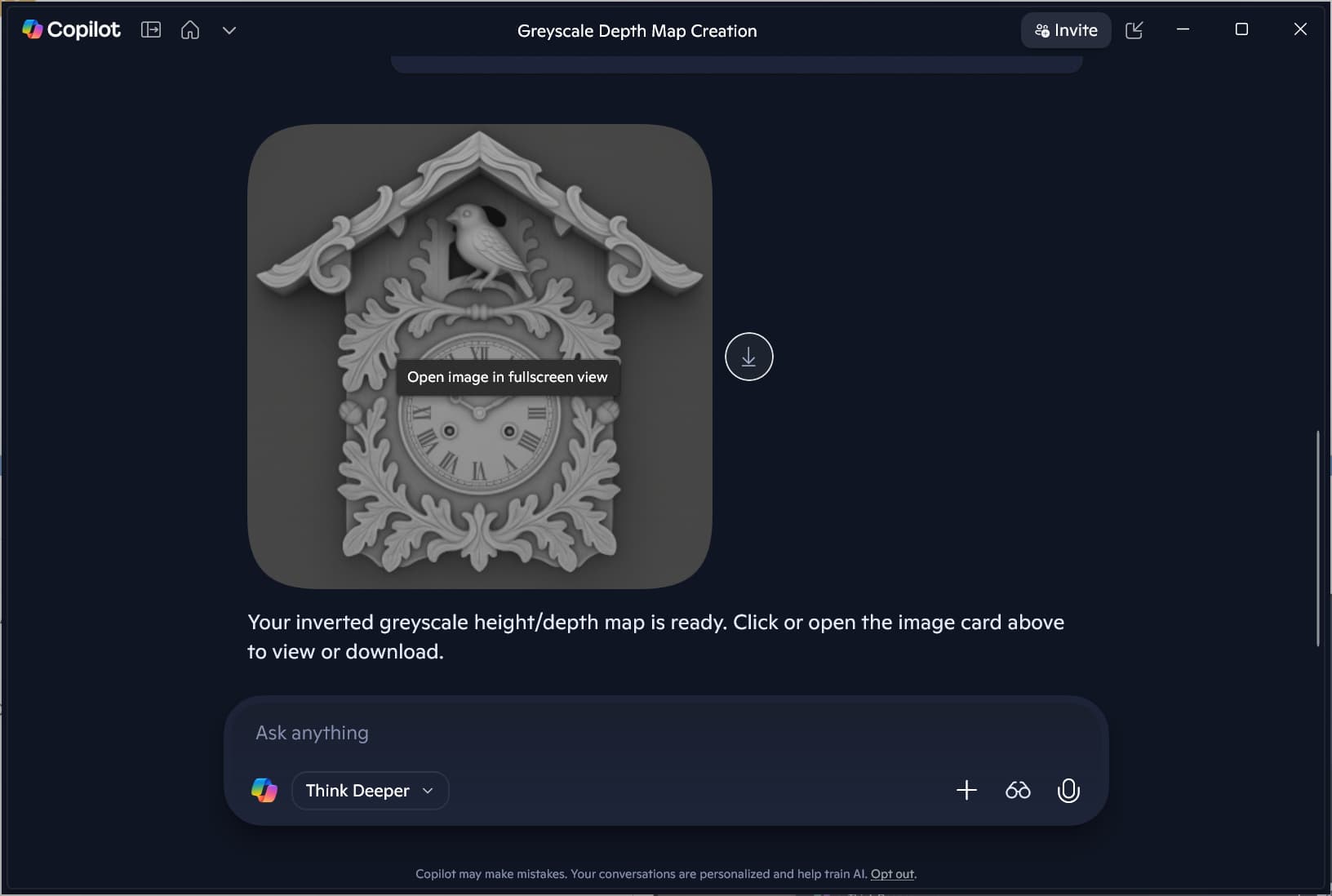

If you’re starting with an AI-generated image, why not have AI make a depth model of it?
Here is what Copilot arrived at:

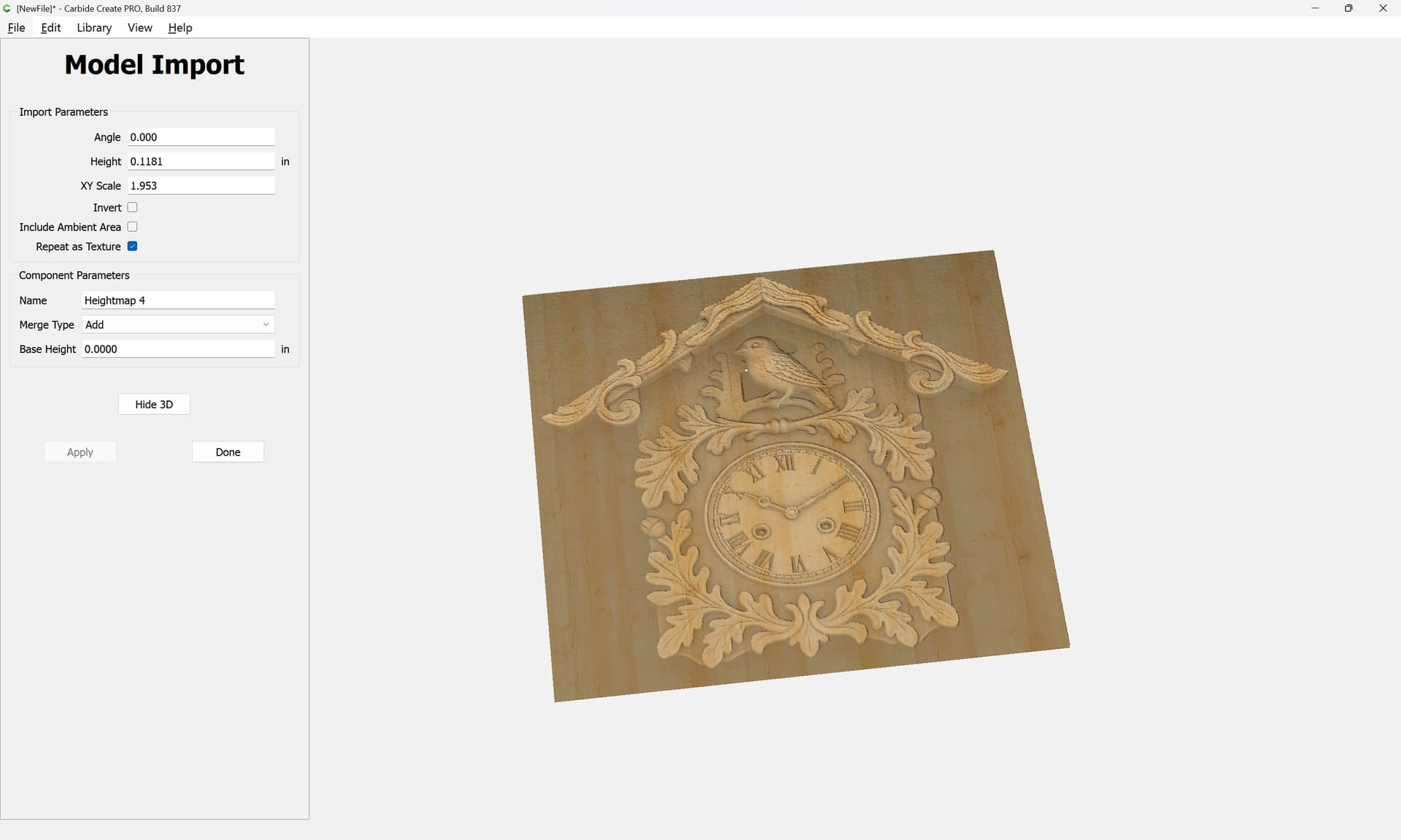

which imports as:
Looks great. Thank you William…

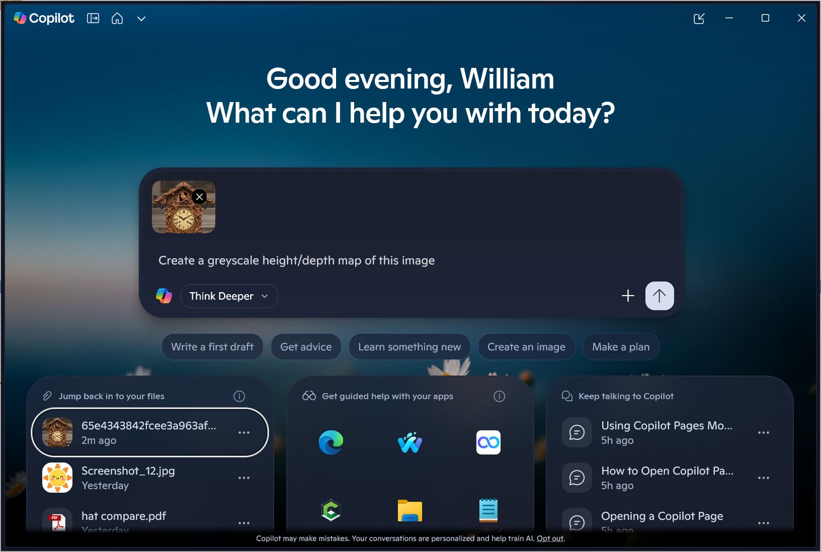

Note that there was a further prompt:
Make a greyscale height/depth map where dark corresponds to height and light corresponds to lower areas.
and an intermediate image:

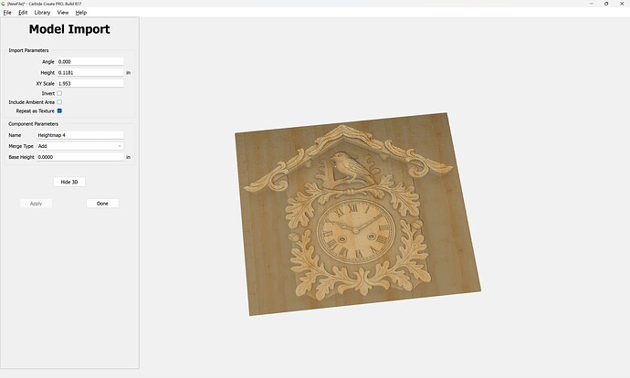

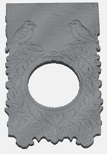

I am close to what I want to achieve. I have moved some things around and I have an STL… In carbide create I can see the 3D image but when I attempt to create the vectors; I see no layers.
Upload the .c2d file you are working on?
